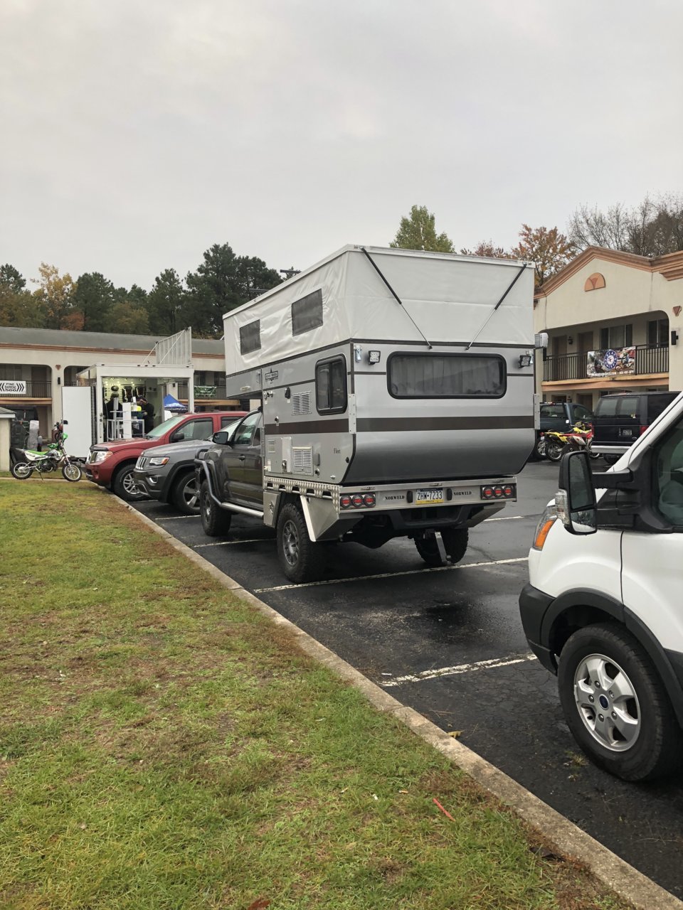

    Since you mentioned tray,
    From the pine barrens 500 this past weekend. That guy is from mainline overland. Pretty sure he didn’t sleep in the 4wc though.

    Nice, I've seen that one in person and it's slick. My buddy has a flatbed FWC on a Super Duty that is super comfy. I'd have probably slept in the FWC over that hotel haha.
    Did you go to this? I've wanted to go the last few years but I always forget when it is and the weather seems to end up being pretty lousy, at least it was this year and last IIRC.

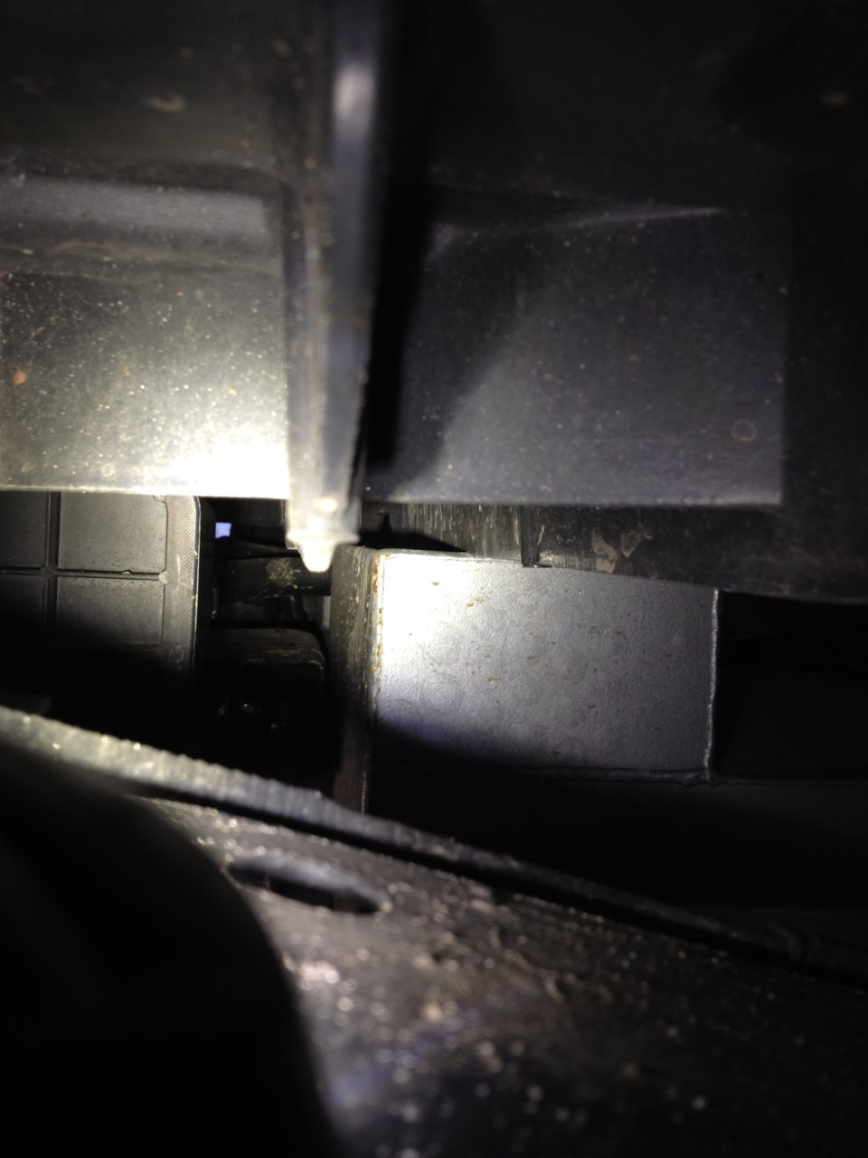

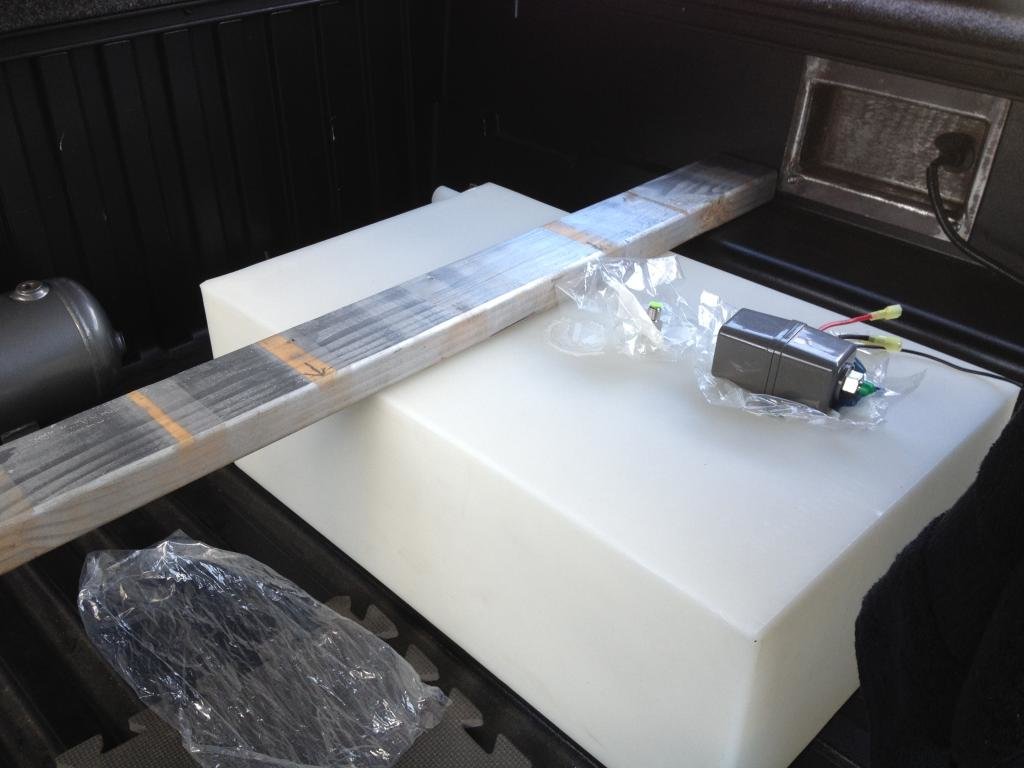

    You installed a LRA tank in a DCLB right?
    Did you have to cut the bed to fit over the tank?
    I just put my bed back on after finishing the tank install, and the bed was about an inch over where it should’ve been. The tallest part of the tank didn’t fit between the stiffeners correctly.

    Weird, I didn't notice any interference when I first put it in or last week when I had it back apart to put in the anti-overflow valve. It definitely doesn't fit between any of the ribs on mine either but I guess that high part of the tank falls in front of the ribs on the shortbed. That said, I just snapped a pic and it does look like the one rib is touching on the tall part of the tank. Never noticed before but the tanks been in for 6 months - oops. Looks like I'll have to get in there with a body saw or something to chop that down as I'm not gonna take that bed off again haha.
    I wonder what is so different though about your tank, bed or frame that mine just fits?

    Yep that’s the spot. Except my bed bolts closest to the cab, had about an inch between the bed and the mount.
    My truck is a 2010, so idk if anything about the bed is different, and idk if there have been any changes with the tank. I suppose if you didn’t look for it and just bolted the bed down, the bolts might be long enough. Might bow the bed, or maybe not touch the mounts completely? Or maybe yours really does just fit better than mine.

    Install was super easy other than I really didn't want to have to pull the cap, drawers and bed again but it only took a few nights after work to get it stripped down and put back together again. The hardest part was getting that little plastic anti-siphon thing out of the neck so I could pull in the metal overflow valve (whic mostly could be put in by hand).
    So far with one fillup the overflow issue seems gone which was super annoying. Only gripe now is the gauge hangs out at full for about 125 miles before it moves and the low fuel light comes on with around 8 gallons still in there. Seems like that's a function of the tank shape so oh well.

    Yea I cut about an inch off that rib and have plenty of clearance now. Luckily I was using a jib boom on a bucket truck so it was easy to pick the bed back up, cut the rib, and drop it back down. That bed would be tough to remove by hand.

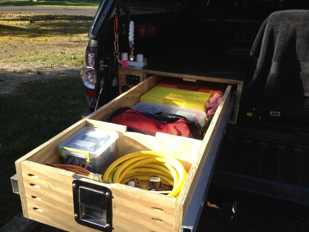

    What size bolts did you use for the bearings? Great build I’m doing my this sat

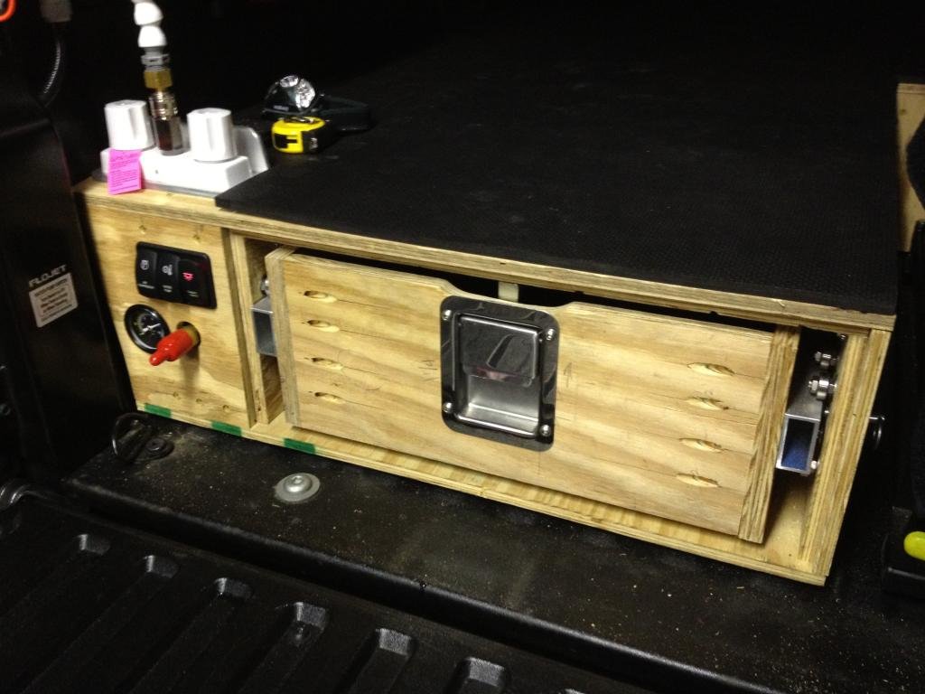

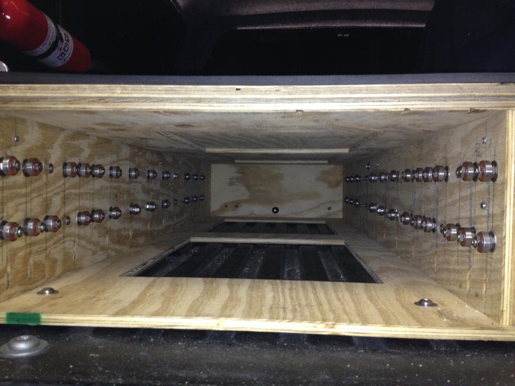

    5/16" worked perfectly for the bearings I had. I was going through 2 layers of plywood for the drawer box and used a thin nut on each side of the bearing, I think the overall length was ~1-3/4".
