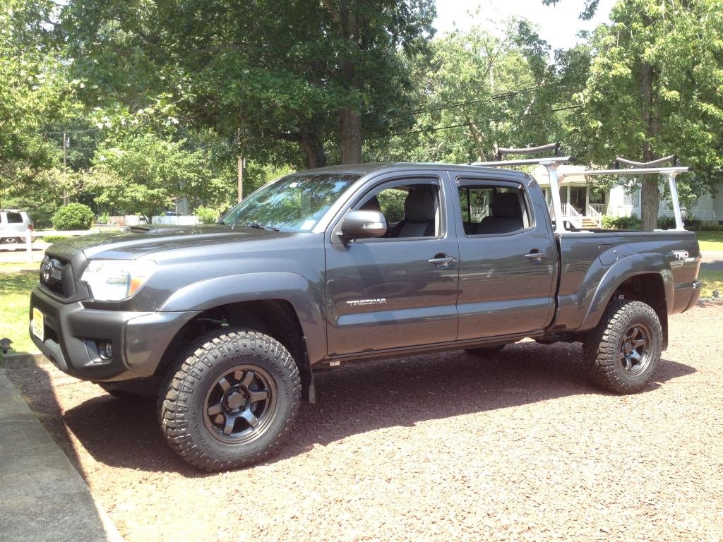

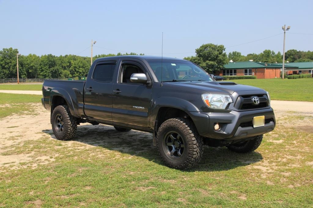

    Stu - the color match is really close. I can't remember what else Dustin (JdMeF9SiR2) offers in the graphite gunmetal but the quality is top notch and he offers great customer service. I was so pleased with the whole deal that I have a matches set of wheels on my teardrop camper build which gets lots of looks.
    I don't think I have any pictures of the wheels right next to the paint but they are easily assumed to have been color-matched. These wer taken right after I got them mounted up.

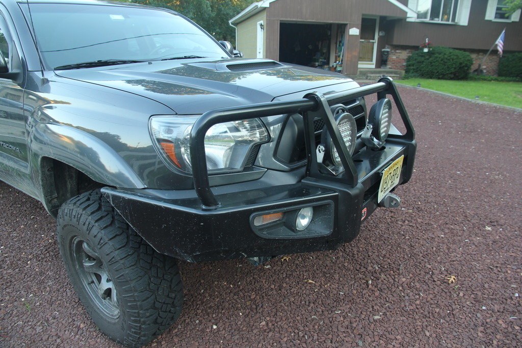

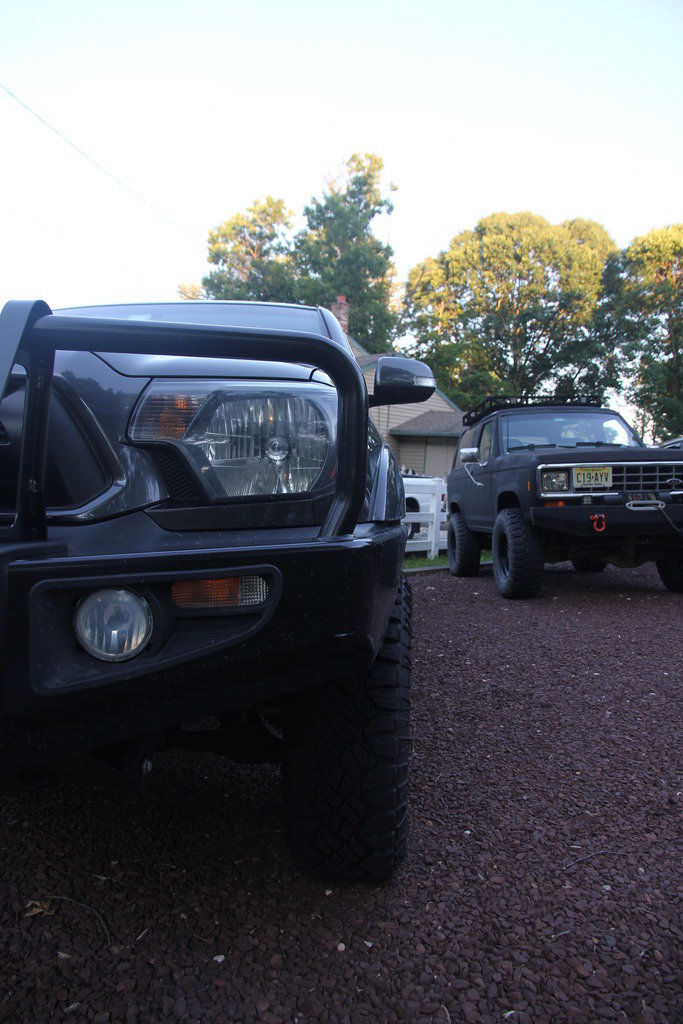

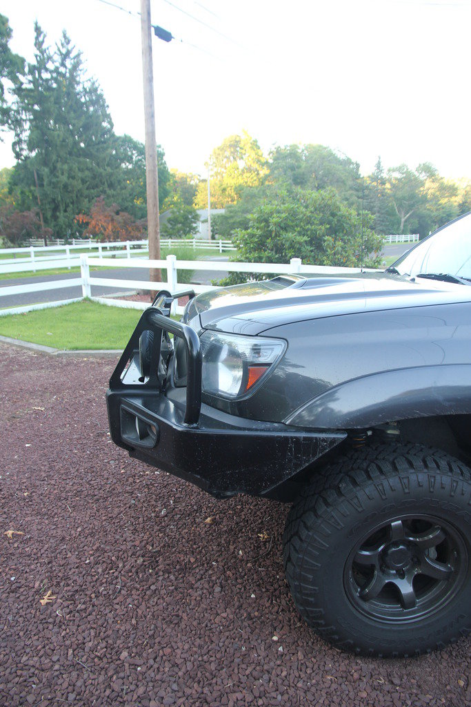

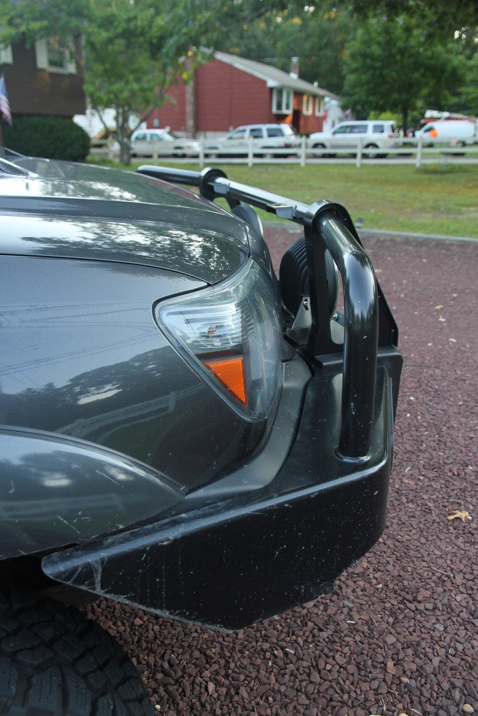

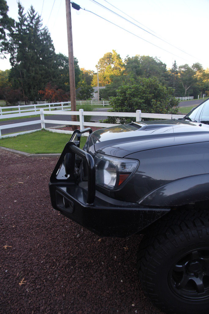

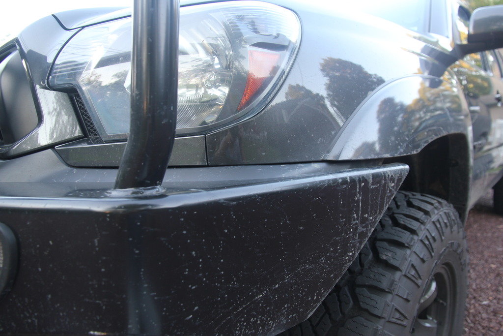

    Honestly I was hesitant to go with their design on the '12 at first as I saw some photos that seemed the show the headlight/grille bars as too high and too far from the body. I also thought I wanted front shackle mounts which the ARB design doesn't provide.
    That said, I'm very impressed with the quality and fitment now that it's on. My initial concerns about the hoop height I think was because most folks tuck the bar in very tight to the body which obviously shifts the whole bumper up relative to the grill, headlights and hood. I can only imagine that those folks are beating the crap out of their front fenders when flexing offroad because there is a lot of movement between the chassis and body. I also picked up an eBay replacement bumper cover for a base model w/out flares to hack up for the install. It your cover has the flare extensions you will have holes that are visible after the install as the flare extensions on the bumper have to be removed to run the ARB. The holes would he most visible in the first photo below.
    Hopefully these shots will give you some more to go on:
    I'll warn you that I'm not impressed with the quality of the turn signals/markers and the ARB/IPF foglights. Both have known water issues and I've experienced both. I've cleaned and sealed the turn signals/markers (see post 44) and it's been holding up great now. I did have only of the glass foglight lenses nearly fall off after about a month of use because the glue failed. I caught it in time and disassembled and cleaned both units and sealed them back up with the same flowable silicone. So far so good but I do have a bit of clouding on the inside of the lenses again which is disappointing. Live and learn.

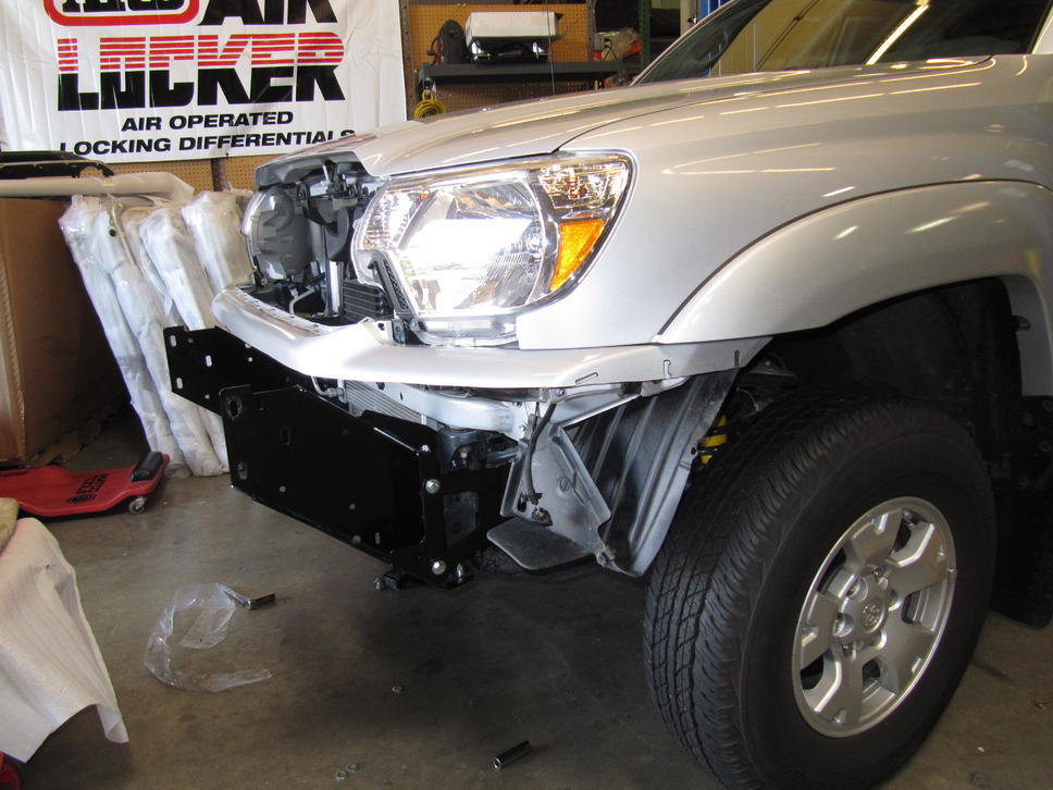

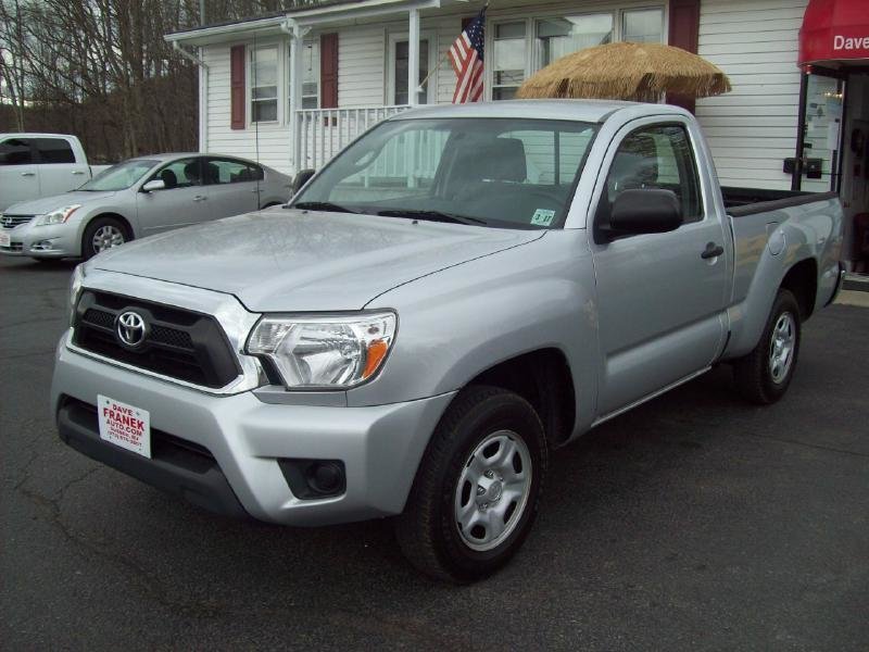

    The 4x4's and Pre-Runners have the fender flare extensions on the front bumper that are secured by clips from behind. These flare extensions have to come off to cut the bumper cover and install the ARB bar. I'm sure that makes very little sense by the explanation so I tried to find you a picture - This first silver Tacoma has had the flare extensions removed and the stock bumper cover cut.
    This is a 2wd base model that doesn't have fender flares so no fender flare extension holes are in the cover.
    04173699-8739-4BD0-A8B0-E584CF6FDB05_1_z_cad3e2fb97efb63764836ec4d40dc460a5014688.jpg
    Going this route let me save stock bumper if I ever need to go back to stock and I have no unsightly holes!
