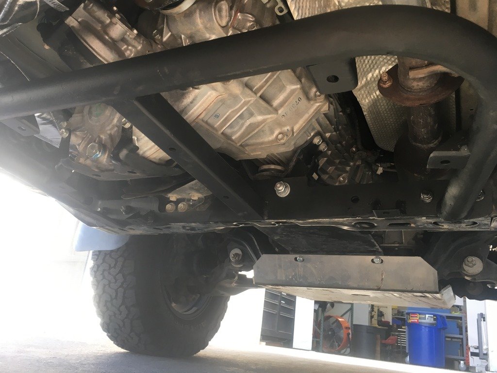

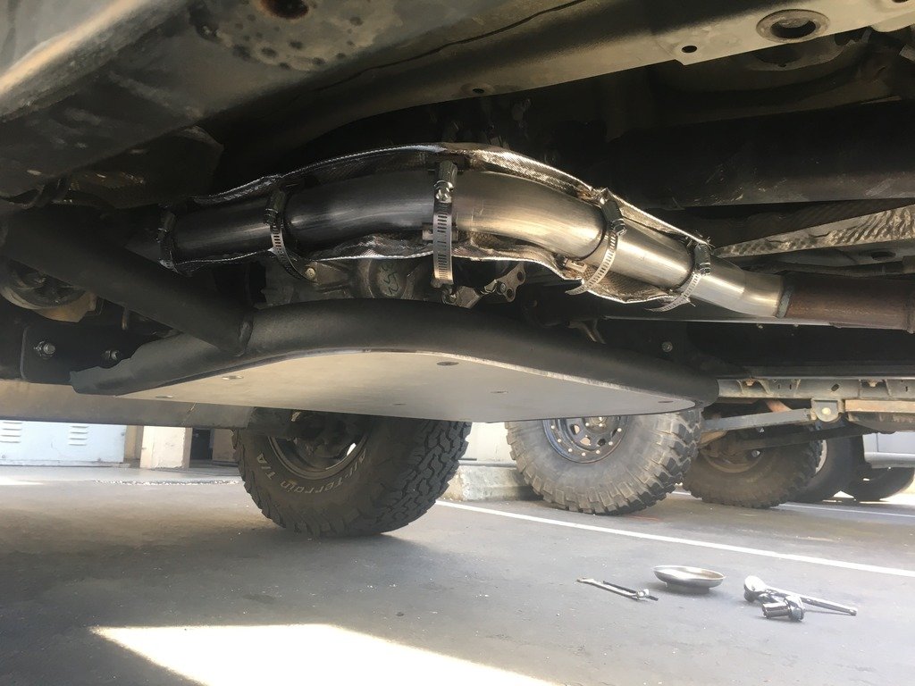

    I just dropped off my front and mid skids at a fabricator to duplicate in 3/16" steel. Then to get the powdercoated...
