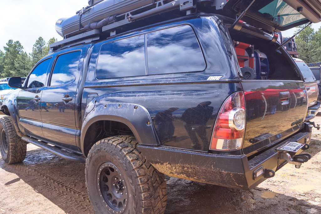

    @brucehutchinson Here is a pic of @DefconBrix's overland build with a Pelfreybilt bumper and a tow hitch with chain mounts built in:
    brucehutchinson and Longshoreman like this.

    awesome @DefconBrix where did you get that hitch?

    Is offroad trailer hitch specifically for use with rotating poly bushing connex, called max coupler
