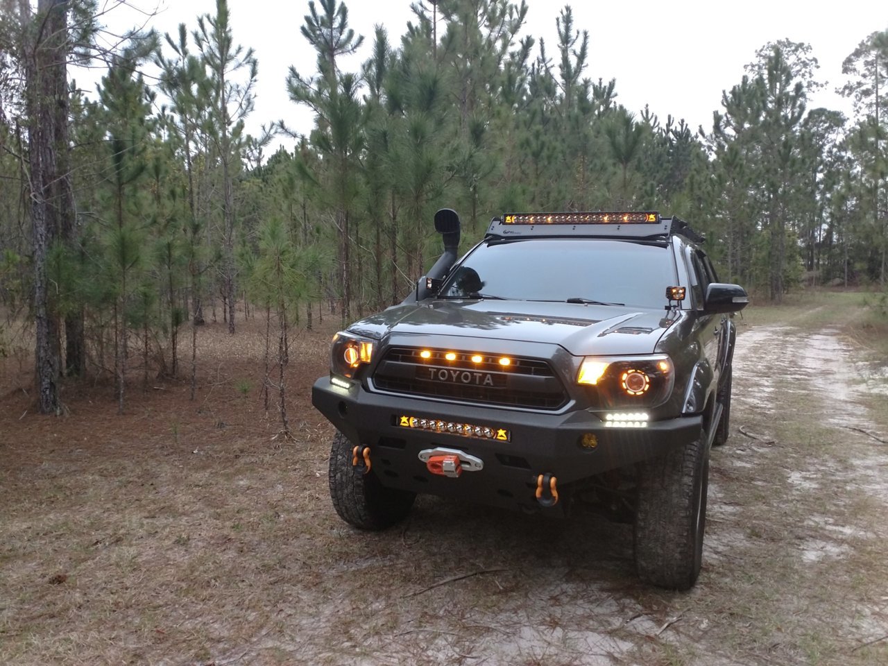

    I have a Pelfreybilt aluminum bumper. The box for the winch is steel, everything else is thick aluminum. That seems to be the standard. FEF_Mar2021.jpg
