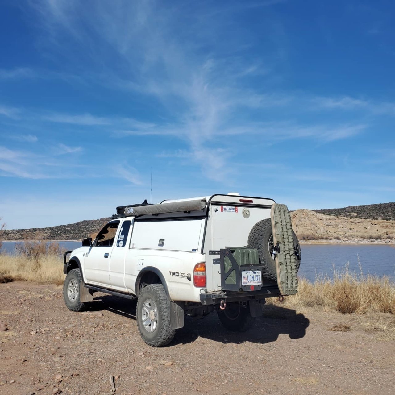

    I have the 23"-29" wedge and I like it a lot.

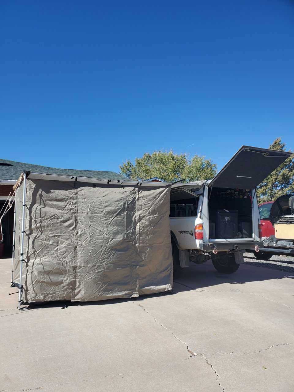

    I thought I would miss my tailgate, but I haven't. Having the full door acts as a mini awning as well.

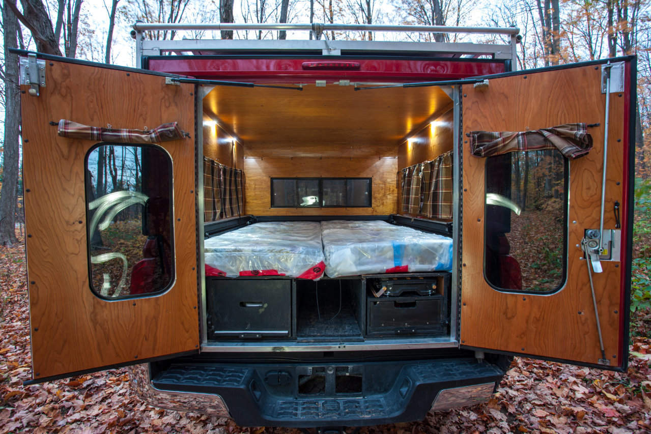

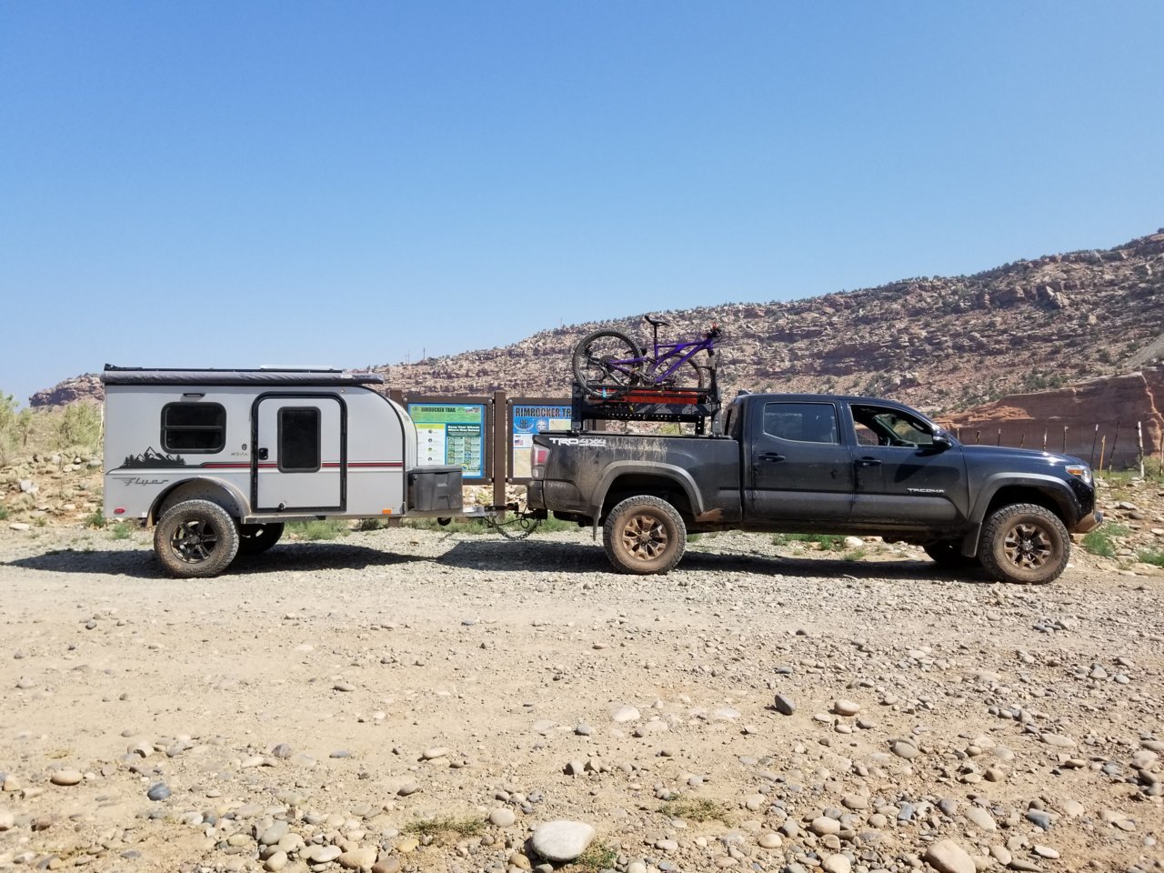

    Love this set up, I have a tiny square drop trailer, this would make a great living room, bike hauler!! Nice job putting it together. Is that a ARE rack or custom?

    Thanks,
    the rack is ARE ,

    Did you paint it, or did they?
    How tall is it? The shape will match my trailer very well. It would make a nice addition.

    It’s custom order with sliding windows in the front and sides,it’s 29 inches high from the top of the bed on the outside .Painted by ARE .

    Loos great, thanks for the info! I am selling my rack and will try and put in order in for one, unless a cap with some height comes up local on CL. I really like the barn doors, I have some lower back issues and reaching in for the bikes can ruin my day.

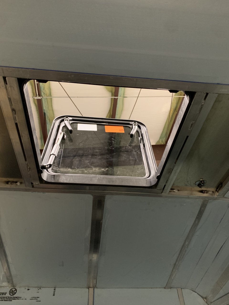

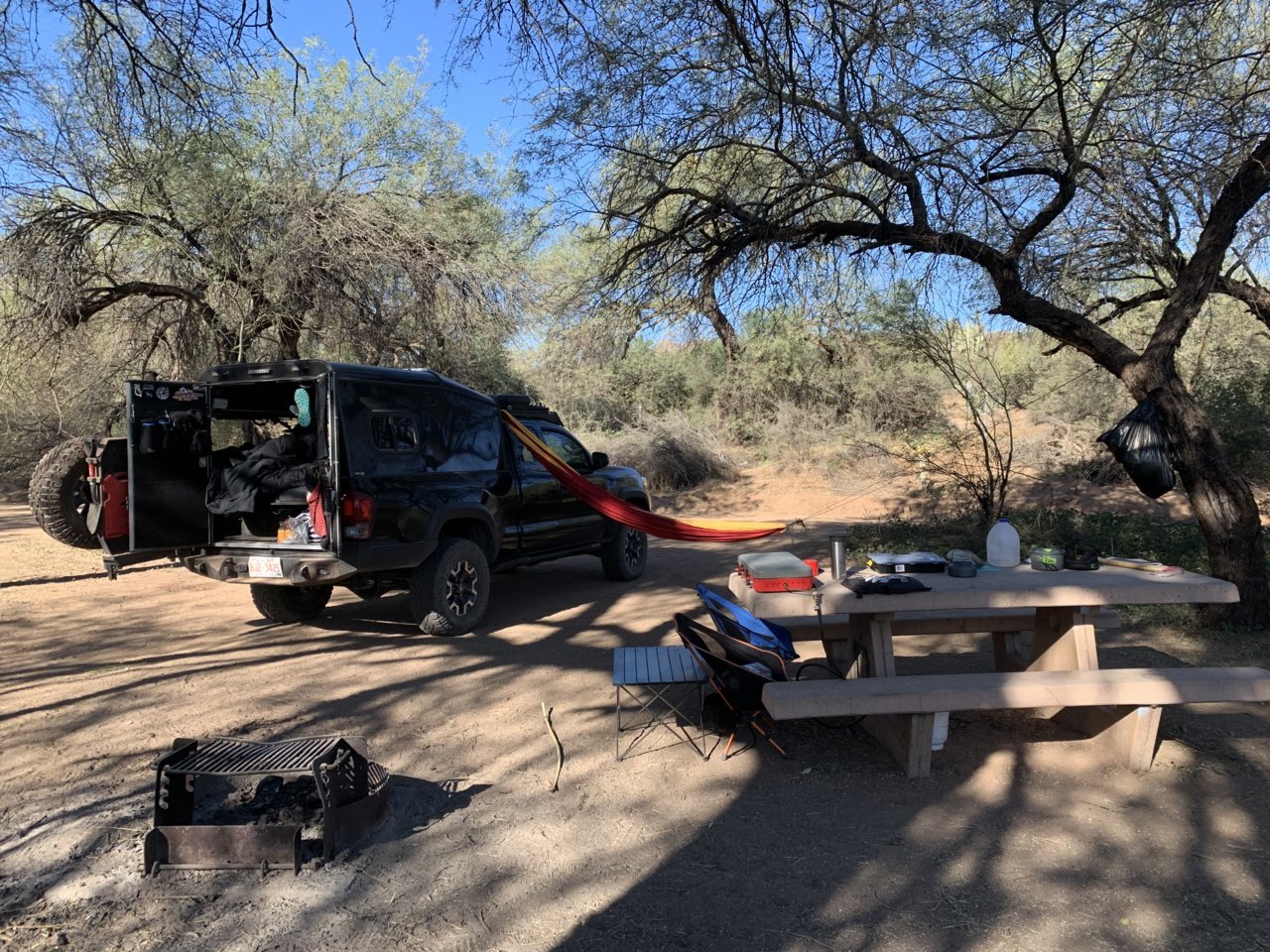

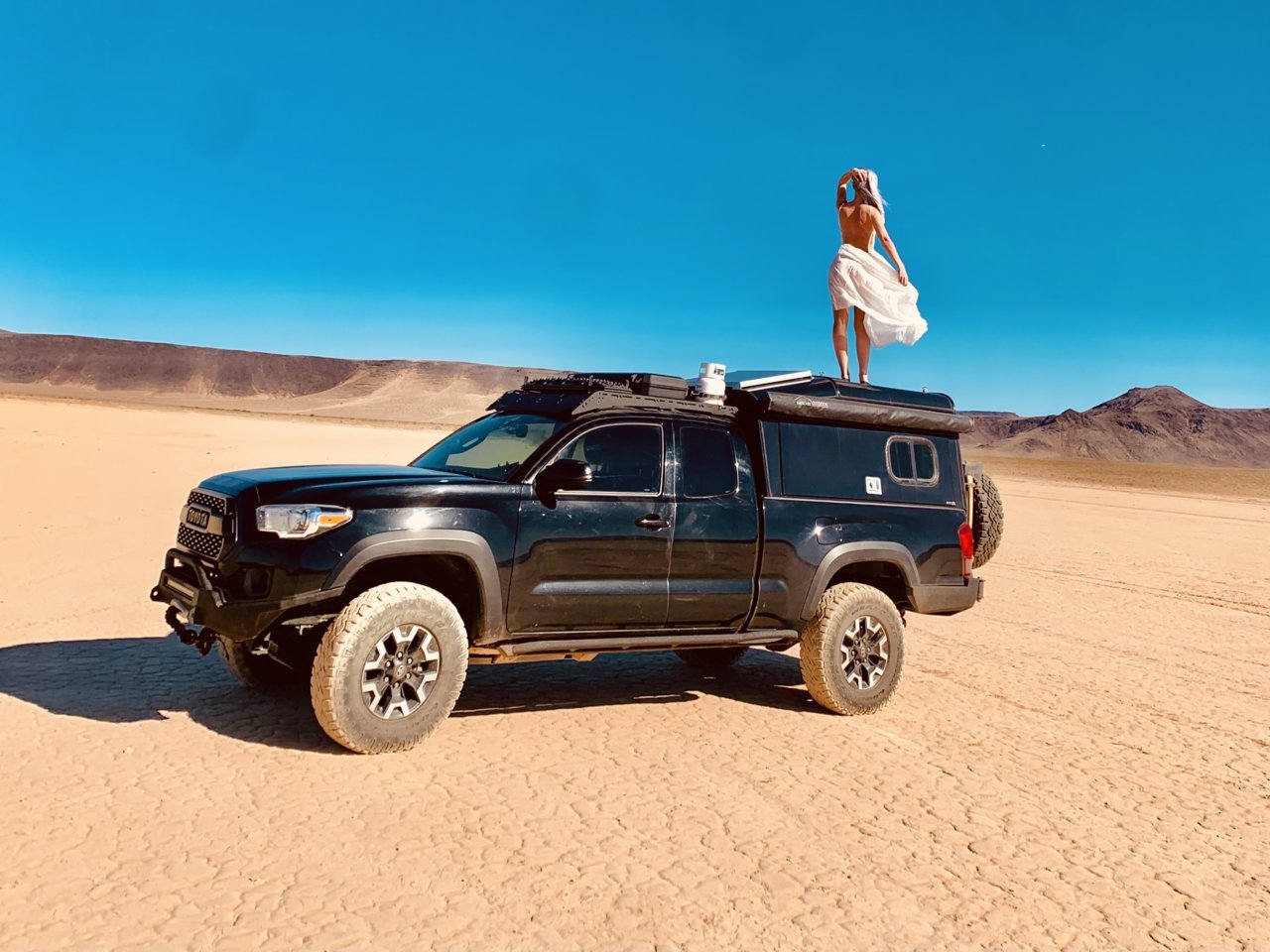

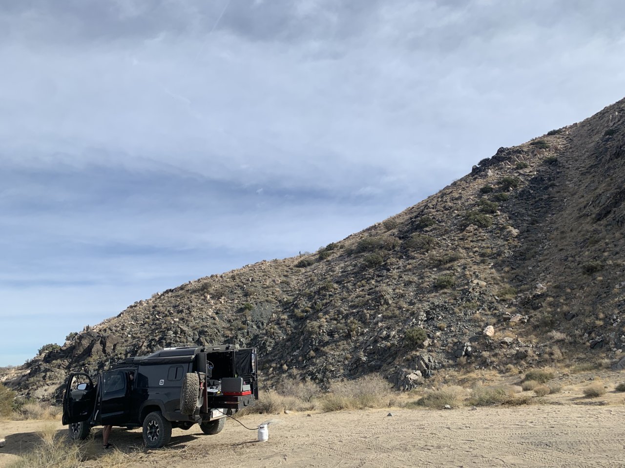

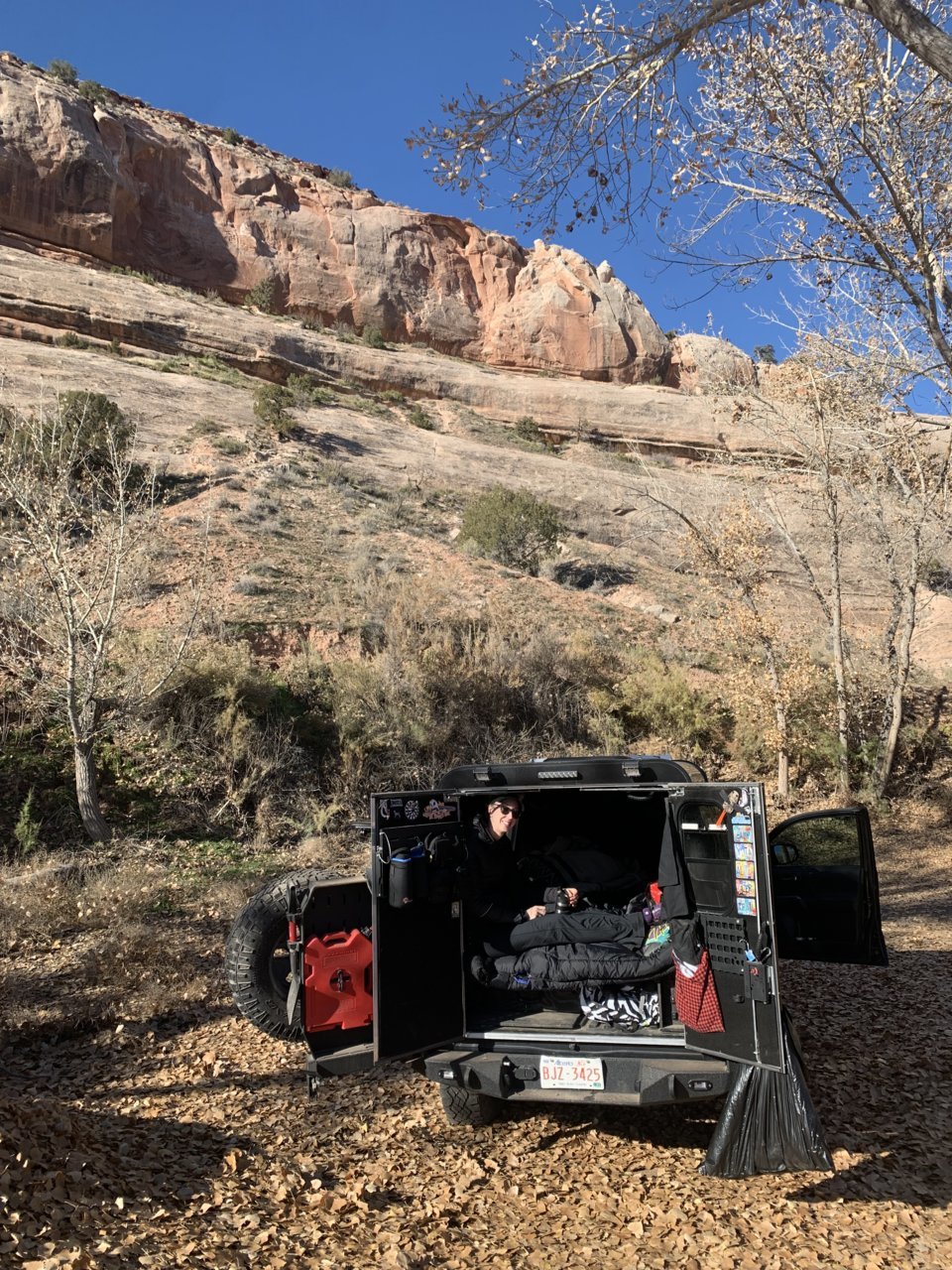

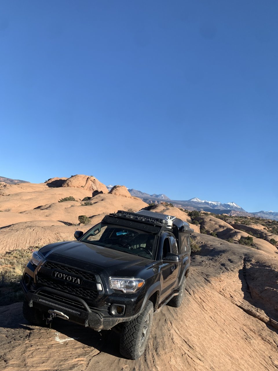

    @Ayoung208 and @Josh41
    I can probably add a little insight as well. @Canadian Joe was a huge resource when I ordered mine.
    I went with the 26-32 wedge. It does sit above the cab, but it works perfectly with the Prinsu rack. The wedge is also the perfect size to add a solar panel.
    My wife and I are both 5’10” and with a 4” mattress there is just enough headroom at the 32” section.
    I added my own windows and my own marine hatch in the roof. Did my own insulation and carpet as well.
    Big advantage to the full doors is they are much easier to close, and I had a custom rear bumper built that allows us to still open one side without swinging the spare tire open.
    We just returned from a 24 day, 5000mile road trip and spent 21 days sleeping in the back with zero issues.

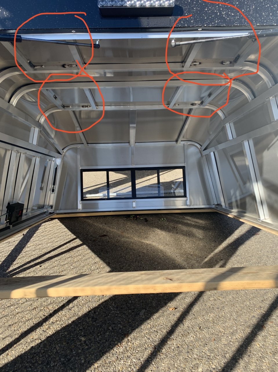

    This looks great, did you do anything to strengthen the roof to have someone walking on it. I am hoping to avoid the stock rack that they offer and put a Yakima up there for a canoe.

    I ordered mine with added plates in the roof for mounting a rack. The footprint of the roof isn’t huge and it’s quite solid from the factory.
    You can see the plates circled in red.
    I did add a couple braces for mounting the hatch, but I was walking on the roof before that with no issue.
