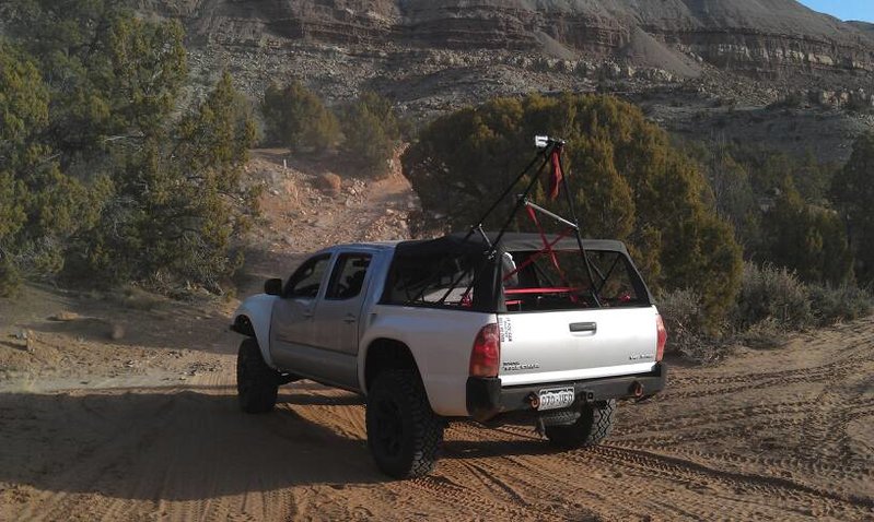

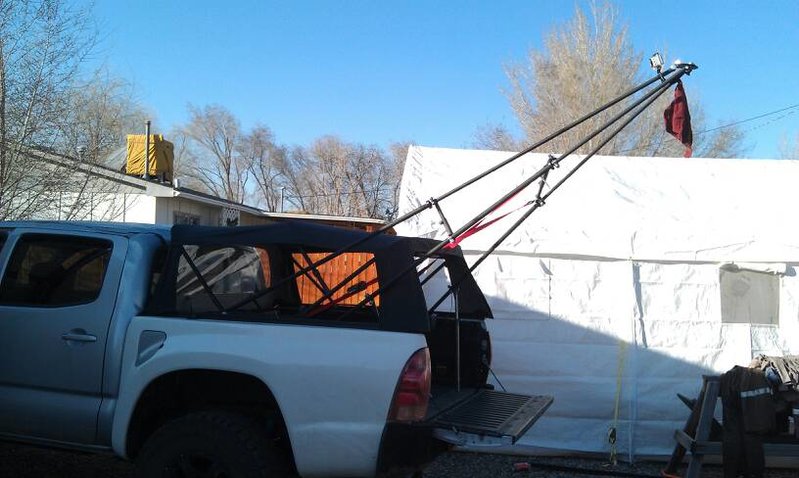

    Have you got any more details/pictures on your GoPro mount? I've been thinking about doing something similar.

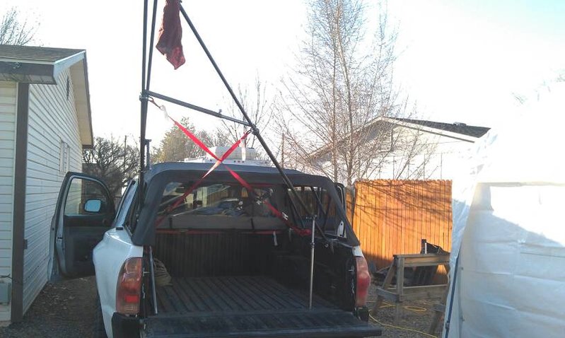

    It is built using 1" .120 wall dom for the lower sections, and 3/4" tubing for the upper sections. The 3/4 slides into the 1" and allows it to telescope. I used cheap ball joints to secure it to the bed rails and just use straps to tighten everything down.
    If I were to build another one, my main focus would be to lighten it up by quite a ways. Possibly use aluminum.

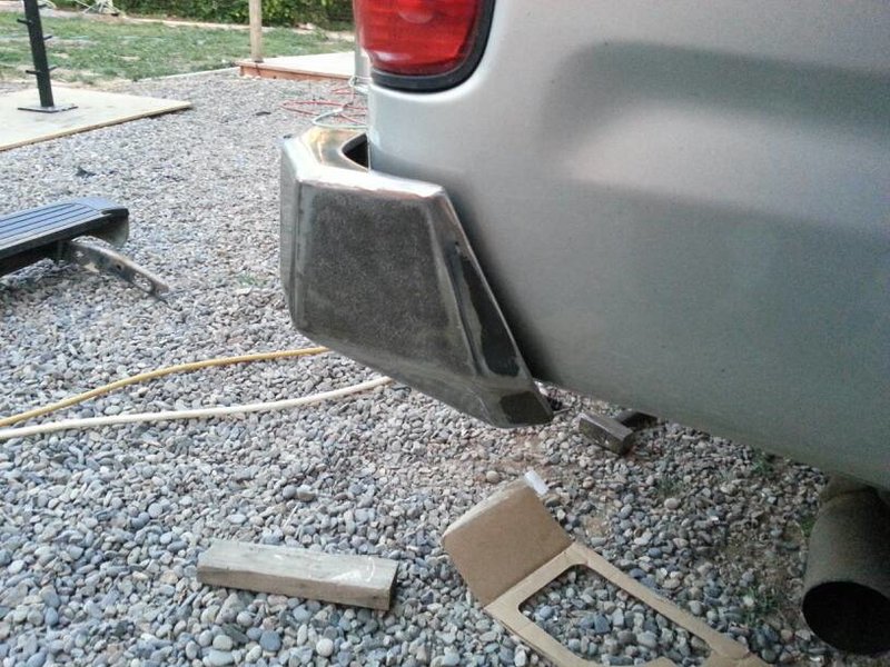

    I guess I should post a little pricing intro for the sliders and random other hardware I have been building, mainly the reason I haven't been doing much to the Aluminum Falcon.
    "SkinkWerks slider pricing:
    So far, I have only built them for second gens, working on first gen sliders.
    Base model $500,
    Dcsb/Ac $550,
    Dclb $600,
    Powder coating for base and Dc +$50
    Dclb +$75
    I am still working on bolt on options, and hope to make all sliders a bolt on option.
    These are made in my spare time and I am slowly expanding what I can offer.
    If you have questions please feel free to send me a pm, I have also been doing a few bumpers here and there as well as other custom work. Examples are BradyT88's bumpers and Bulhas's bed rack.

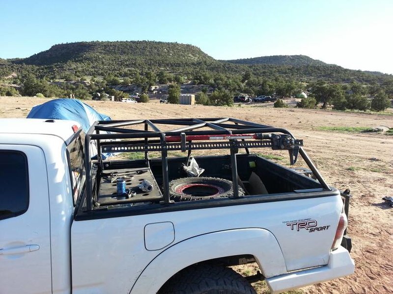

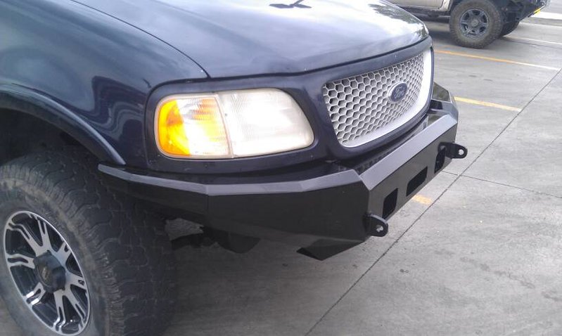

    Just a few other projects that have come out of my back yard...

    dayyuuuummmmm dat bedrack
