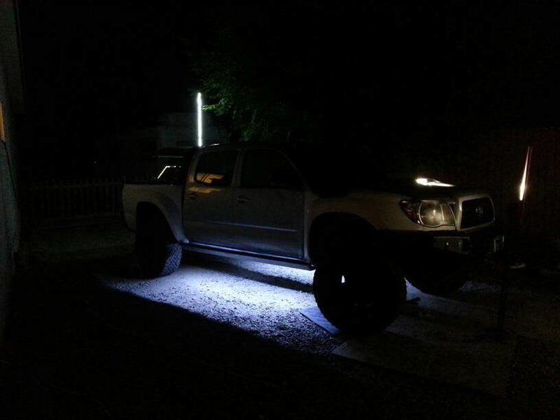

    Changed up the rock lights.

    hmmm... I might no my next purchase from you haha! Those look good. How is the light output on the ground?

    god damn dude!!!! where do you get those leds, thats pretty crazy bright

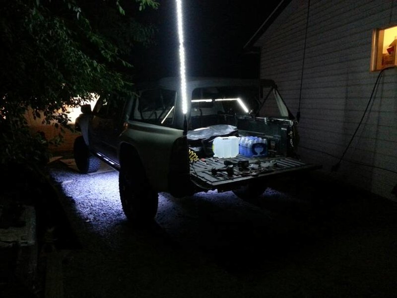

    The rock lights are just ebay 5050 strip leds, I think they were $15 for 5 meters.
    I think having the angled out like they ate makes a huge difference in their spread and really lets their light shine!
    And the rest are the absolute cheapest leds I could find. I think I got 10m for $17.
    God bless fleabay...

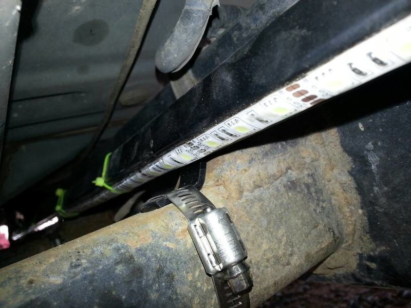

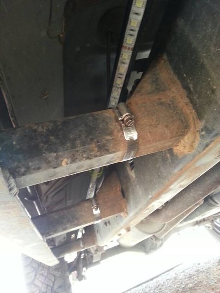

    Its all about the angle of the dangle!
    The square tube us just 3/4" x .063 wall. With some random little tabs holding the square at about a 30* angle outwards. Then I ran zip ties around the strip to make sure it stays put. The whole assembly then is held to the legs of the sliders using good ol classic hose clamps.
