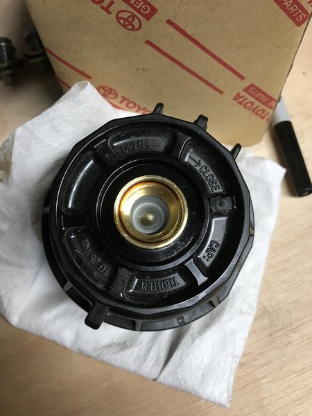

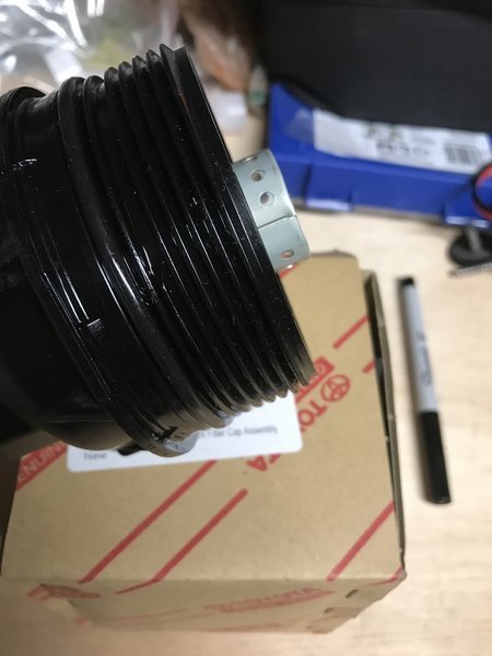

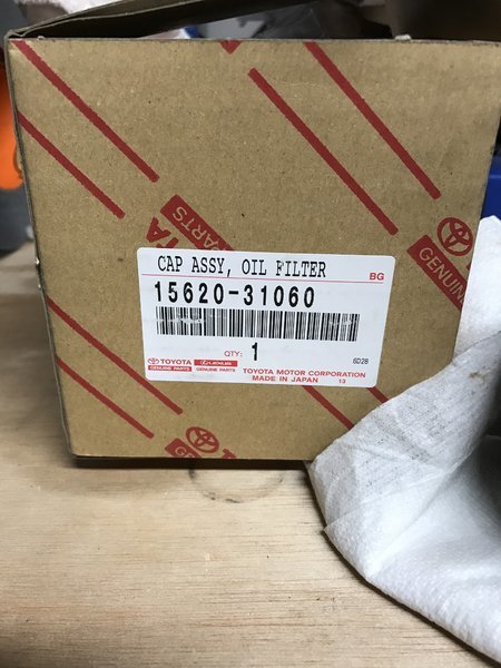

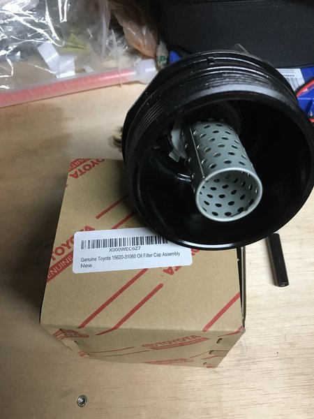

    IMG_0245.jpg Ok @Z50king and the rest who are confused.
    My exact part number on the box of the aluminum housing with my used plastic one.
    You have to reuse the drain plug and replace all the O-rings as the oil filter kit includes these.
    The perforation protrudes 8mm from the body when viewed from orthographic side view. For those that don't have metric scales, it's about 5/16" protrusion. This is the correct one, not sure how much longer the "wrong" tube is, since I didnt get that particular housing.
    Proof in the PICS:
    drizzoh, SilverII and shakerhood like this.
