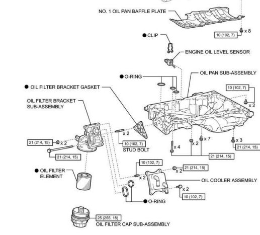

    I'm not exactly sure the purpose of the clip.
    All I know is...when I did my recent oil change in April, the housing did not vibrate off the base straight section of the rim where the clip is located.
    EDIT: That area you have circled looks like a "winglet" to help with un-torqueing.

    Filter housing is attached to the block. You can replace it if manage to damage threads
    BillF1564 likes this.

    yes, there is a “block adapter” for the housing if that’s what your saying.

    No. Its not. As Vlady stated above, the filter housing is separate from the block and can be replaced.

    Not sure what you mean. I commented on his post. There’s an adapter that goes on the block.

    Toyota calls it oil-filter bracket sub-assembly where you screw the cap. Technically, it attaches to the upper oil pan. ~$100
