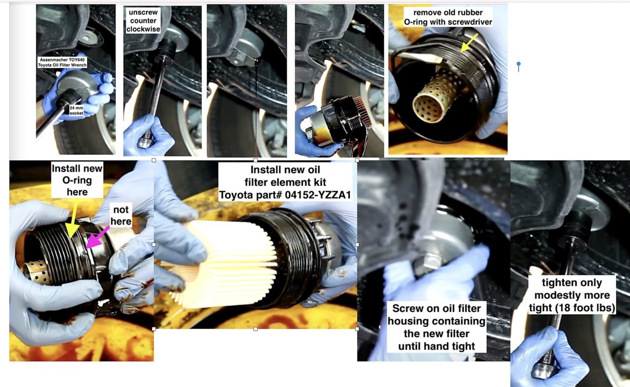

    One of the great mysteries of life……

    Just changed the wife's 4 runner's oil today.
    There is a definite and easy to notice point to stop.
    Pretty simple, but i still hate the whole cartridge thing.
