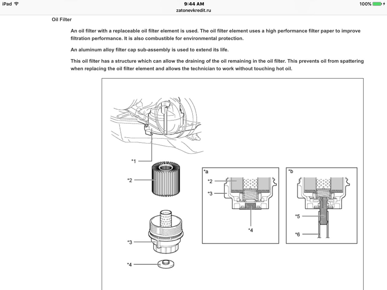

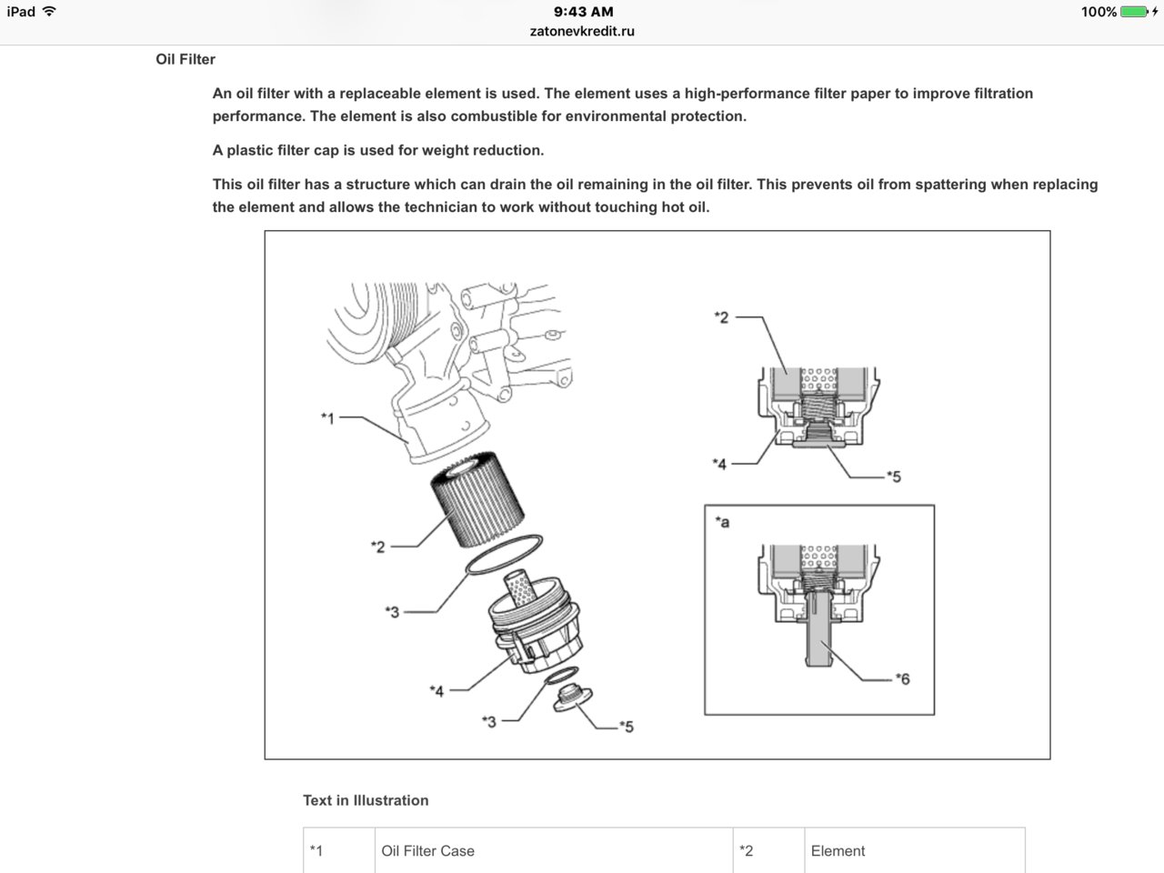

    You should not trust anything from .ru

    Thank you, Id love for all the composite lovers to see this.

    Perhaps post a relevant information...?
    which engine is that and what year?

    I'll take my composite bed over aluminum any day. :cookiemonster:
    But back to the filter housing, I'll look at the opposite statement. The weight savings between aluminum and composite is 14 grams. 0.5 ounces. I can shave the same amount of weight by removing 75 cents from my coin holder.
    So was that line written by an engineer or a marketer? I'm guessing the latter. Because honestly who gives a shit what it weighs OR whether it can withstand Mongo and his channel-lock pliers, its a cheap 30 dollar part that does the job either way.

    That is exactly how I read it. Instead of saying "cost cutting", they said "weight savings".
    Now in reality, they are always looking for weight savings for cheaper production, shipping, etc. costs. So its not entirely a lie.... Still, I love the fact that the factory manual says the aluminum one is more durable :amen:

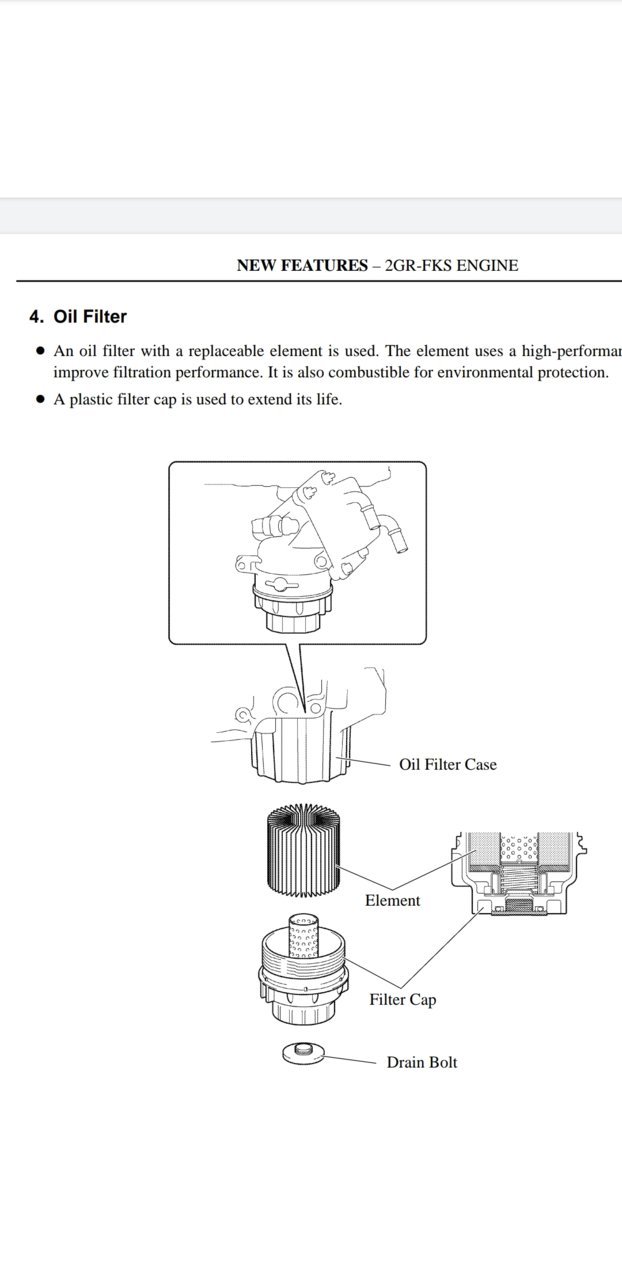

    Factory manual for 2016 and up tacoma 6 banger states quite opposite.
    Line 2

    I think what they are implying is the plastic cap is not a throw-away item. It’s for extended use, not disposable, thus extending the life of the filter cap, for the environment. That’s honestly what I think the translators were trying to communicate.

    Dozens of Toyota and Lexus models that have the cartridge oil filter have the same info, and have for years.. all from Toyota TIS. They all state the aluminum is for longevity, plastic is for weight (cost in reality). The 2016 Tacoma is the first that I have seen to state the plastic is for longevity.
