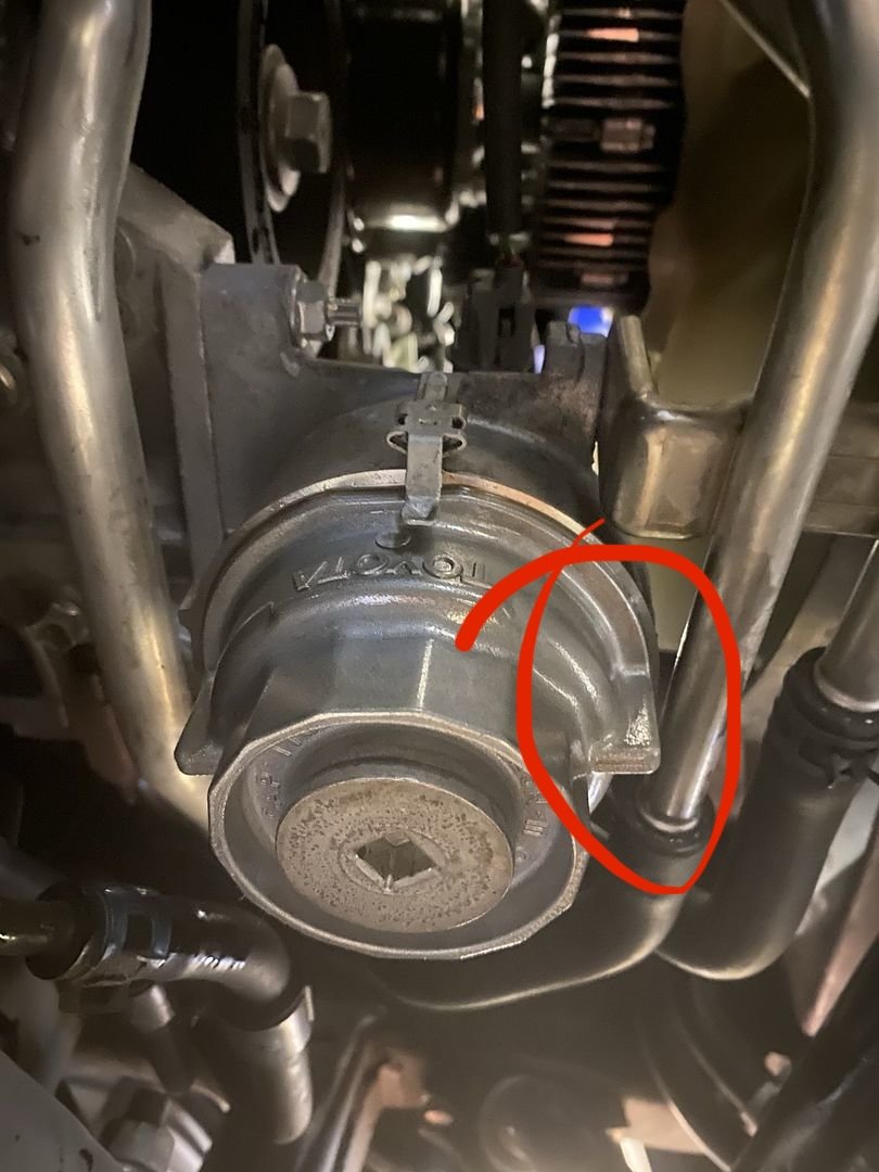

    That's more of a textbook answer with oil filters that have a rubber seal around the outer edge...as opposed to o-ring near contact point.
    This aluminum housing assembly has a clip that engages upon contact. I also check for leaks after replacing the paper filter.

    @TacoTime55
    TBH, I don't even use that tab. When the shoulder of the filter hits the shoulder of the block adapter, and there is no gap between the two, the housing stops. There's no moving even one degree let alone ninety

    Bring your truck over to my shop. I’ll show you 1st hand how you can get an extra quarter turn after the lip contacts the housing.
    We can discuss torque, leverage and clamping force.

    So the intent of that clip is to retain the cap, should it be loose. It isn’t supposed to be able to vibrate past this circled area. The poly filter cap has it as well.

    And also discuss the physics of how the internal Oring does all the sealing, so therefore there's absolutely no reason to ridiculously tighten the housing.
