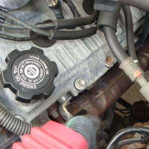

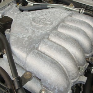

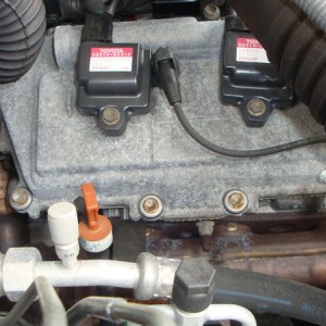

    Can anyome tell me if the silver parts under the hood (Intake manifold, Valve head covers, ect.) on my 2003 5VZ-FE are Aluminum or Magnesium? They have developed a whitish powdery oxide to them that seems to come off with slight rubbing from my finger. I have seen that Diluted Vinegar can be used on aluminum parts but not magnesium. Does anyone know for sure. All parts are Aluminum? no Magnesium parts?

    It's aluminum oxide. Aluminum when exposed to the air corrodes and protects itself with a whitish layer of oxides which stops further corrosion. Road salt will continue the process of corrosion. Look at aluminum skinned enclosed trailers that have been used in winter and exposed to road salt.

    Thanks for the replies. And the correction about hydrogen. The engine runs fine, 105K miles. but all the aluminum parts look a little crusty. I think I will try cleaning with diluted vinegar, let dry then some Water Displacement Formula 40. Thats WD40 in case you didnt know. HaHa! This is what they look like prior to cleaning.

    That is completely normal over time. The only way to avoid it is if the parts are clear coated after manufacturing. You see this sometimes on motorcycles and works well until the coating gets scratched.
