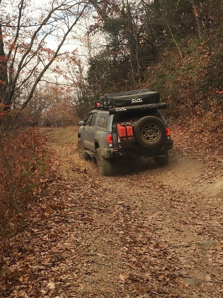

    I have a full aluminum swing out bumper made by CBI.
    Zac of all trades likes this.

    CBI was the one that told me it wasn't possible.. WTH?
    Zac of all trades and SixthSnail like this.

    that rear bumper looks too boxy..

    Call and ask for Nathan. He's who I ordered mine through and he's super helpful. I went with aluminum hidden winch mount, sliders, and bumper. Plan to order aluminum skids next. Don't know who or why the would sell that, I know it's on their website.
