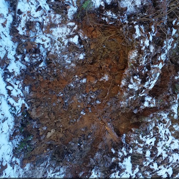

    I know my steel bumper will hold up pretty good, it saved the truck when my dad hit a dirt bank going probably 30mph. Only pushed the bumper up into the grill and turned my lights inward. Easy fix by loosening bolts and pulling it downIMG_20160401_202931.jpg
    The hole is around 6" deep
