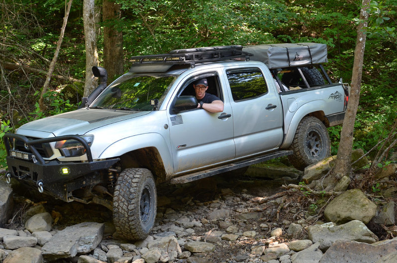

    This "police grappler" bumper is pretty cool: [​IMG]

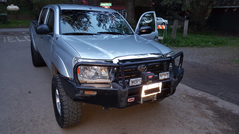

    ARB bumpers have replaceable crumple zones built in to absorb energy during a collision.

    Sound like a good design to me.
