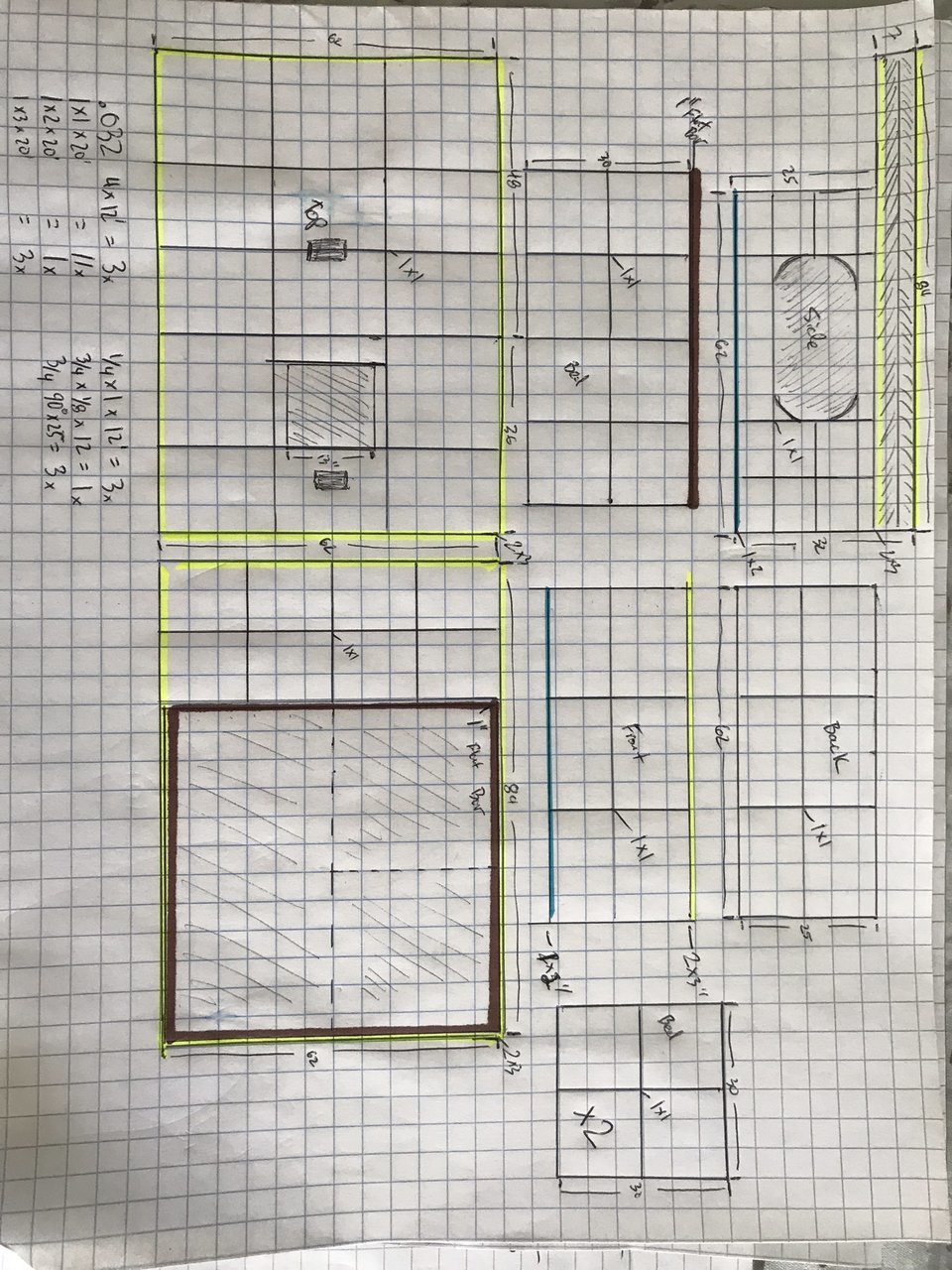

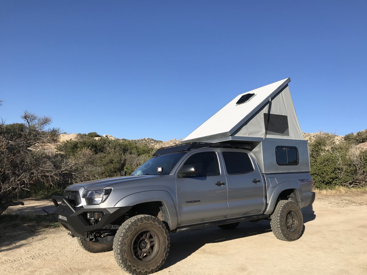

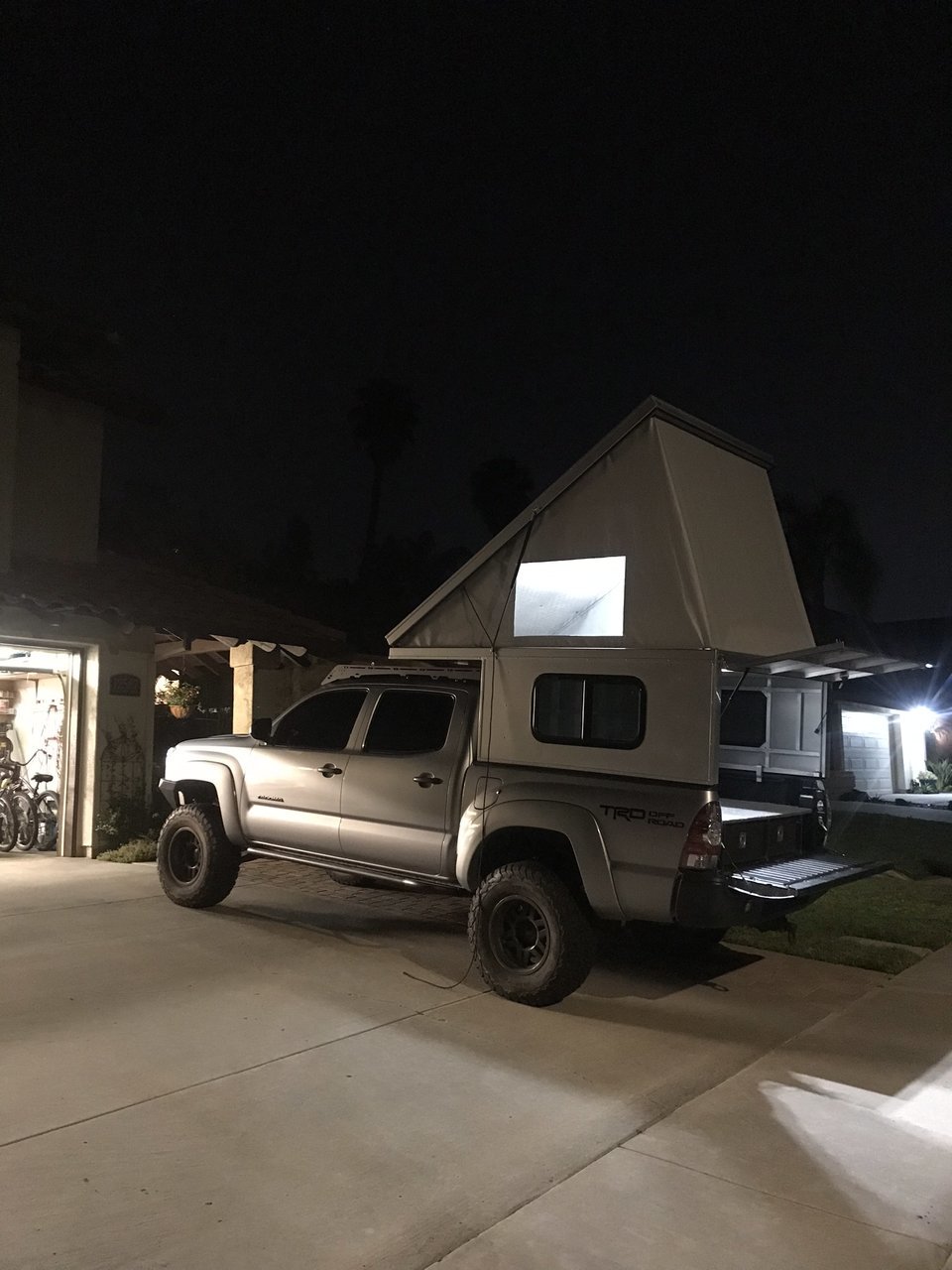

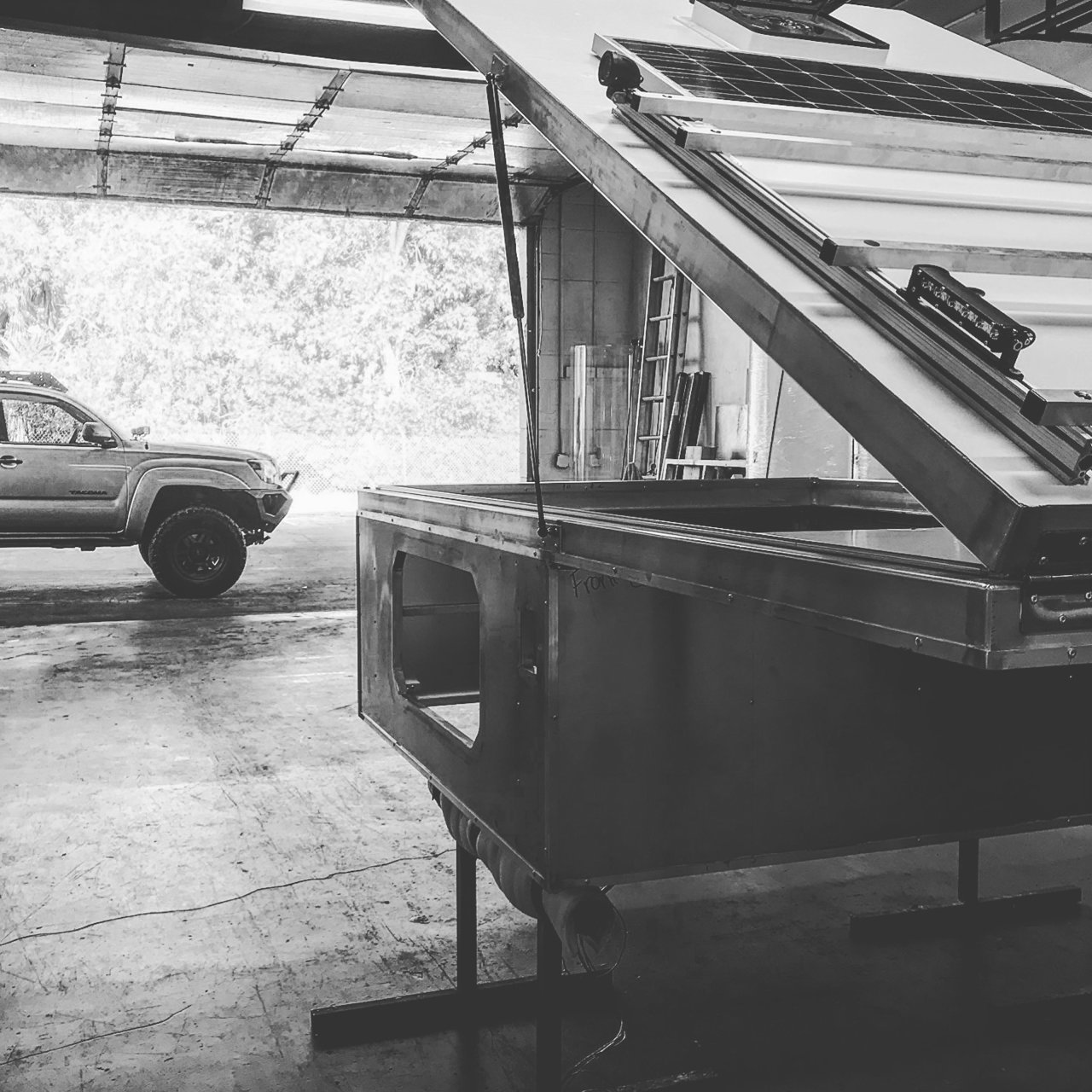

    Well I've have been inspired by a few people here on TW and can't take the wait or the price tag so I pulled the trigger and going to build an aluminum popupcamper. I will be posting updates and pictures throughout the process.
    Current status 6/28
    Camper #2 5/1/18
    -Roughly 400lbs
    -Outside dimension 108"x63"
    -100w Renogy Solar w/ 100AH NorthStar
    -Camco Olympian Wave 3 Heater
    -Fan-Tastic 3 speed with Thermostat
    -Modular roof rack 80/20
    -Roof will support 100lbs +
    -10 gallon fresh water tank with outside locking dish
    -Shurflo 45psi water pump
    -Dual sliding locking windows with screens
    -Closed height 82" Open height 139" (will vary depending on suspension)
    -Dual locking rear latch T handle keyed alike
    -Exterior ladders on passenger and driver side
    -2x Dual Led interior lights with high/low on/off
    -Roof is insulated with 1" thick Rmax and removable headliner. Aluminum sheeting with EPDM free Superflex membrane fully sealed on top.
    -58x104" 2 Panel moveable sleeping platform. High pressure plywood with rivet and glued aluminum sheeting.
    -2" high density foam with removable fabric
    -3 panel window on driverside and passenger Heavy duty screen material/ 20oz clear vinyl/ 18oz privacy vinyl with heavy duty Velcro.
    -Main tent material 18oz Vinyl coated polyester waterproof/scratch resistance/ all stitching is sealed with waterproof HH66
    -Main tent is held in with Kedar Rail & Cord Bottom - Top Velcro and snaps/rivets
    -All doors and seams are sealed with 3m weather stripping single bulb/ shell to bed seal Truck Capper Seal XL triple bulb seal
    -2x single row 8" led , 2x work pods led mounted on roof rack
    Camper #1 1/3/18
    -Roughly 350 lbs
    -Outside dimension 96"x63"
    -Closed height 83" Open height 139" (will vary depending on suspension)
    -2x 15"x30" Mirage sliding/locking side windows with sliding and removable screen
    -Roof will support 70lbs when popped up
    -Roof vent by Ventline powered exhaust fan
    -58x91" 3 Panel moveable sleeping platform. High pressure plywood with aluminum sheeting on top for easy cleaning when cooking inside.
    -Main tent material 18oz Vinyl coated polyester waterproof/scratch resistance/ all stitching is sealed with waterproof HH66(Material is Fully removable Velcro and snaps)
    -2x Lockable canopy latches
    -LED 3rd brake light
    -All doors and seams are sealed with 3m weather stripping/ shell to bed seal Truck Capper Seal dual bulb seal
    -Exterior paint Sherwin Williams ATX
    Current Status 3/27

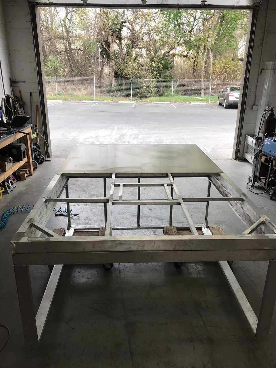

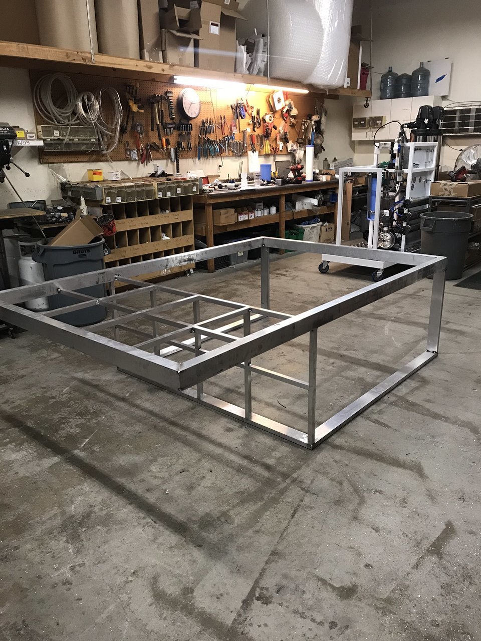

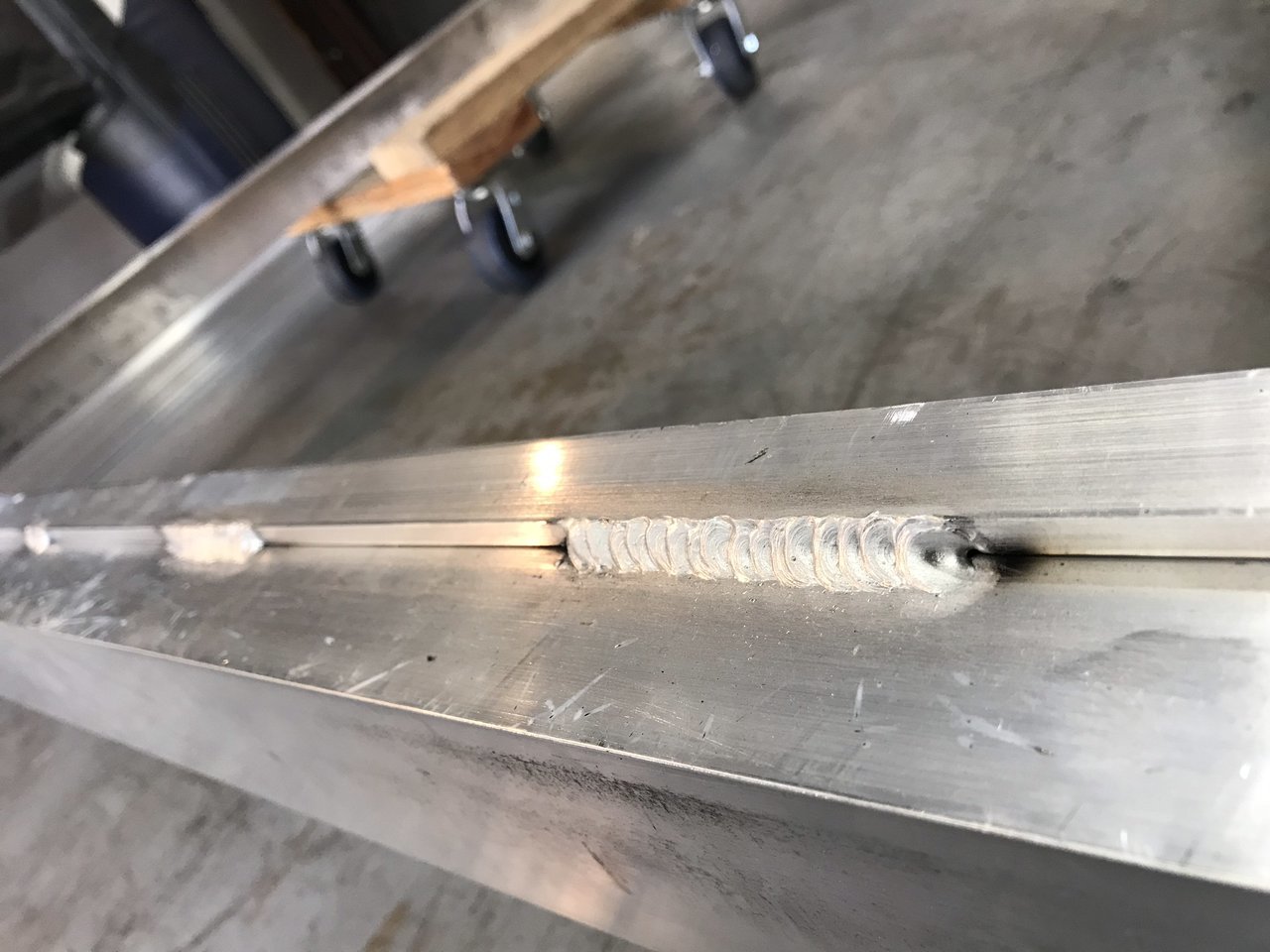

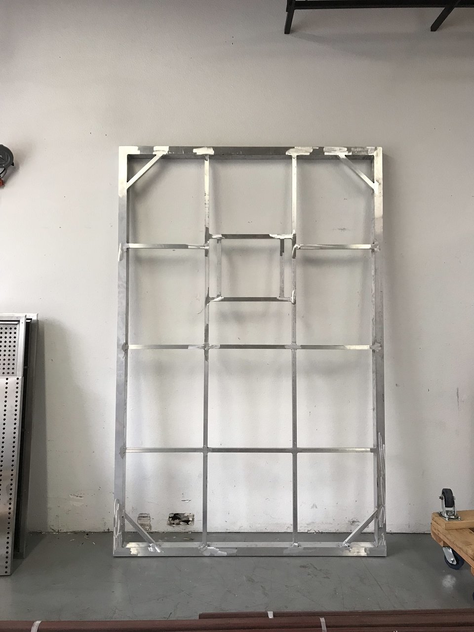

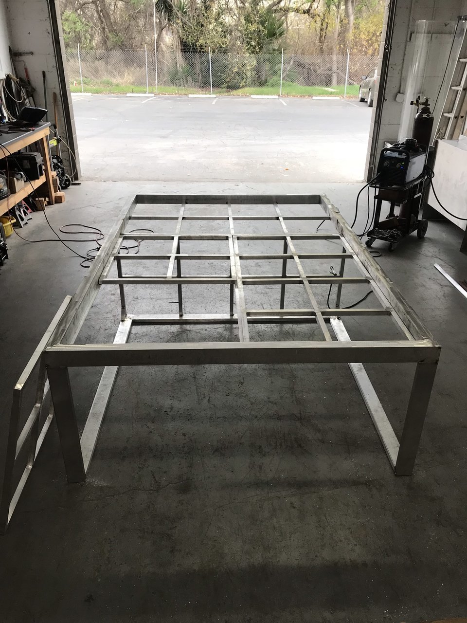

    Day 1 basic frame tacked up
    Day 2 2/10/18

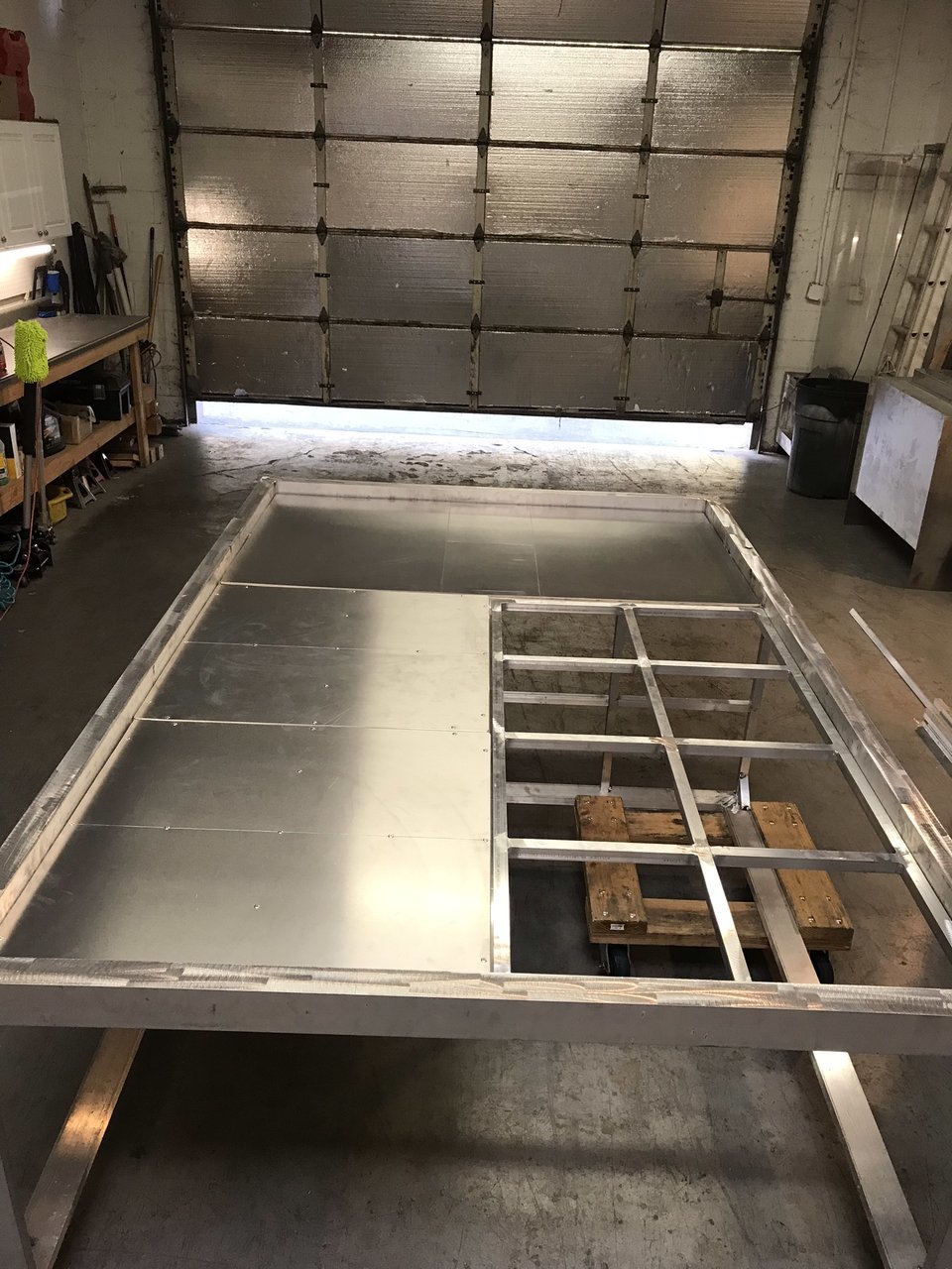

    Sleep platform welded up

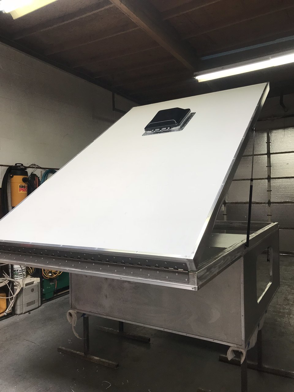

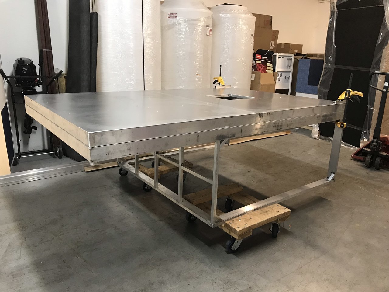

    Roof welded up

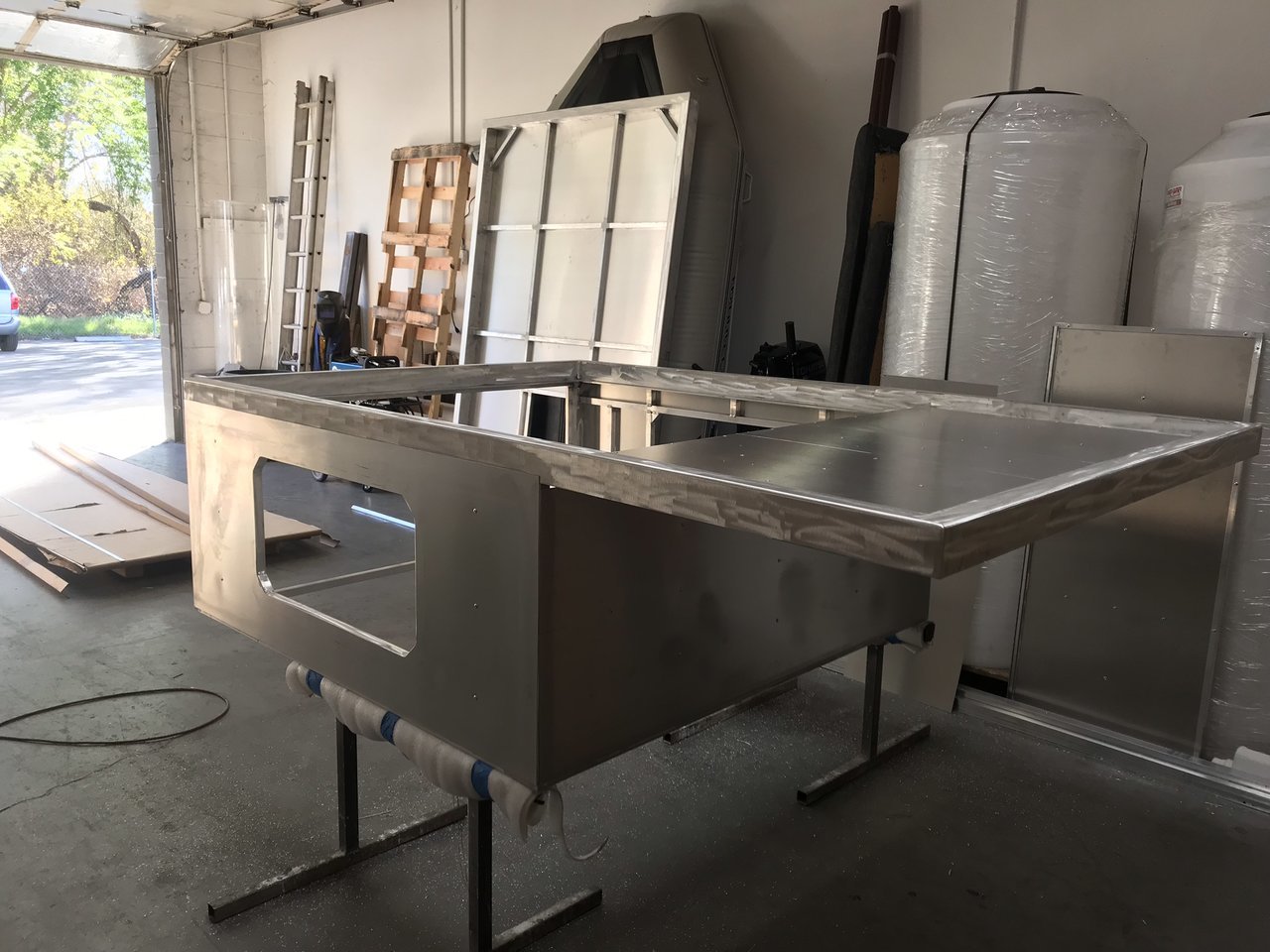

    First sheet of aluminum
    Roof all caulked/riveted up and routed out the vent

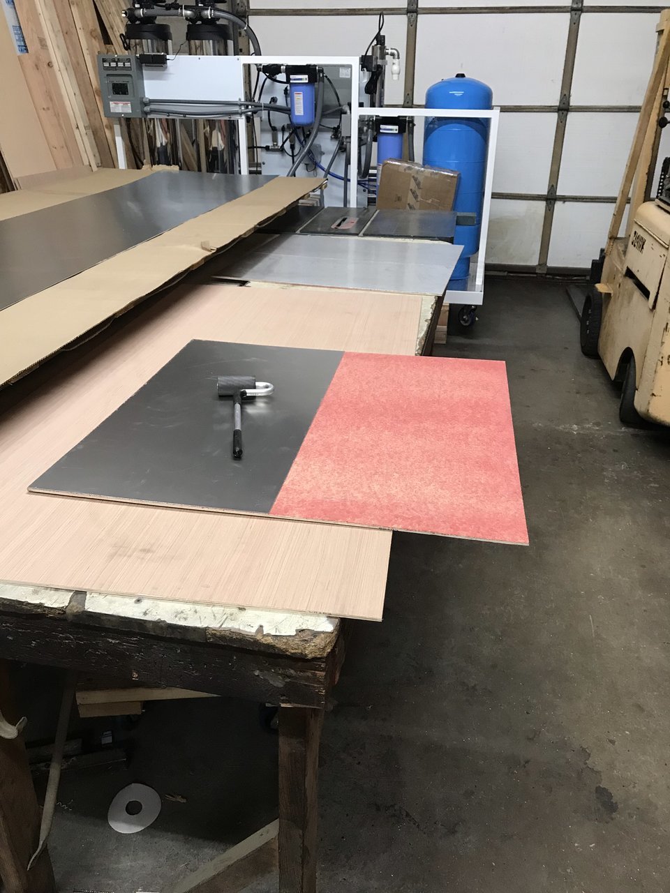

    Glueing aluminum sheeting to plywood for sleeping platform

    Day 3 2/11-Slow progress today riveting sleeping platform and cutting aluminum sheeting. Also got the back door welded up and riveted. Windows,vinyl and roofing liner are supposed to get in on tues.
