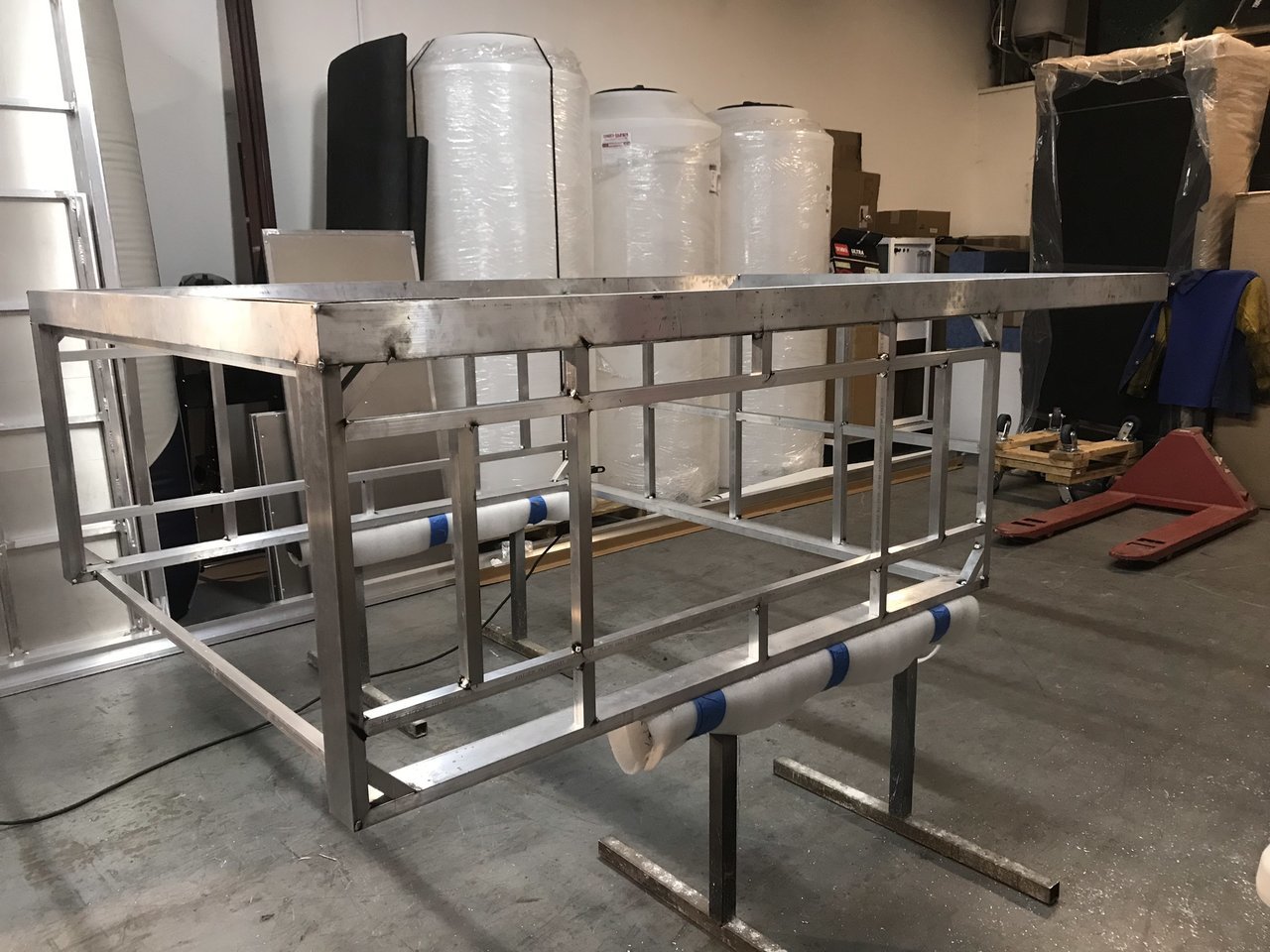

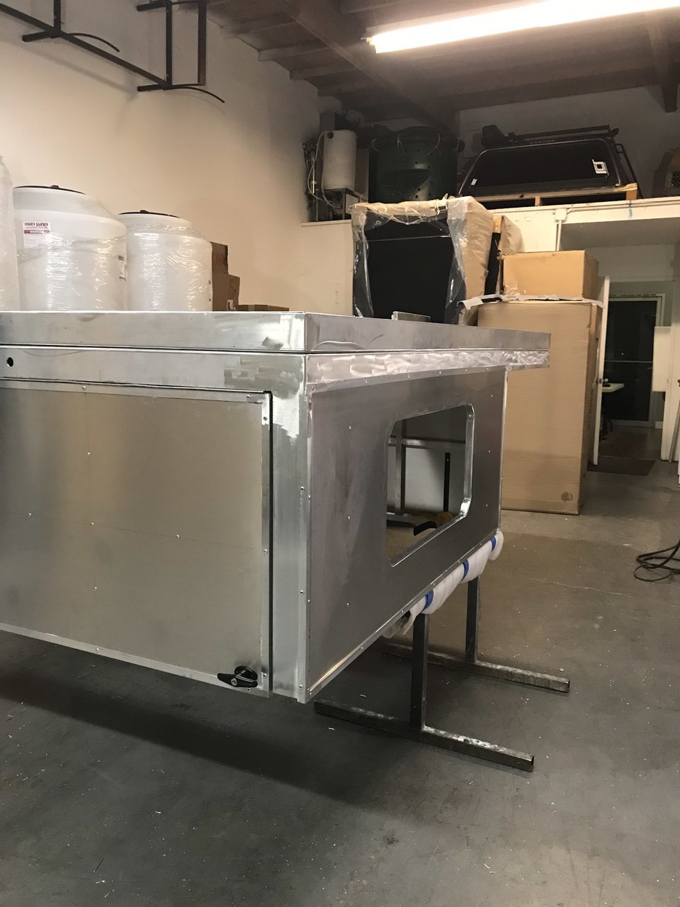

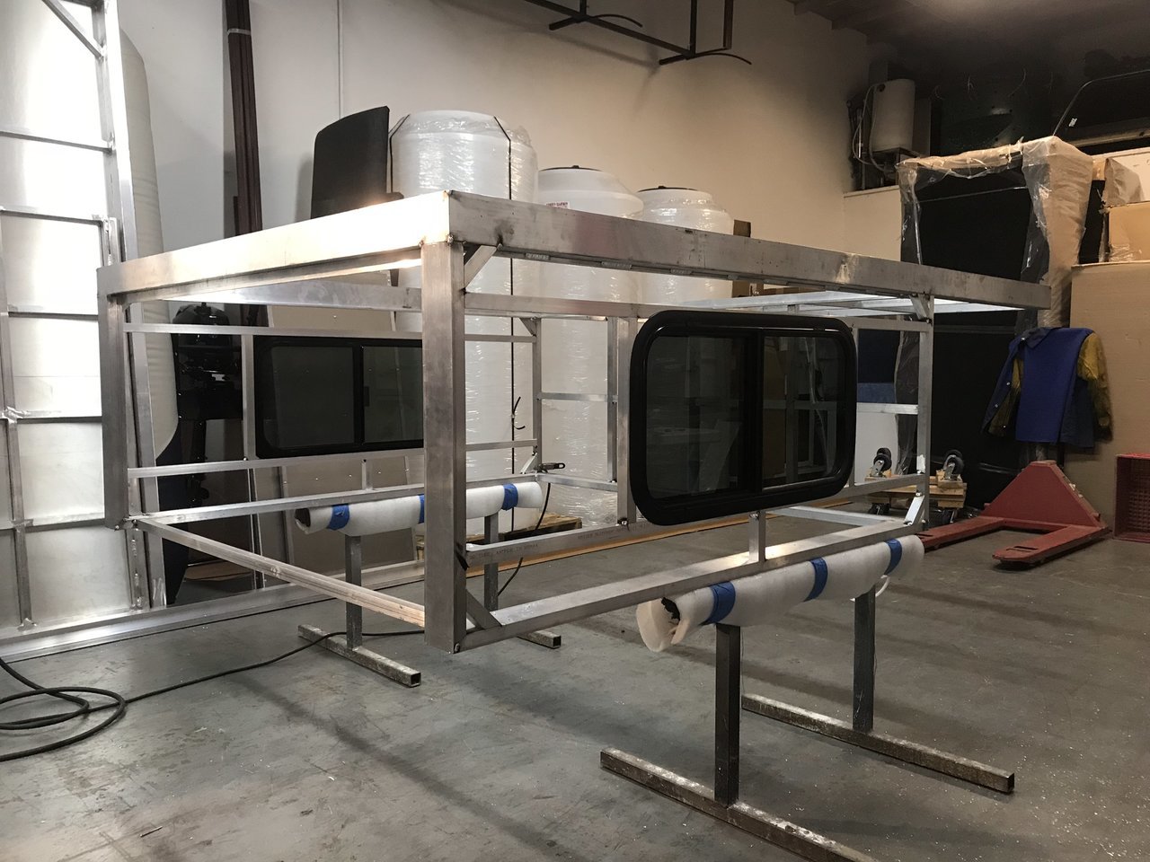

    Day 4 2/14
    Windows finally came in today got them framed out and tacked up. Main structure is all tacked up, tomorrow I will weld everything complete. EPDM super flex roofing membrane came in today which I will apply to the roof this weekend.IMG_4397.HEIC.jpgIMG_4400.HEIC.jpg Got the back door framed up and riveted IMG_4391.HEIC.jpg

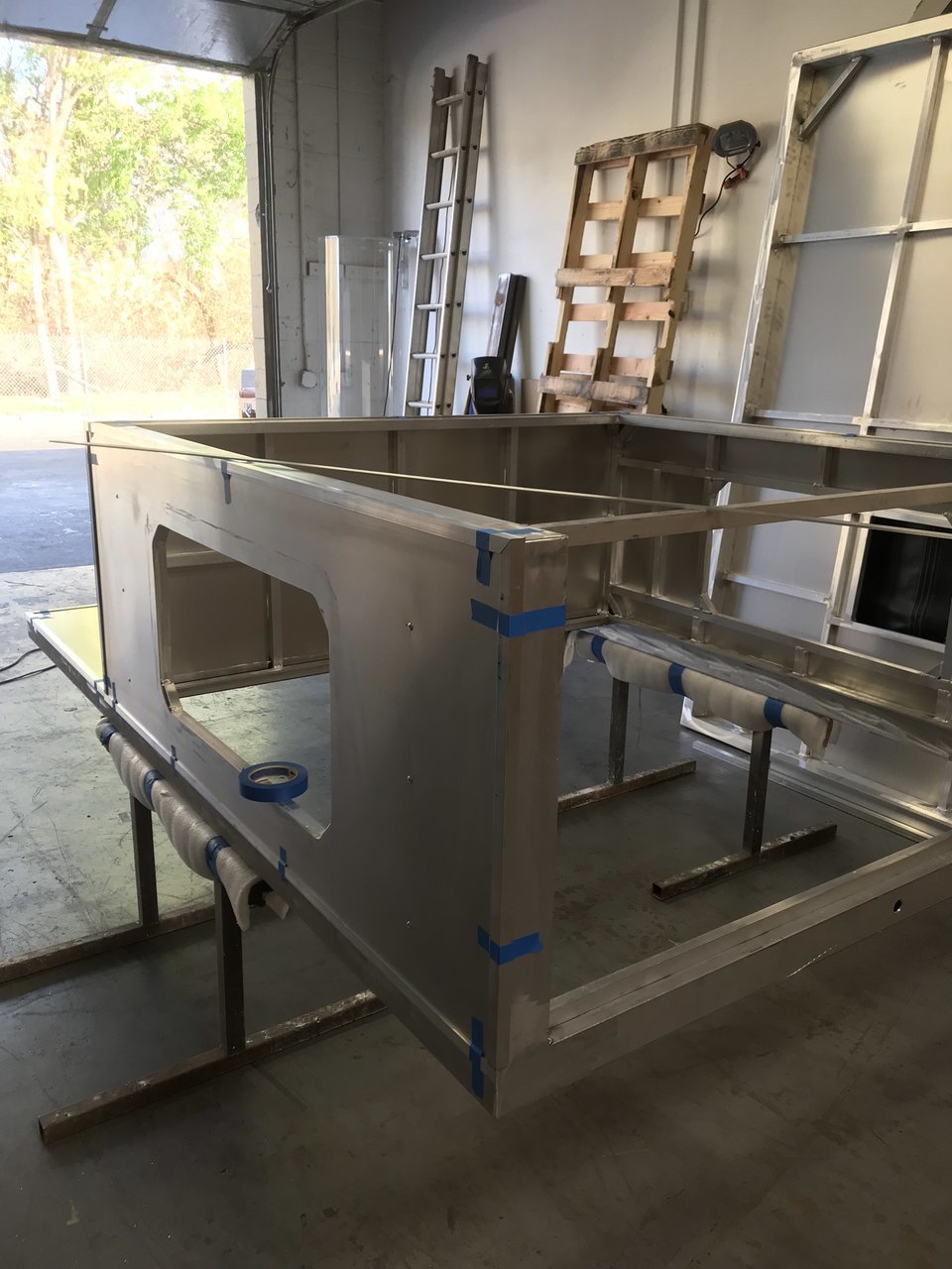

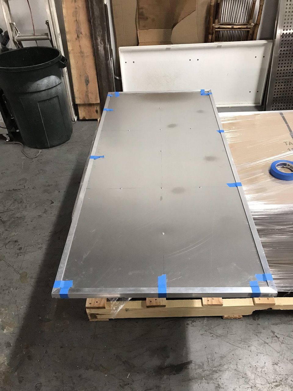

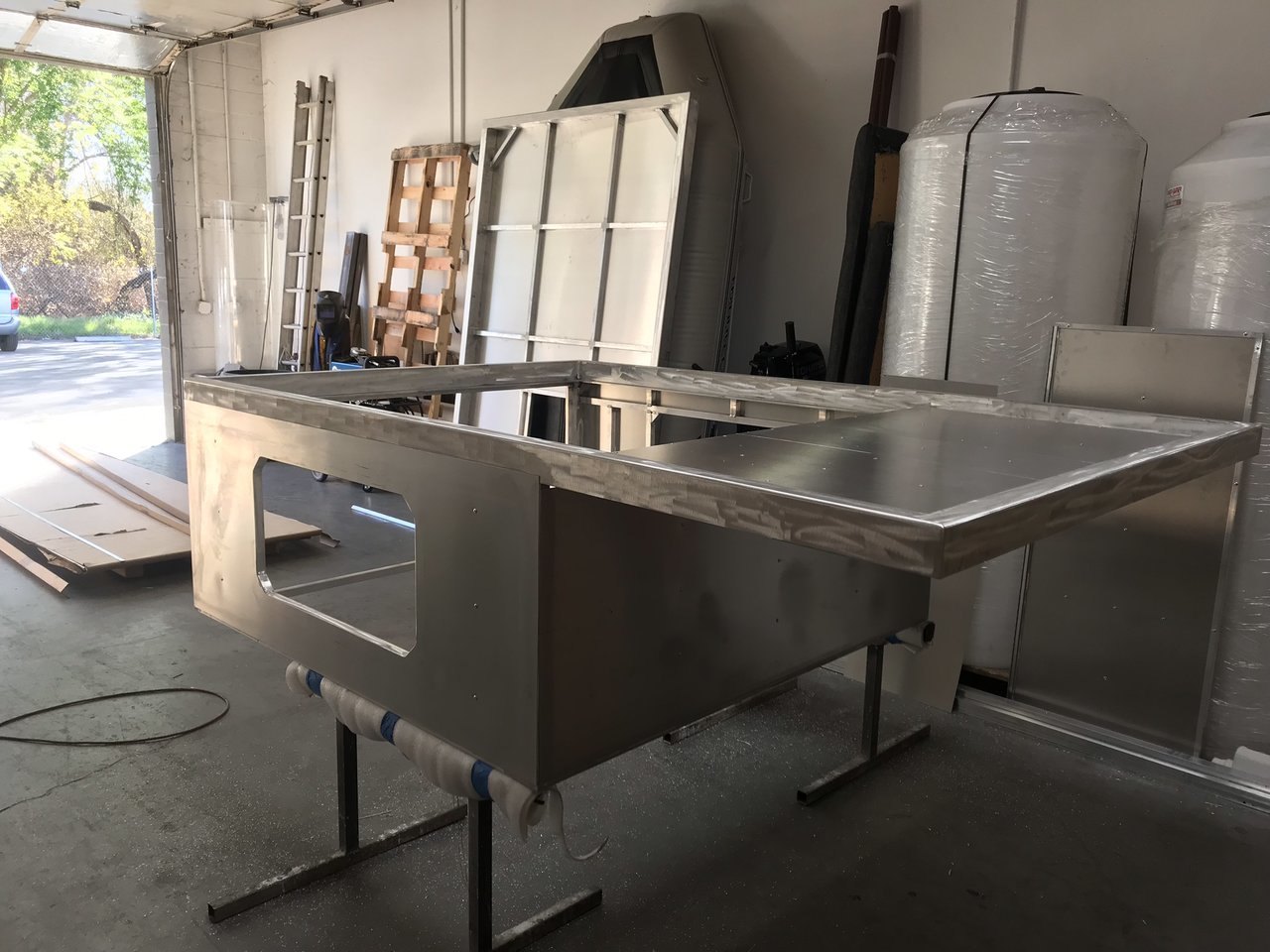

    Day 8
    Progress is a little slower than I was anticipating, I wanted to get the roof mounted today but I took my time mounting the panels.
    Rivet aluminum sheeting to the main structure.
    Routed out for the windows and started cutting trim pieces to size.

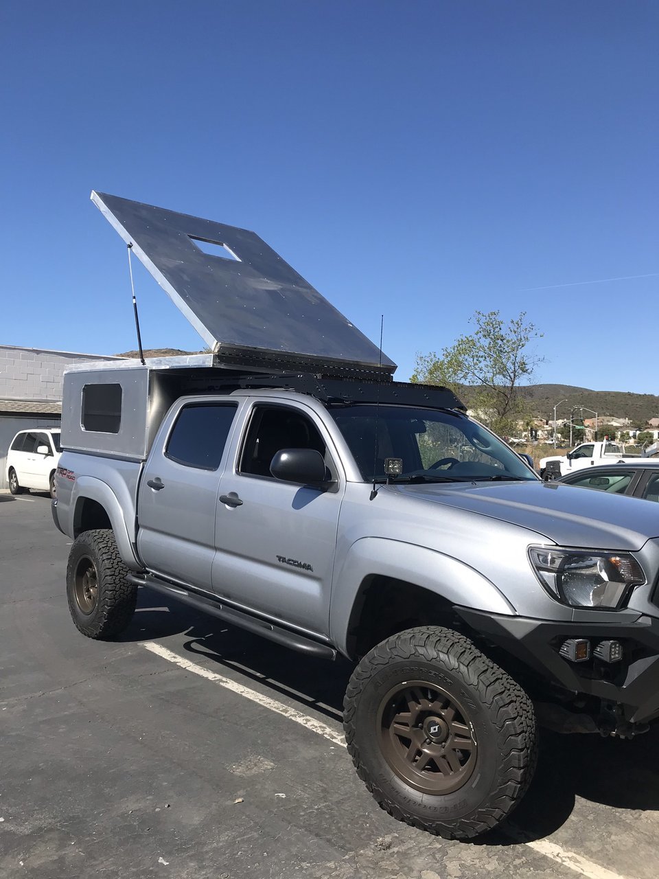

    Day 10
    Back door and locks mounted
    Main hinge on roof mounted, next will be the gas struts
    Hopefully I can apply the roof membrane in the next day or so and eventually start prepping for paint.

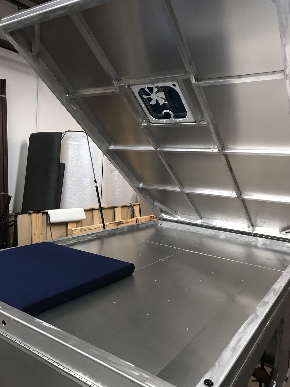

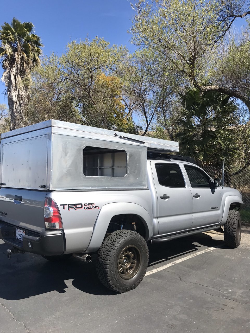

    Day 14
    Rear door alignment
    Roofing membrane EDPM applied
