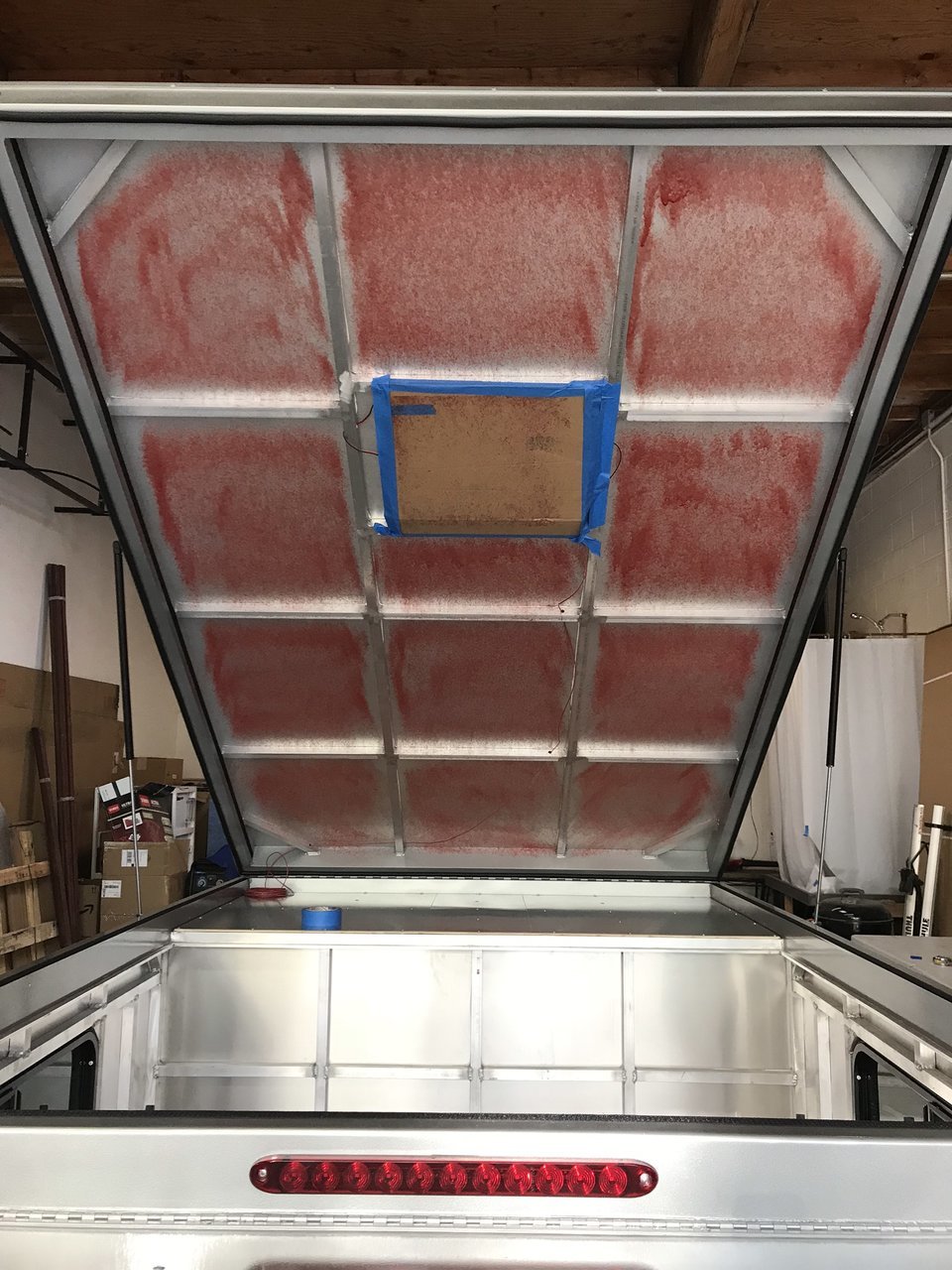

    Paint is all finished. Time to start installing the windows and weatherstripping IMG_4558.HEIC.jpg

    Sherwin Williams ATX . Don't think I'll be attempting a painting task like this again in the future took me all day Sunday and I got a few spots that need to be buffed out. IMG_4453.HEIC.jpgIMG_0007.jpg

    Two questions for you. What do you think it's doing to weigh and how do you plan to weatherproof between the top and base?

    1. Approximately 330lbs
    2. 2 different section of weather striping / D shaped hollow weather striping on the top inside, and flat strip on the bottom where the vinyl meets.

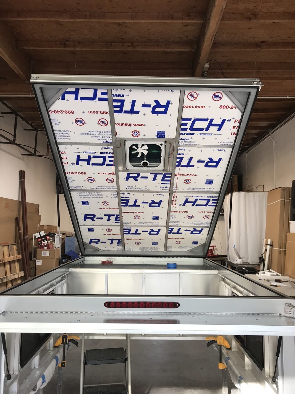

    Well I've got all the cushions sewed up for the moveable platform, I'll need to install foam insulation before I install the inside roof liner and start sewing up the vinyl tent material. IMG_4534.HEIC.jpgIMG_4536.HEIC.jpg

  16. Mar 9, 2018 at 9:35 AM
    #56
    bigdood
    bigdood Well-Known Member
    Jul 16, 2014
    #134063
    139
    How many hours do you think you have into it?
    Yota_Explorer[OP] likes this.
  17. Mar 9, 2018 at 10:30 AM
    #57
    Yota_Explorer
    Yota_Explorer [OP] Well-Known Member
    Feb 3, 2017
    #209551
    99
    San Diego
    2015 Tacoma TRD Off-road
    I've logged every day and hour.
    Started Feb 3.
    At 114 hours spread out through 26 days. I'm getting exhausted from working my job and then working on the project. I am very close to the finish line. Insulation went on this morning and I will start to cut and sew the vinyl tonight. IMG_4621.HEIC.jpgIMG_4623.HEIC.jpg
