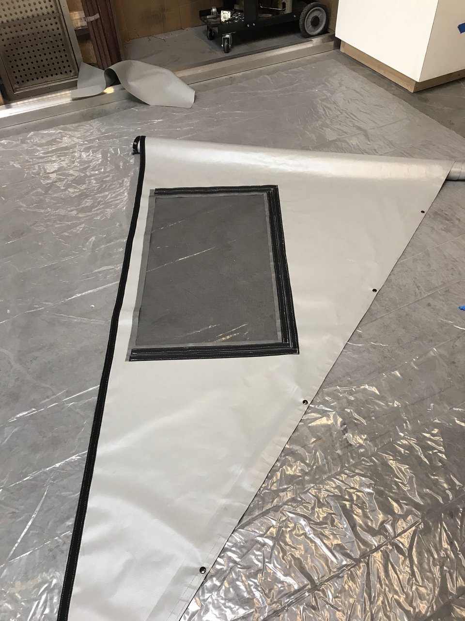

    Very close to being finished. Snaps need to be installed along with the material for the ceiling. Windows will be the last task3F0AF60C-EC67-41DF-A99A-45F177BE4317.jpg

    How are you creating a seal at the bottom of the fabric for water buildup, or do you plan on adding an overlap piece along the bottom? Pretty motivating going through all of your updates seeing how its all put together :thumbsup:

    The material lays flat on top of the frame at the bottom, any water will run off. There is a strip on the inside of the frame to stop any water from touching the cushions if it happens to seep under the vinyl.

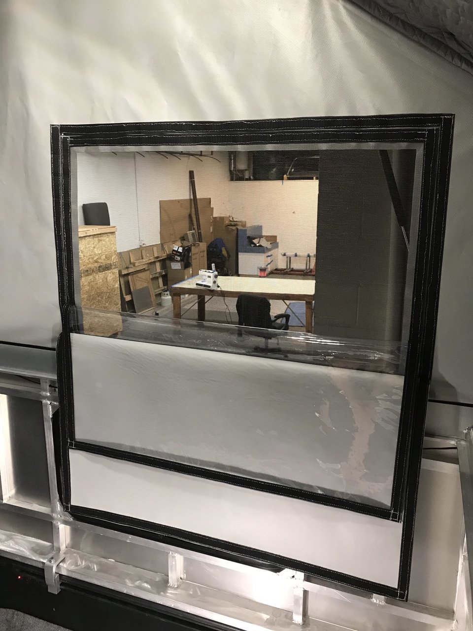

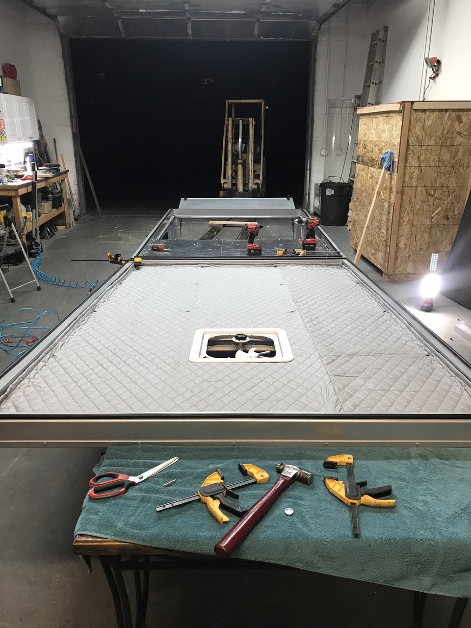

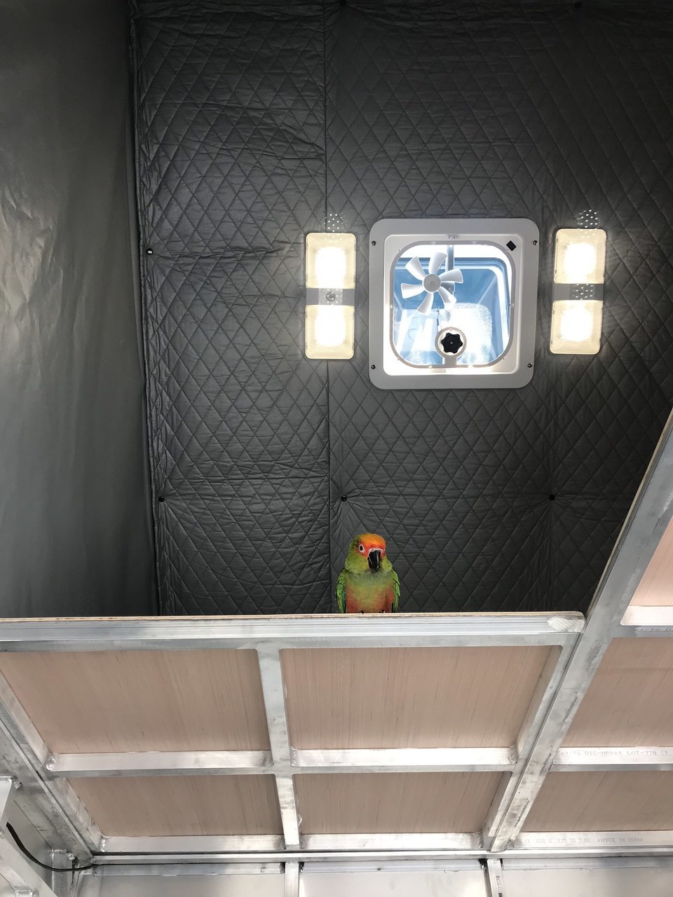

    Lights and fan all wired up
    IMG_4769.HEIC.jpg Window time
    3 Layers Screen, Clear vinyl, privacy vinyl
    jamesfishn09, Mully, Blais03 and 14 others like this.

    list is growing fast
    oh heck ya dude. Solid looking custom. is that a macaw in there striking a blue steel? :thumbsup:

    Gold Cap Conure I've had for 6 years he's loud and small.

    After doing a water tests I'll be sealing all my seems and stitches with HH-66

    Had a 2017 TRD Off-road, now a GMC AT4
    Had these A.R.E. Overland Truck cap, Cover King Tactical seat covers, OME BP-51 full suspension and dakars, SPC adjustable UCA's, Husky Floor Mats, Mobtown Off-road sliders, Cali Raised light bar and ditch lights and bed stiffeners, mobtown off-road front ifs skid, uniden bearcat CB Amd firestick. Now a super fancy stock truck!
    Is that like a foam board for insulation?

    I was wondering about windows!! Looks great and I’m sure the fan will help a lot too!

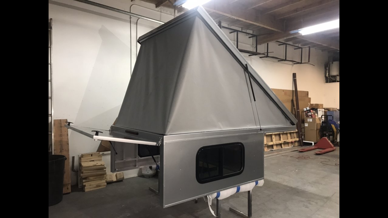

    Hehehehe birds are funny creatures! I bet he enjoyed hanging out there

    Outstanding!
    Yota_Explorer[OP] likes this.
