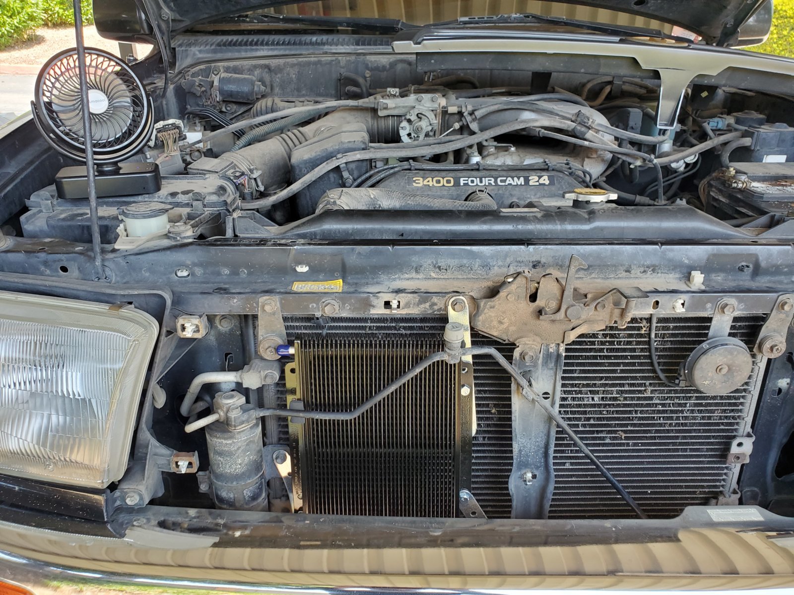

    I'm a little over one year in and running red coolant, what should I switch to? and why are alloys so overcomplicated lol.
    My all aluminum radiator.

    Well the one you listed said this......
    • Refill radiator with fresh Coolant / Antifreeze according to the volume and formula specified in your Owner's Manual. Inspect levels and condition every year.
    so it must be tested safe with the red......
    Mine is not that way....
