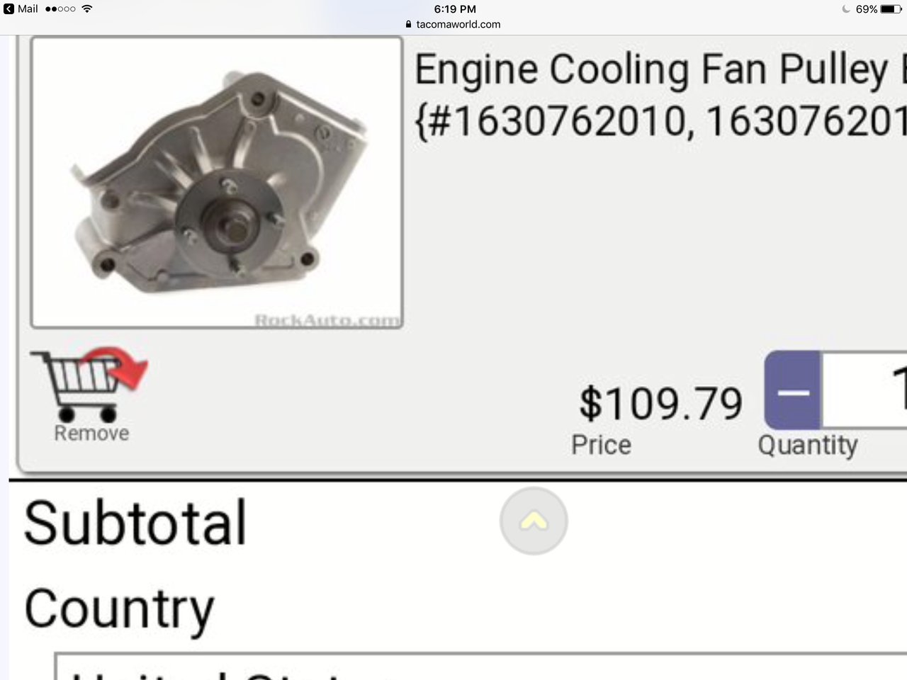

    When I got home (5 hours after I left work). I searched out the best deal I could find on a new Fan Clutch and Fan Support Bracket. Rock Auto was the best deal in town. $100 + Cheaper than Amazon, even with $16 for second day shipping for the 2 items.
    My thinking on these 2 items is... my truck has 265,000 miles. I have to pull both items to get at the timing belt etc. I'm not putting the old ones back on.

    Glad you got the pulley bracket with bearing, mine went out and locked up the whole front end of the engine and left me high and dry dead on the side of the road, no warning

    I went back and forth on ordering it. But my luck, if I didn't do it now, I would have had it lock up 10 miles back on a dirt road and I would have been even more pissed that I didn't do it now, while I already have it off.

    Yep you have to replace that bracket with the bearing inset there, it's just like all the other bearings
    up front there running ALL the time and it will go out on you sooner or later , mine with ZERO warning.
    I learned the hard way, most people don't do this bearing for whatever reason

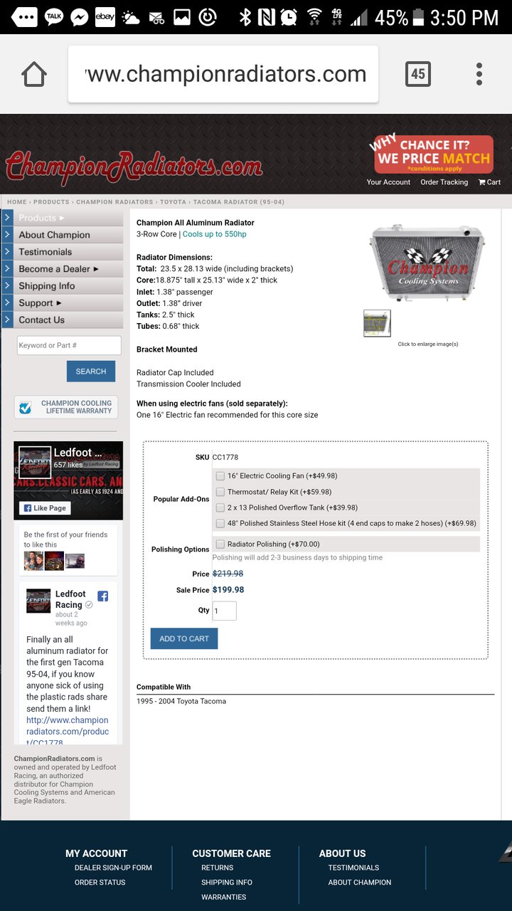

    Might be a dumb question but why in one picture does it state “cools up to 550hp”. Then in the other state “cools up to 700hp”?
    Just curious cause I’ll probably be ordering one myself to help keep this 4bt cool.

    I noticed that too. The 550 hp is a screenshot from Champion. The 700 hp is a picture I found of the same radiator where it was listed on Ebay. (it was just a better pic, with the dimensions)
    The 700 hp claim is probably from the seller on Ebay. I suggest getting the radiator direct from Champion. That way you know it's not a knockoff... AND I've always seen it listed on Champion's web page for cheaper than it's listed on Ebay.
