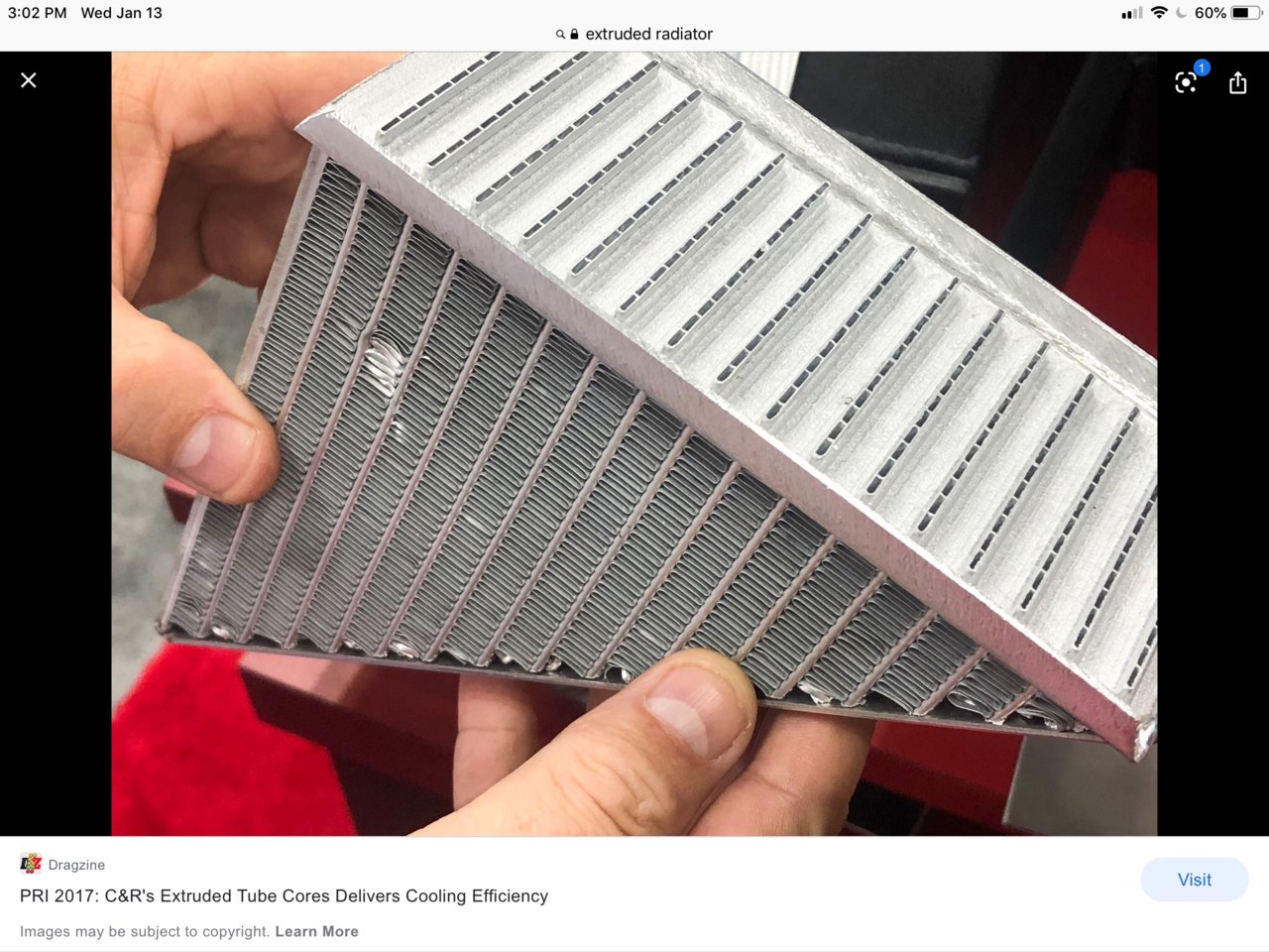

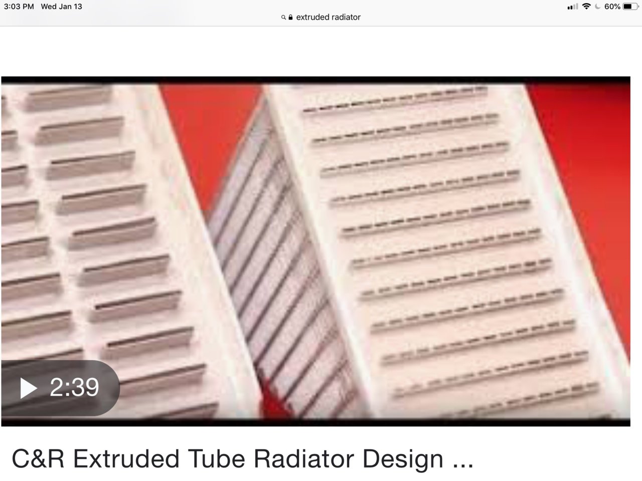

    My custom radiator weight is around 35 pounds with thick aluminum extruded tube design that is much stronger and the Champion is 15 pounds and stock plastic radiator is 10 pounds

    Does a 20 pound addition even make sense? Especially with aluminum, thats a huge amount of extra metal. Why is there such a disparity, its still a 3 core radiator so its not like 5 lbs of thst is for a fourth core?
