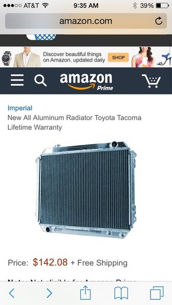

    Here is the Amazon link
    https://www.amazon.com/dp/B00VQMGZ6Y/ref=cm_sw_r_awd_UA.Uvb6449ZBB
    It says it has the transmission cooler. And looks like it has the ports on bottom according to the pic. And I can't remember but it seems like those are the same measurements as mine was for the auto. But check yours to make sure.
    Only two left in stock. Grab it while you still can. Wished I had the extra funds to get one even though I don't need it.. yet..

    Yeah i have a 2.7L 4x4... I wonder what the quality is like since most aluminum radiators are so much more expensive. Amazon says this wont fit my 99, but there is an identical one on ebay that says it will fit
