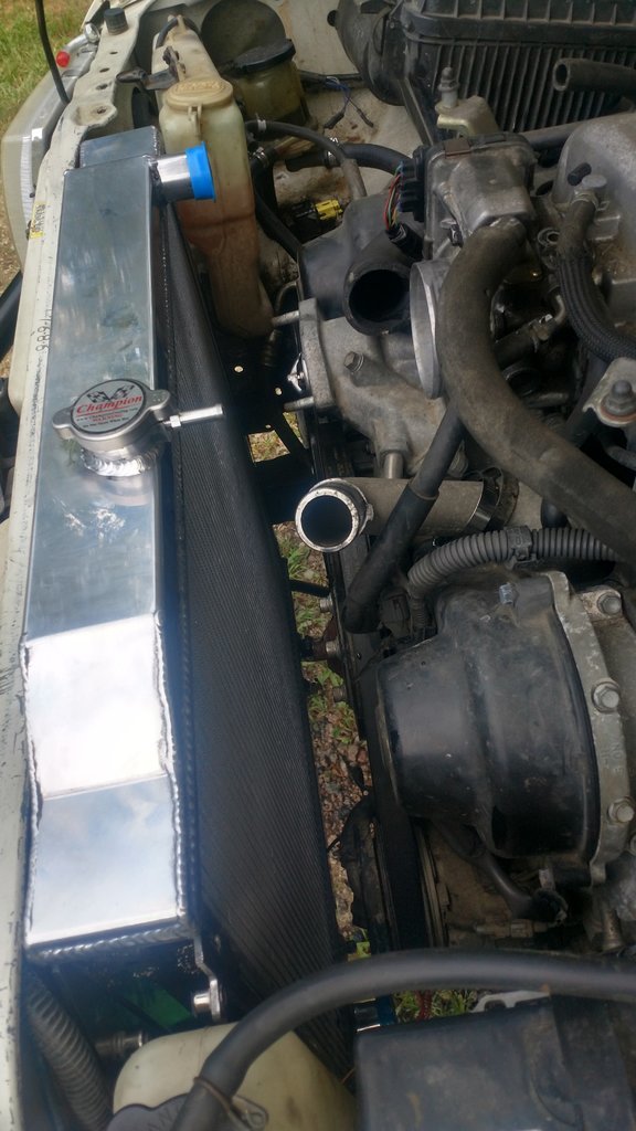

    Nice. How did you make it work on your truck? Clearance out the hood?

    I need the inlet and outlet to switch sides. Since I'll have them moved, I'll get the fill neck moved too.

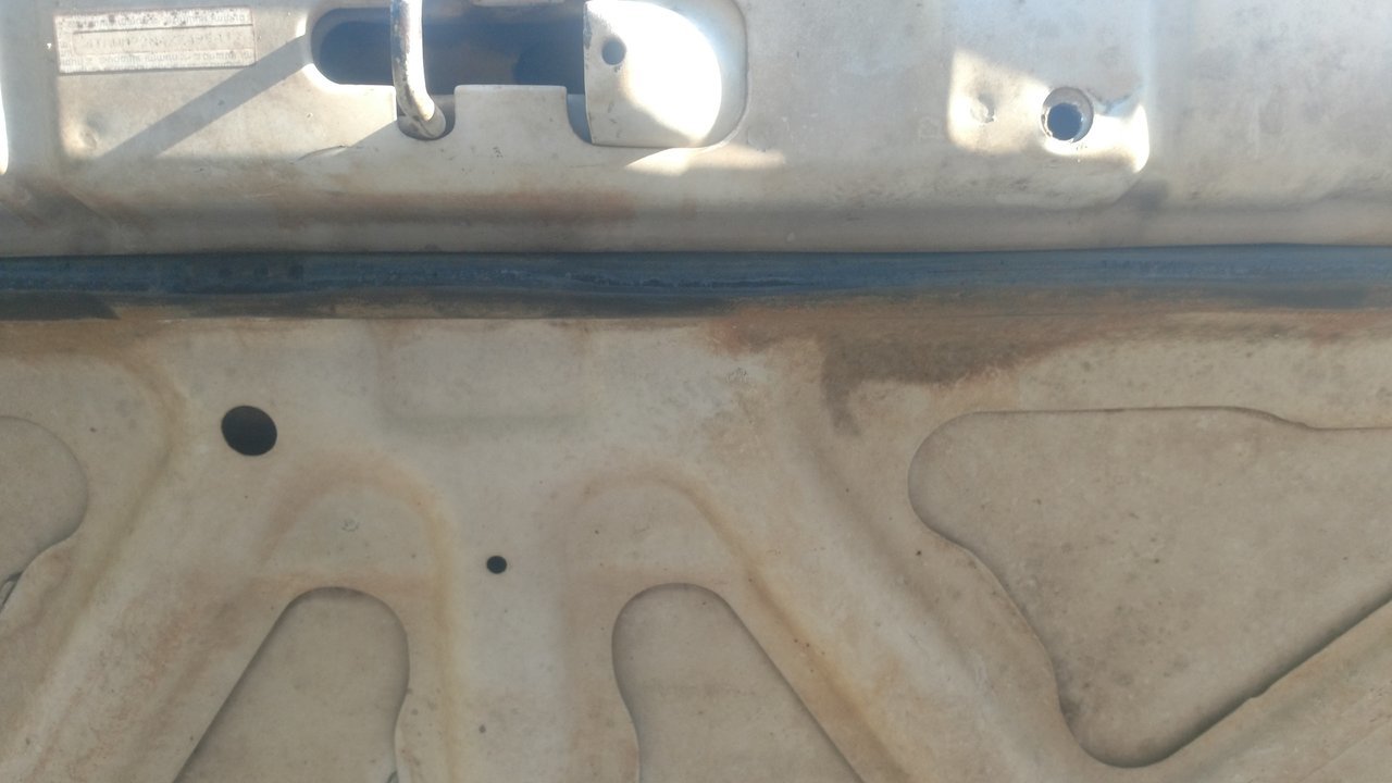

    I don't know if you can see it, but just to the right you can see the marks from the cap hitting.

    Thanks man - I got a mishimoto stock replacement for $100 free shipping so I ended up going with that, but in the future this could be an option since I'm going to get a fiberglass hood and that should have less material there. Did you get your CEL codes squared away?

    I'm running a Full Aluminum Radiator , from Radiator express $300. Meant for the 2.4 but works fine, did have to mod the fan shroud and lower rad hose. Did it fit, no I had to modify the mounts but all in all I love it and don't have to worry about breaking another plastic one.

    I'm running the 4runner radiator in my Tacoma. Fits good. Bolts right up, but the fill neck puts the cap right under the hood brace and it rubs. I had the fill neck moved, but understand that's not an option most want to deal with. However, my situation is a little different though...
