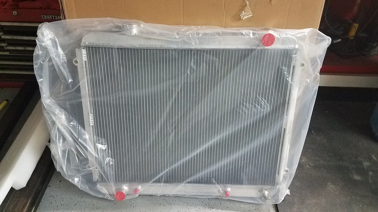

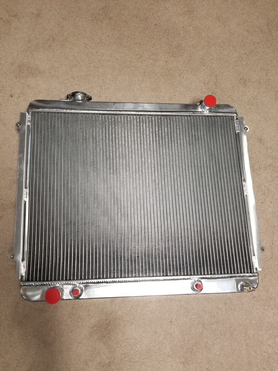

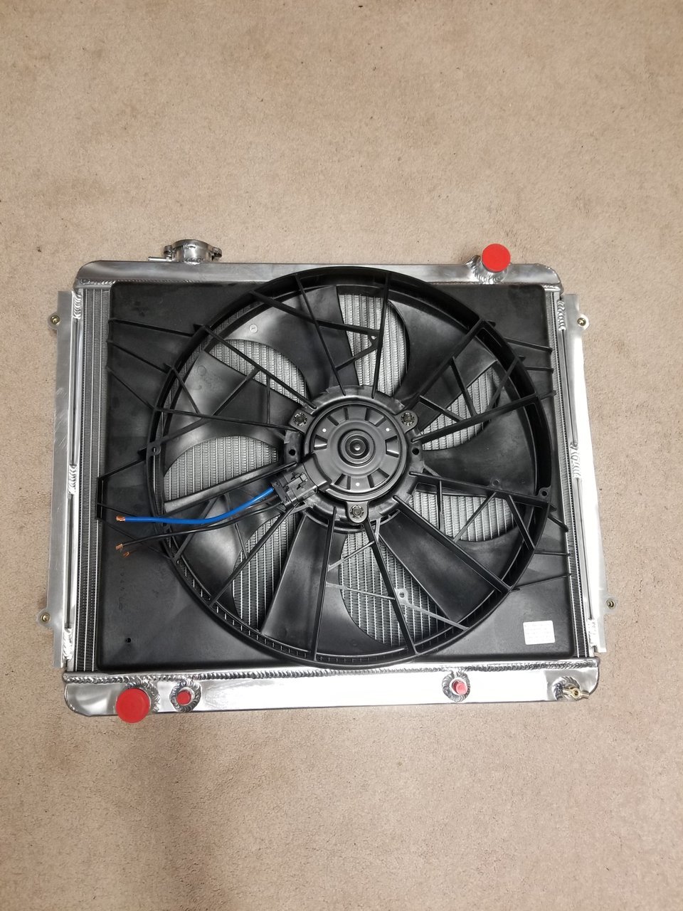

    I needed to replace mine on my 1995 2.7 4x4 Manual. The replacement was actually a V6 one with trans lines. Apparently they are the same dimensions for my truck. I ordered one from Oreilly's at the time and it didn't match so they pulled out the radiator that says for a V6 and boom it was a perfect fit.
  8. Feb 17, 2018 at 6:48 AM
    #88
    ToyRyd04
    ToyRyd04 Taco Transformer
    Aug 5, 2011
    #61217
    1,794
    Greg
    Perryville, MD
    '04 PreRunner
    SAS'd PreRunner Diamond Axles Crawlbox
    Received mine, looks good from initial inspection. The overall thickness is alot bigger than the factory radiator, which should help cooling by alot.
    Will also match very close with my Mark VIII electric fan and simple aluminum shrowd to bridge the small gaps.
