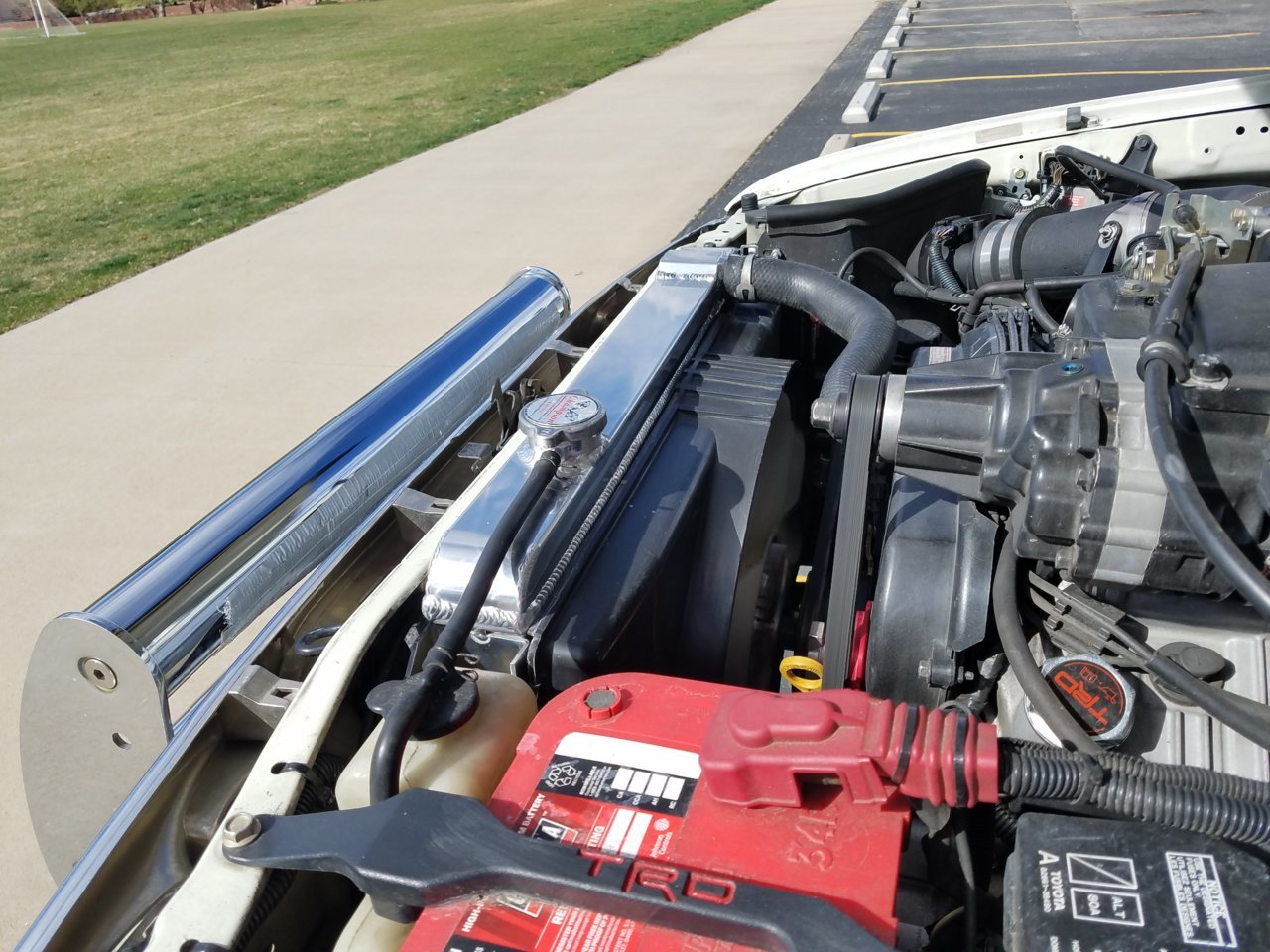

    Well it’s in the truck, now another thing to find in Fairbanks on Monday is a shorter bottom hose. It needs to be about 2-1/2” shorter than the original, same offset just shorter. Anyone done this and have a number for the hose handy?
    Behold it would appear that a Gates 22120 can be made to fit. Thanks to 1997Tacomav6 for the write up.
    https://www.tacomaworld.com/threads/champion-radiator-aluminum-3-core-swap-3-4-supercharger.543859/
    Fits pretty good, looks like a quality build. Guess time and a bottom radiator hose will tell

    If anyone wants a champion 4runner radiator, i have one that I never used I'll sell.

    Does this have the original filler or did you modify this one for your tacoma?

    Stock location
