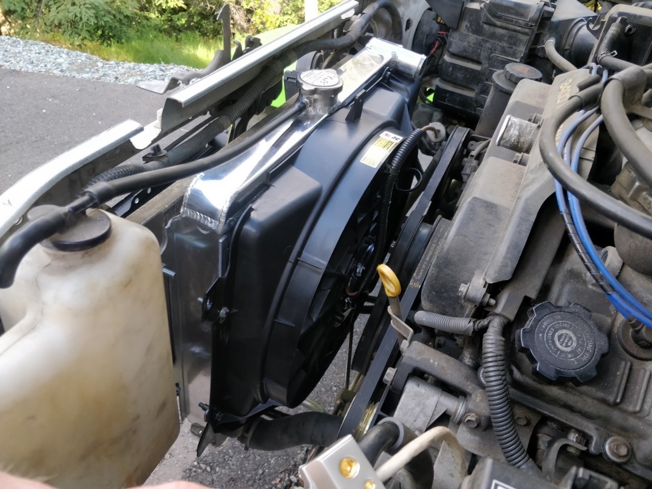

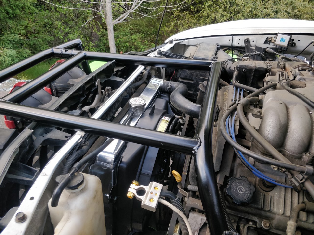

    I did a 22re champion radiator, and to go along, the popular Ford taurus fan swap. Mine was for another reasons however. To accommodate the engine cage.IMG_20190416_184410.jpg

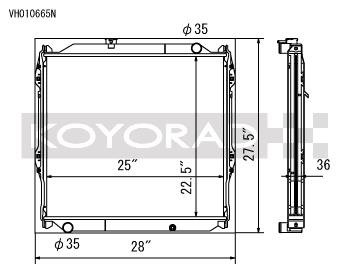

    It looks like the KOYORAD #
    VH010665N
    Will stick down below the frame rail it has a 22-1/2” core. My Champion C1778 has an 18.75” high core.

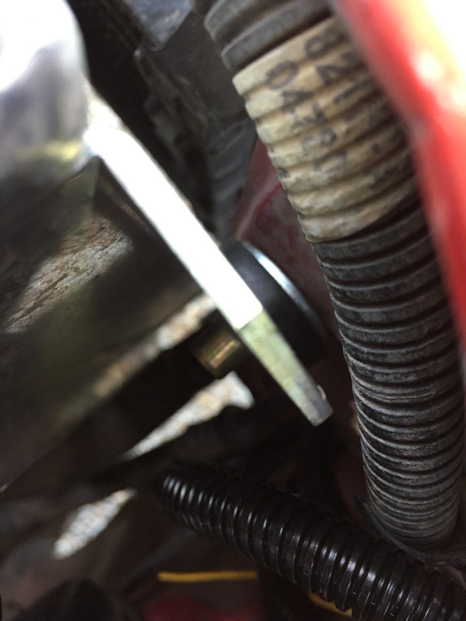

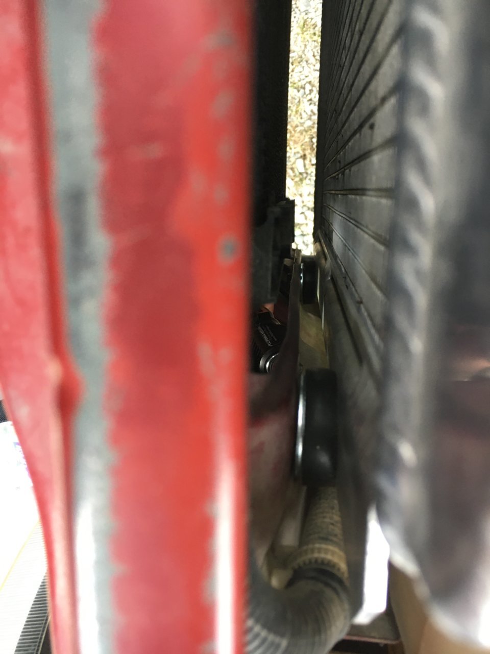

    F5EFF17A-FB97-44A1-93F7-0B1099BFDE16.jpg These aren’t the best, kinda dark and close in there:F60E0E15-6A6F-4AF4-A408-B18D8757E56E.jpg
