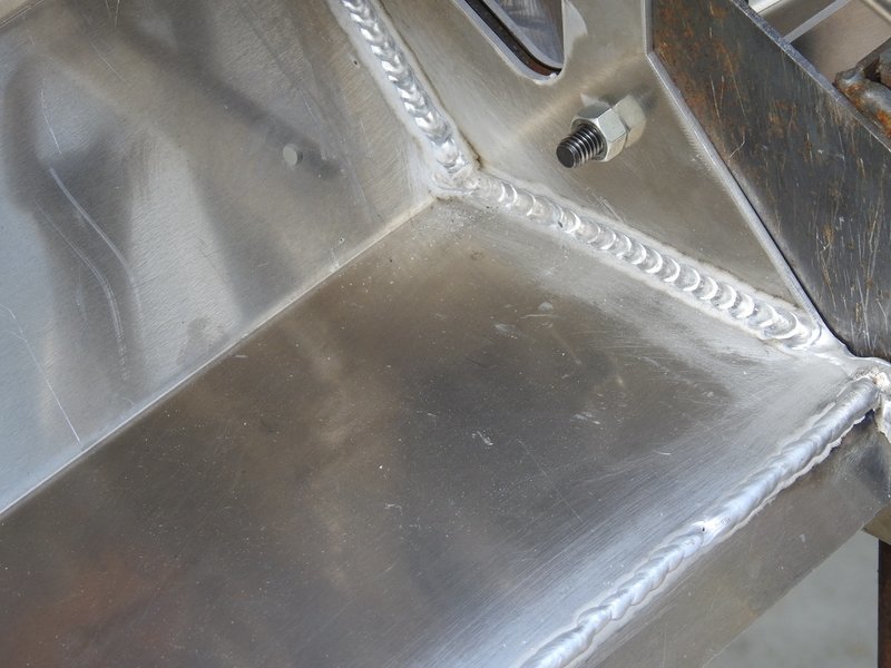

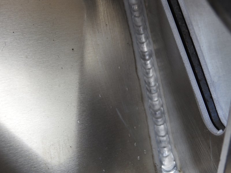

    Yes the welds and using the propper grade aluminum are crucial! All products are welded in house with pulsed mig with a push pull setup, The biggest problem with aluminum welds are the starts and stops. My new welder actually has a hot start setting and a crater fill setting to help with the cold starts and crater cracks.
    These welds are not the greatest as I'm still getting used to the settings but this welder lays some nice sound welds
