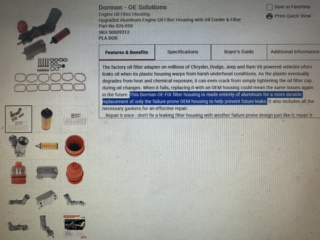

    Post 210 & 212 of this thread have pictures and info on the aftermarket’s solution to a plastic coolant piece on Corollas that’s prone to leak.
    Here’s a solution for the plastic oil filter cooler assembly's on 3.6 liter Jeeps that’s also prone to leak (oil).
    It would be nice to see something available for the 3.5 Toyotas.

    I just picked my Chrysler van from the mechanic. Replaced that oil cooler on the 3.6L engine. Doorman all aluminum part with a lifetime warranty. 158xxx miles/14 years old van.

    Took us a month to figure it out. Thought my transmission was leaking. Put in UV dye, could not find any ATF leaks. My guy pocked around more. Found drips on top of the bell housing, followed them up, found the leaky oil cooler. He said the valley between the blocks was filled with oil.
    I have a great mechanic. Did not charge me any for all of diagnostics. Just labor and parts to replace the cooler and 2 sensors going into it.

    This issue is common with Chrysler. So much so that when we are doing an oil change on a 3.6 and we see oil dripping on the exhaust crossover pipe or on the trans bell housing, like you stated, we get a flashlight and shine the light down into the engines valley to check if it’s wet. Of course, sometimes people spill oil there when replacing the filter but the one we did today was an obvious leak. The job pays 2.8 hours of labor.
