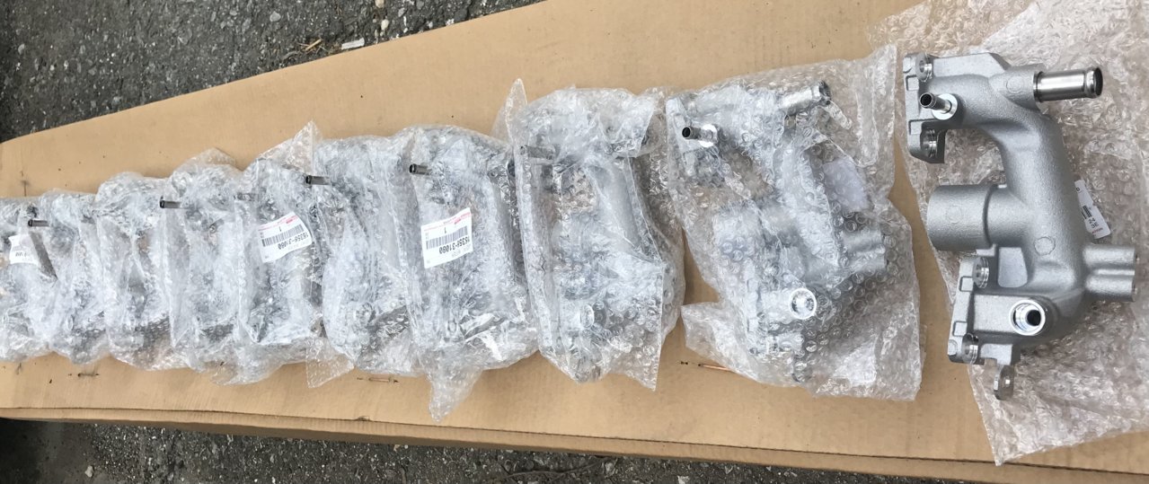

    Fresh from Japan. A small run of these will be underway shortly.

    Refit with a 90 degree elbow?

    Yes, refitting with a 90 of some sort/TBD
