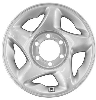

    The OEM rims on my '03 PreRunner are looking dull. They are the aluminum rims like the one pictured below. I took some Flitz metal polish and with some elbow grease they cleaned up nicely. Microfiber cloth was gray/black afterwards.
    I'm considering using something stronger, but wasn't sure if these are painted rims with a clear coat or aluminum alloy rims or both??

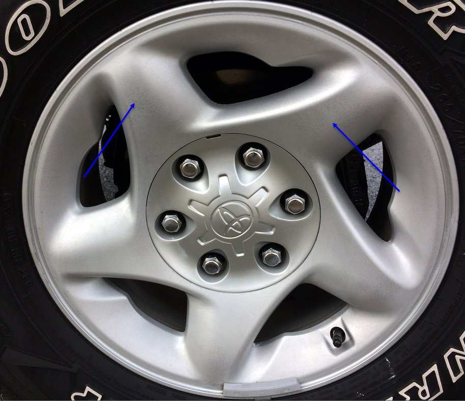

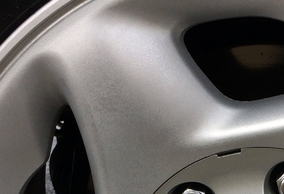

    Below is a pic of my rim. You can see where it's discolored on the high spots. I don't think that's clear coat coming off, but I could be wrong. Maybe that's the paint wearing down to the original finish?

    Yeah, looks like it's wearing through the original finish. Maybe just a layer of paint, no clear.
