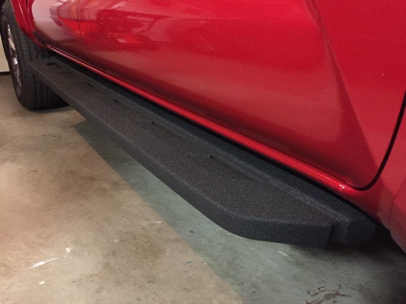

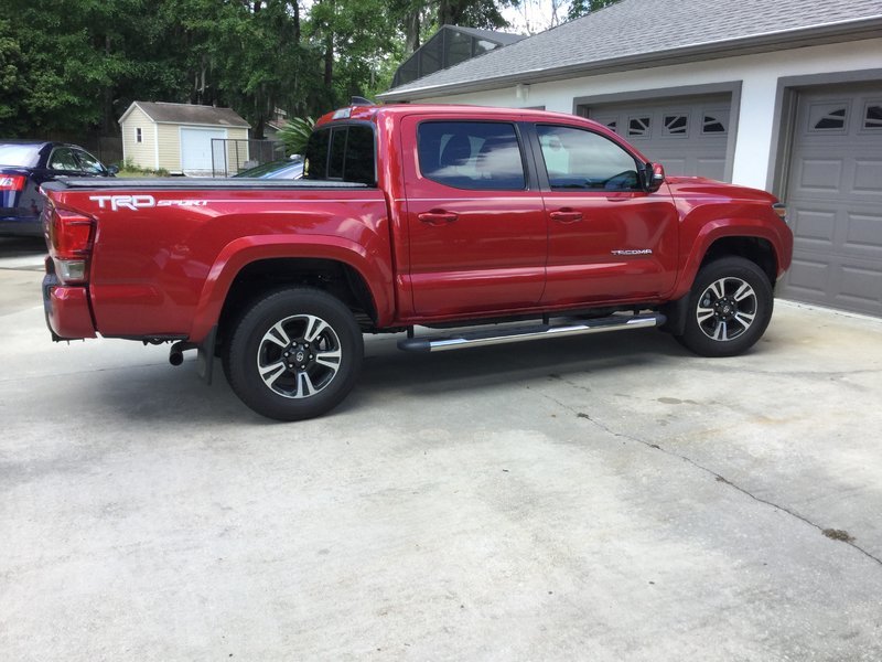

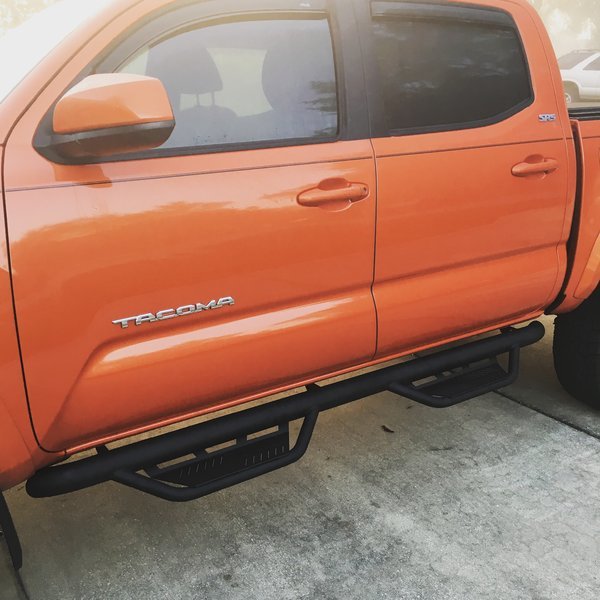

    Yeah, I was hoping that they just sold longer brackets so I can switch them out, but I guess that would be too easy. Here's a pic.
  8. Nov 12, 2016 at 7:00 PM
    TVC
    TVC [OP] Member
    Sep 18, 2016
    #197615
    19
    2016 Tacoma SR5
    Tri fold tonneau Aluminum running boards
    Those look like the perfect height. Not everyone needs them high, I'm not going off-road with it.

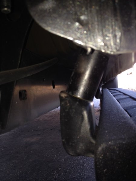

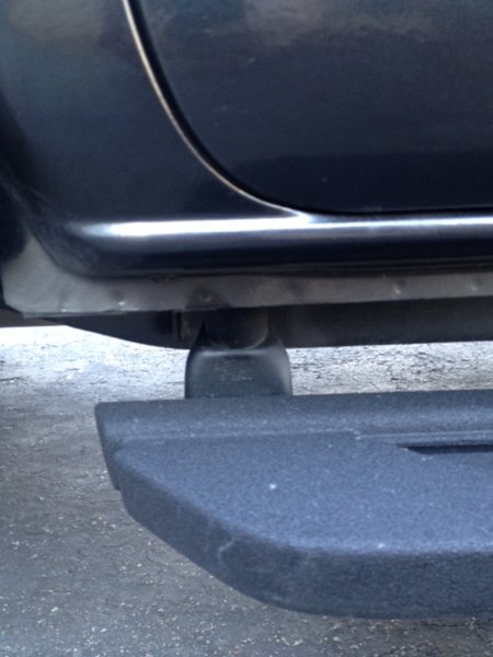

    Bracket1.jpg Bracket2.jpg Bracket3.jpg Well I think I resolved the cast aluminum running board problem. Got the hint from another post. Pipe....Yep...Pipe. 1 1/2" black pipe cut 3" long. You do have to get longer metric bolts so I ordered those thru Amazon Prime. Get (12) 8m 1.25 100MM bolts, stainless if you can. These will replace the little guys that came with the brackets. Cut (6) 1 1/2" black steel pipe to extend the brackets down. *Do not get pipe nipples that are threaded. Now this is the tricky part. The two rear brackets are identical but the front bracket is slightly different so you also need (2) 3/4" black steel nipples cut ~3.25". You see you can't bolt through the front bracket as you do in the rear so you have to re-drill the front bracket to fit. No big deal because the brackets are soft steel not tempered and one other thing about the front bracket...you have to pinch the end that you are bolting just slightly in a vice by about a 3/8". Once installed you now have your boards down about 3 inches. But this is the bonus. Since the brackets are mounted at a slight angle on the body you are not only lowering the boards you are also bringing them in by about an 1". So that little issue of rubbing the back of your leg just about goes away. You can go another inch lower just remember the clearance issue and you will need to go with longer bolts, nipple etc. I did paint the pipe before I installed them so hopefully the rust will be limited.

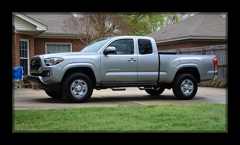

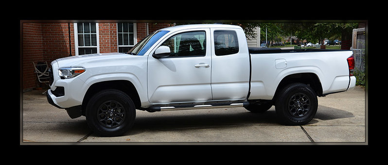

    I'm 5'8" and up in age. the stainless steel running boards I had were definitely way too high. Difficult to get into the truck and always dragging my leg against the running boards when I got out.
    About The 3rd time I was climbing into the truck, I slipped and ended up with a meniscus tear in my left knee. Took two surgeries and 4 months of therapy to get me back to walking. A year later, and I'm still limping.
    Shortly after I slipped, I took off the running boards and sold them to the first person who wanted them. I disliked the 2016 Tacoma (SR) so much that I decided to trade it in on a 2016 Tacoma SR5 without running boards. I then purchased the OEM aluminum steps that made it easier to get into the truck, and no more dragging my leg when stepping out.
