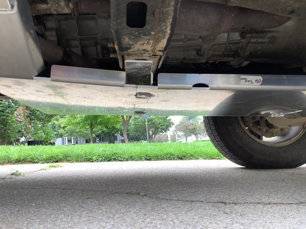

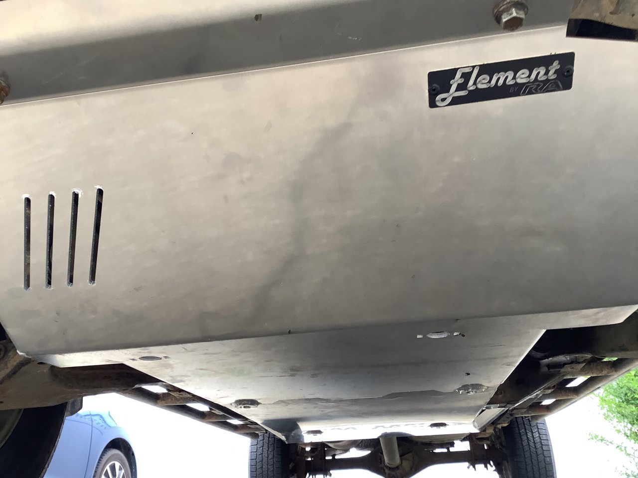

  8. Jul 11, 2021 at 2:39 PM
    Marc70
    Marc70 Well-Known Member
    Nov 30, 2015
    #171048
    427
    Marc70
    Northern Ontario
    2012 TRD Sport 4.0L, 6MT
    2” lift, ARB front bumper, steel rear bumper, Trail Gear weld-on sliders, aFe cai, 2lo kit, air bag suspension, RA Motorsports AL skid plates
    Finally got the RA Motorsports overland aluminum skid plates installed.
    Was not easy, was not fun, but it’s finally done.

  9. Jul 11, 2021 at 4:50 PM
    Marc70
    Nov 30, 2015
    #171048
    427
    Marc70
    Northern Ontario
    I’m going to MOAB the skids myself. (Got some al plates, argon, and going to tig weld the reinforcements).
    If you install this, the existing threaded holes with no bolts need to be cleaned first. (D’uh! )
    The bolts with spacers, well I had to swap with shorter spacers (nut with washer each side).
    Super tight fit, no room for play, but looks awesome!
    Read this first:
    https://***************/2020/12/02/...skid-plate-install-review-2nd-3rd-gen-tacoma/
    The**** is tacomaworld. Dont know why it wont paste.
