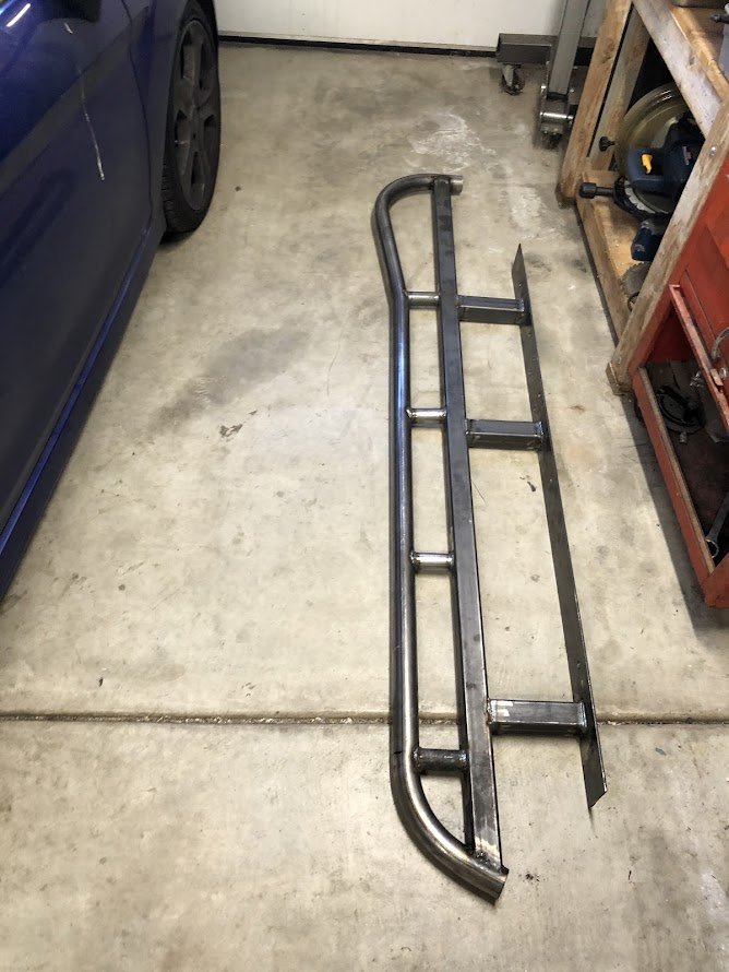

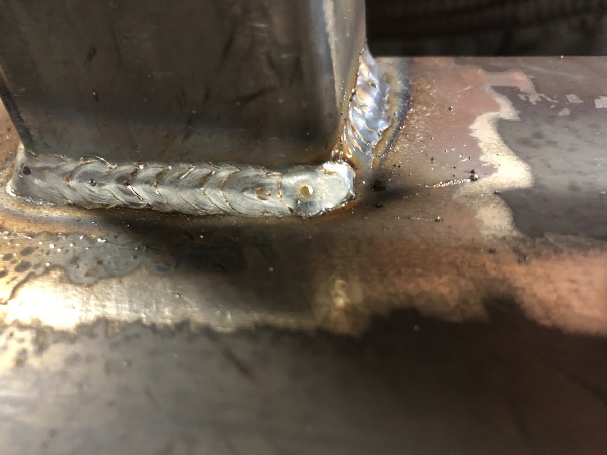

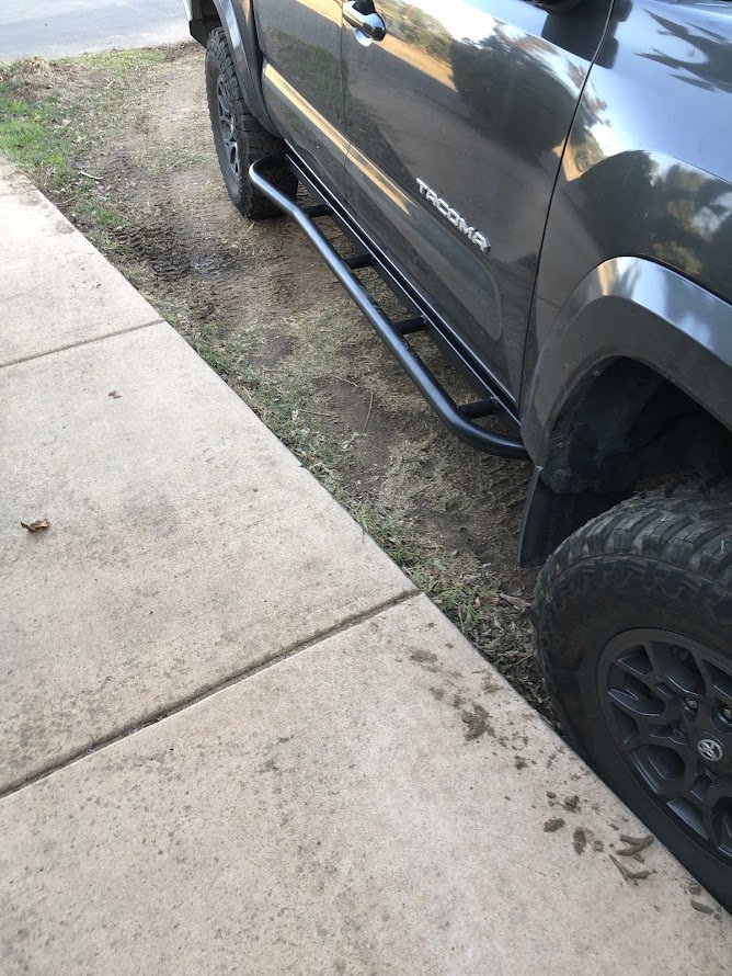

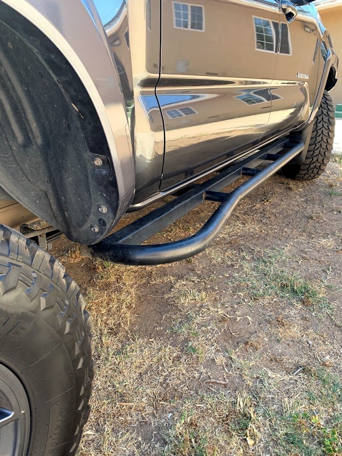

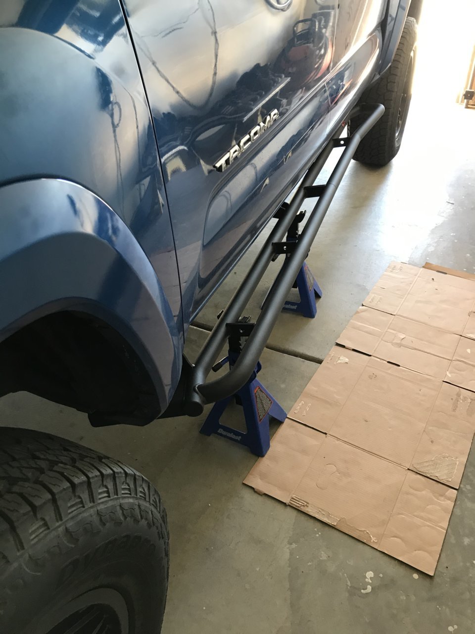

    yeah. When i made my own sliders i was going to go for 0.095" wall x 2.0" tube. but the cheap ass mild steel 2.0x0.120 was way cheaper so i went with them instead. I hate how small the 1.75" sliders look (from most places) so built my own 2" ones with the bends and shape i wanted:
