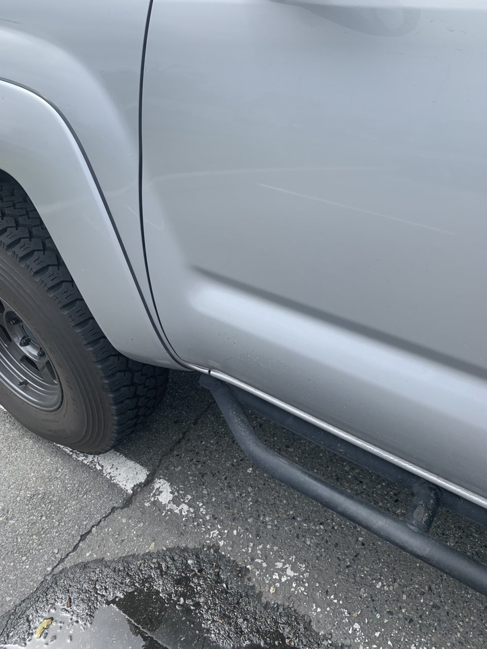

    AB1FFB95-5440-45D6-9F53-BE8A871B15F3.jpgSomething like this will protect more but seeing where the damage occurred on your truck, maybe it wouldn’t have helped in that incident.

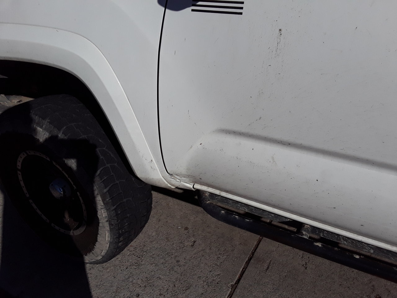

    Those sliders seem to stop pretty short of the wheel well.
