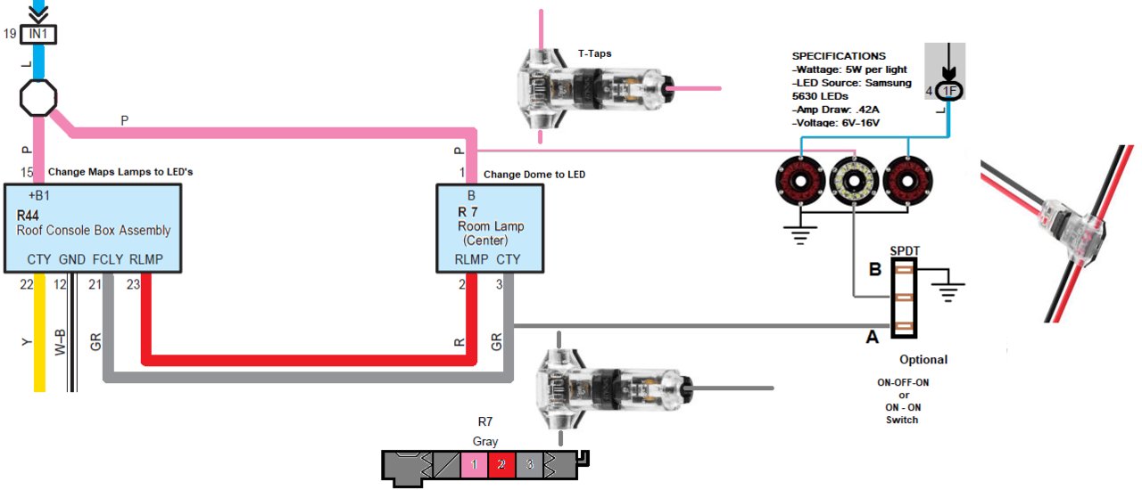

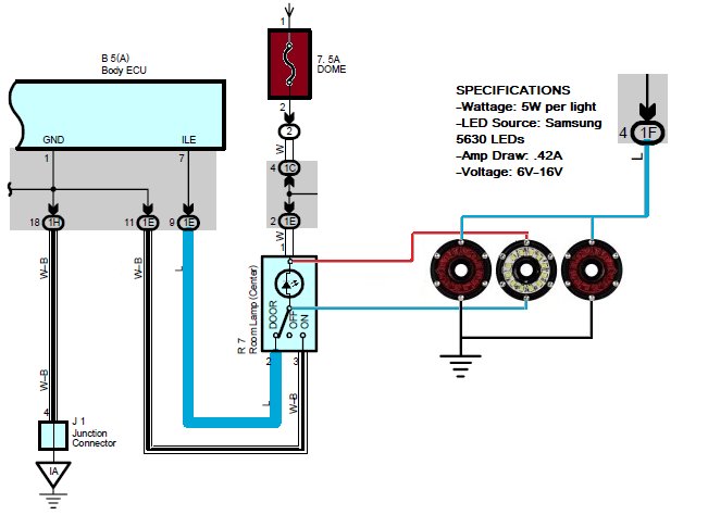

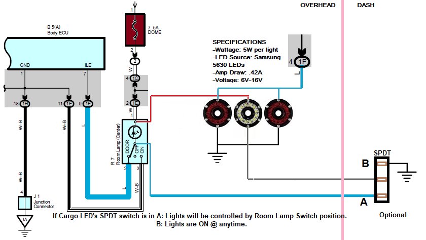

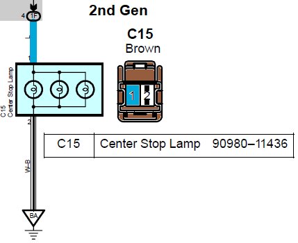

    For those without the cargo light, it would be an easy one power wire run. Ground is shared.

    2nd Gen related

    This is a great idea! When I added cargo lights to my access cab I just tapped off the dome lights so it was really easy to wire up.

    @kmorgan3 could provide the required T harness.

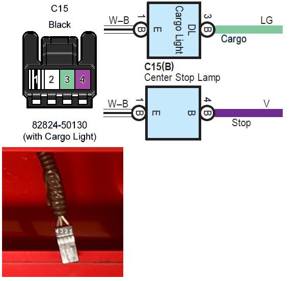

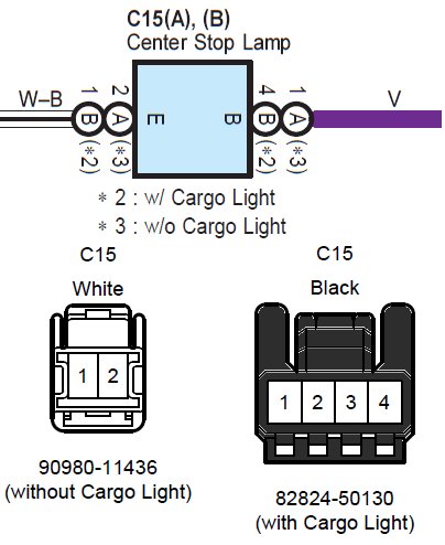

    I've thought about how everyone is wiring these and the easiest to start would be have the wired enough so you just use your male plug on the oem brake light, put in your cyclones and it's ready to go.

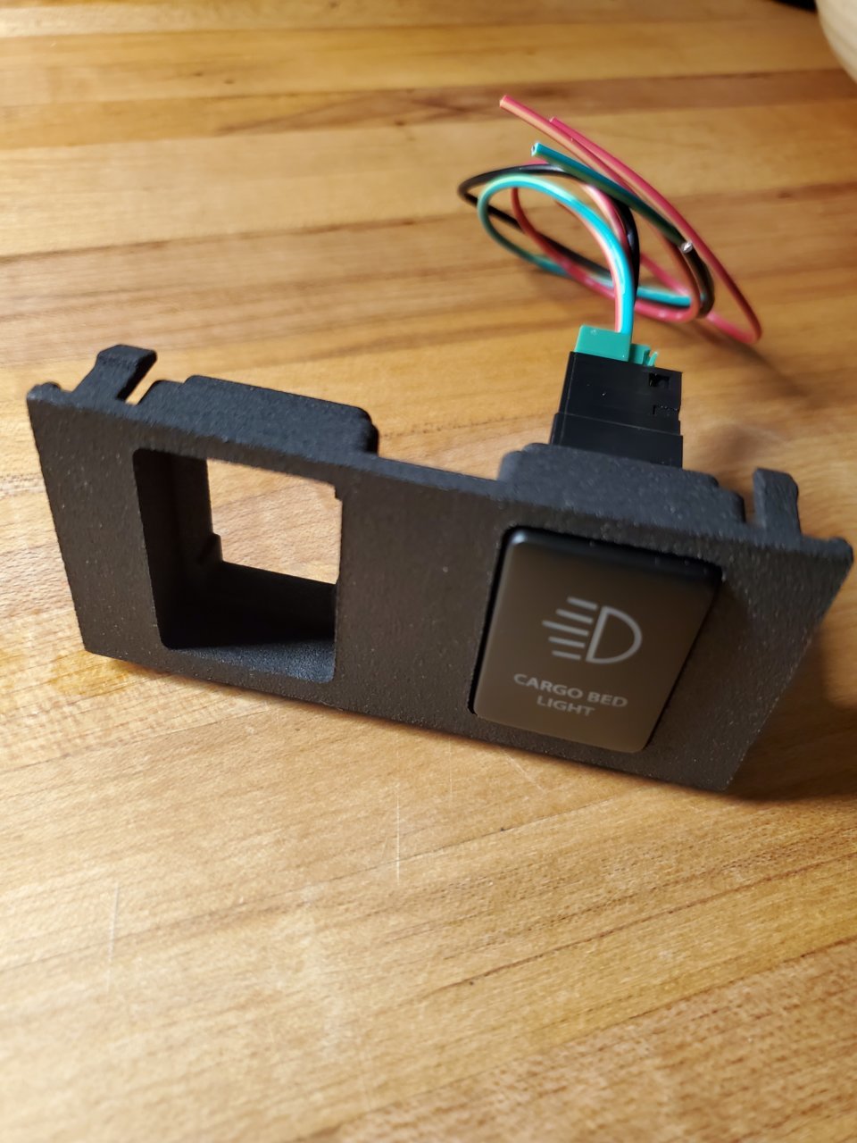

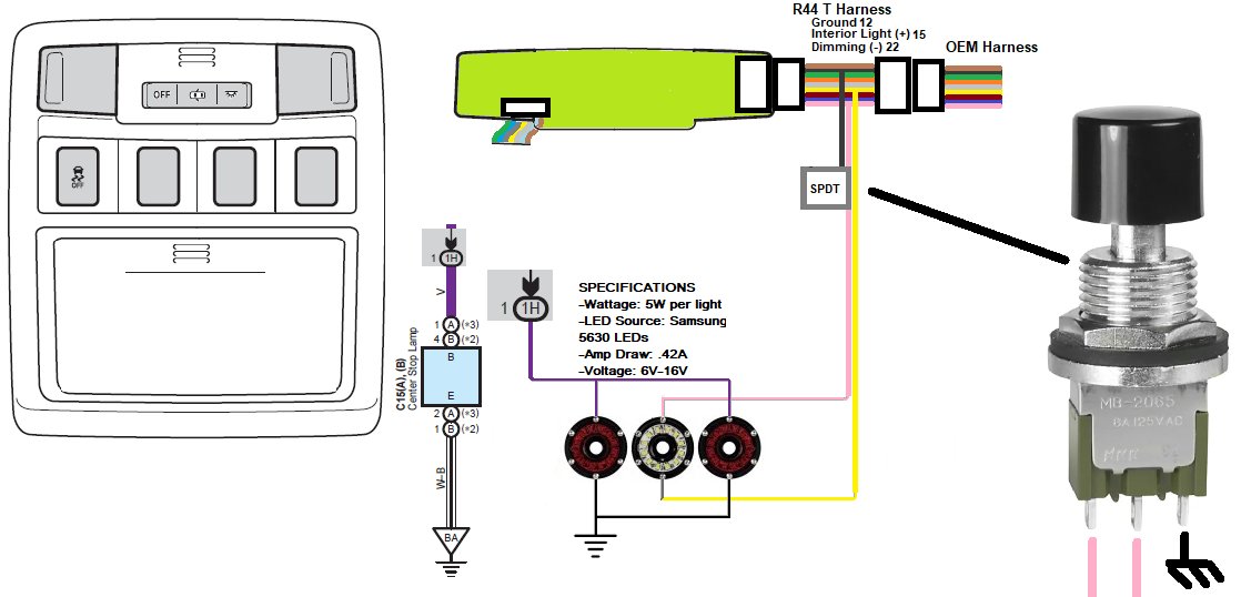

    Thanks caribe, you've been a great help with the schematics. I just got the shapeways two plug for the overhead panel and a switch to do the cargo light the same time as the brake light.

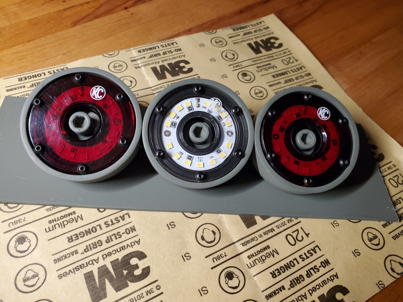

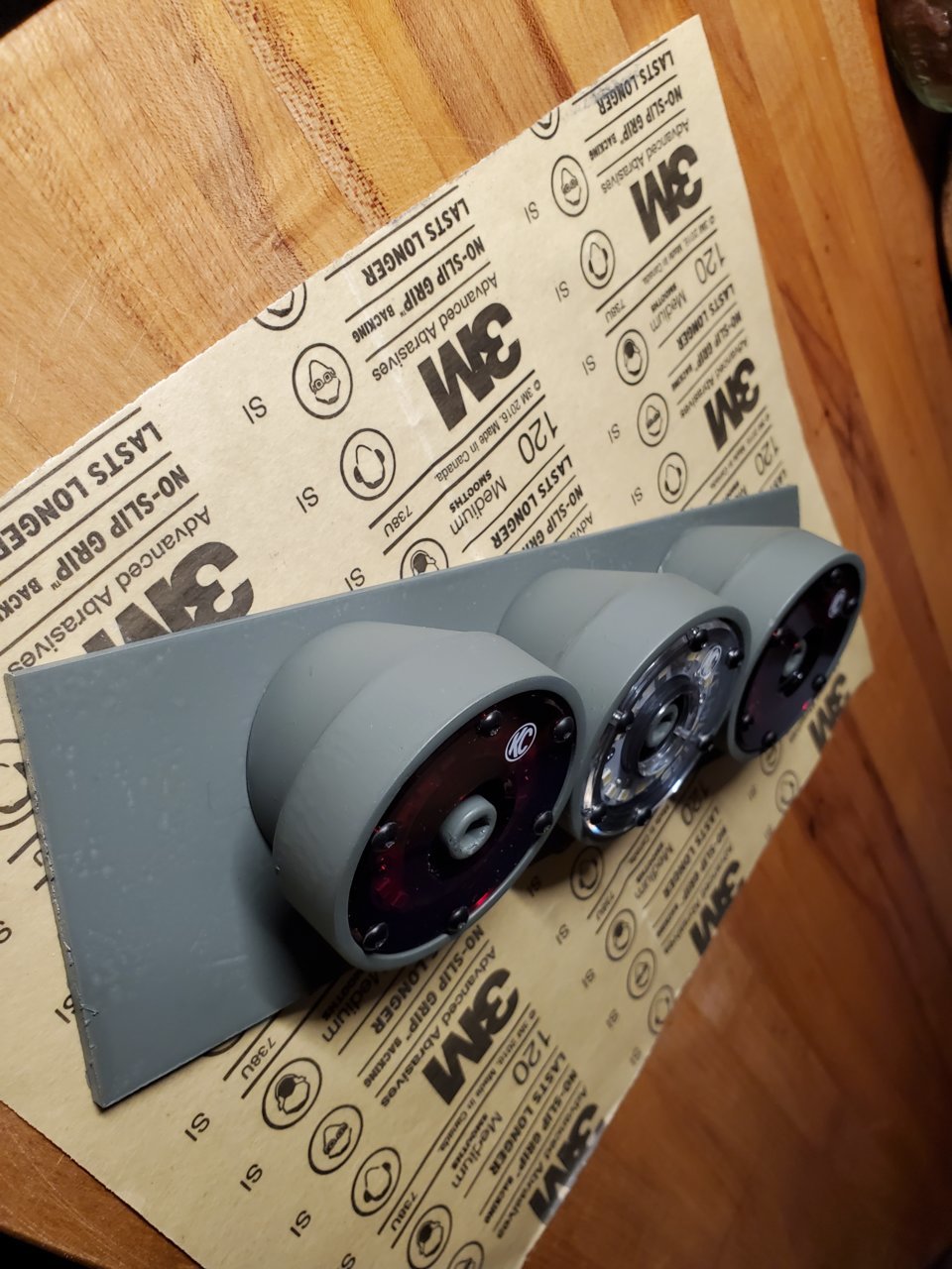

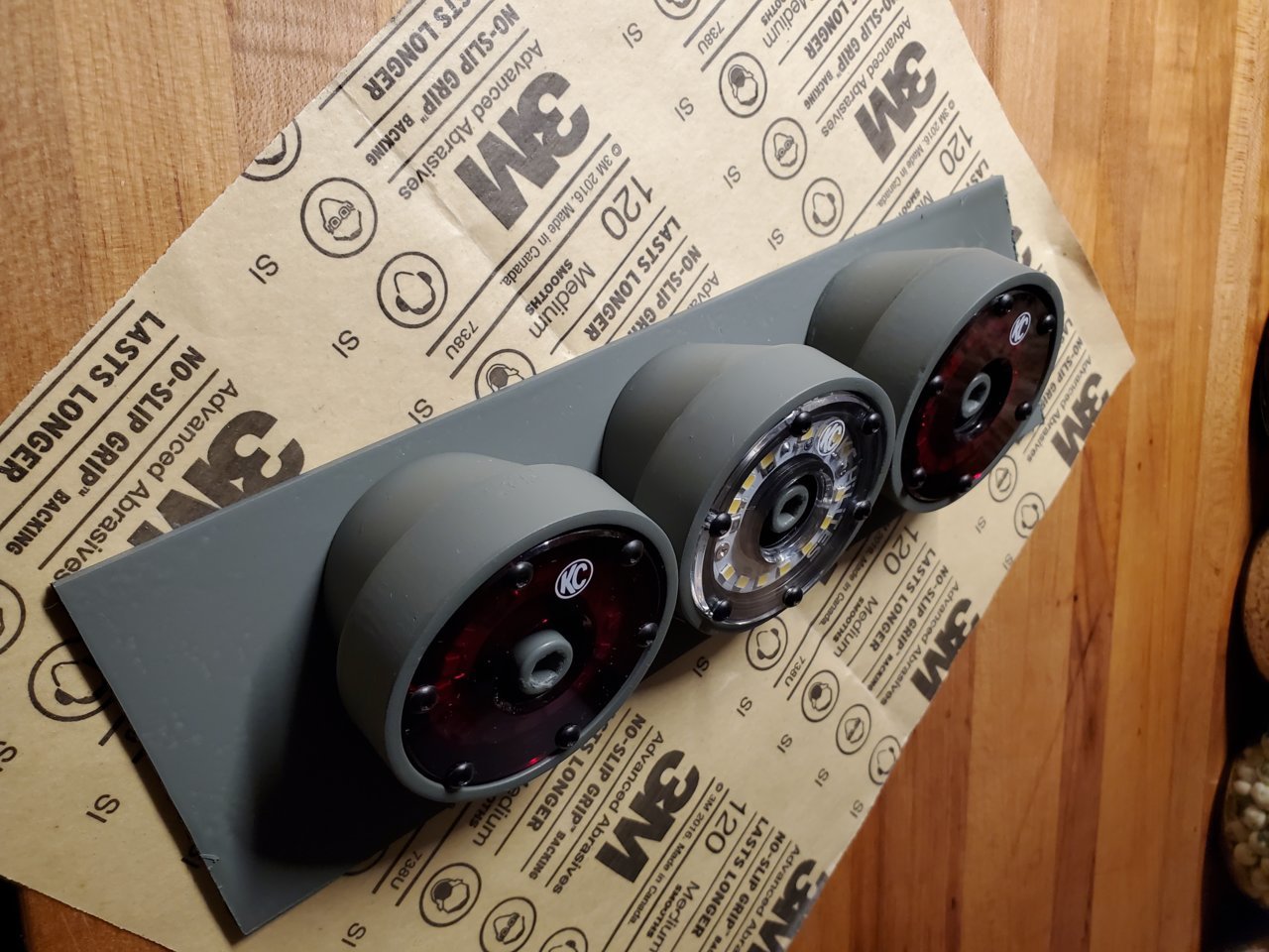

    Update, almost had this on the truck today, but the flat plates were not coming out good with the plasma cutter on compressed air. I'll cut them tomorrow on the band saw and form them to the gaskets.
    These are primered, all gray will be semi gloss black. They'll sit about 1.75" off the back of the cab at the furthest point. Hope to have this one done tomorrow for pics.
