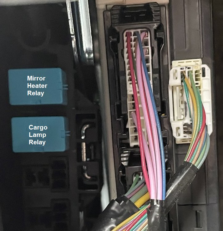

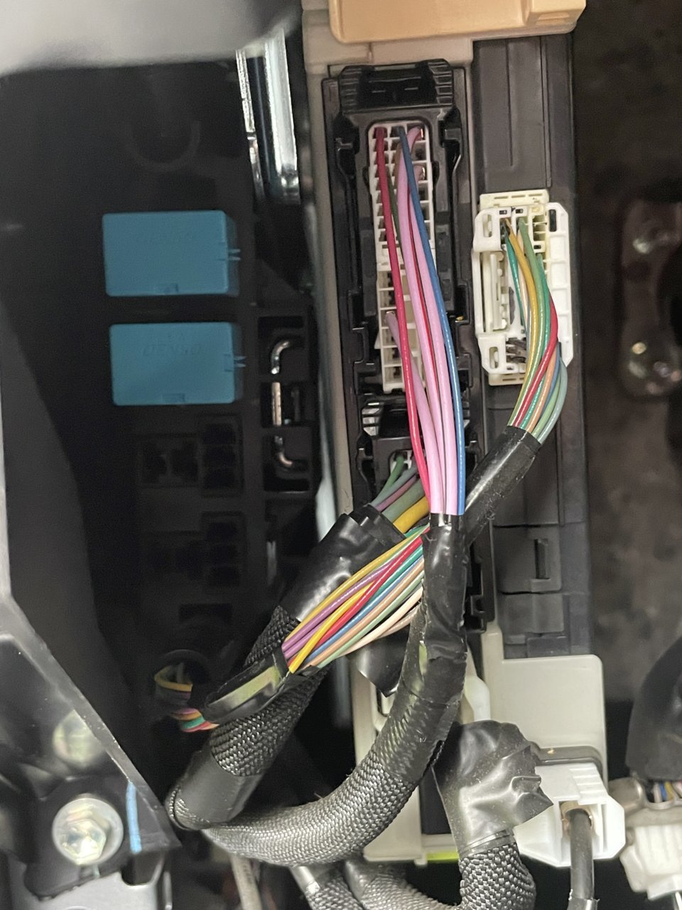

    So I’m still searching for the way to have both 12V outlets in my truck remain hot after I turn my truck off. Mine is a 2017 Tacoma SR5 ATM 2WD.

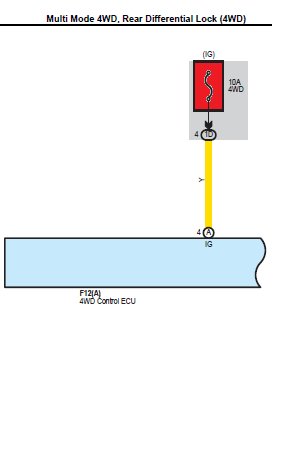

    I took off the panels below the steering wheel, and located a couple of relays that I couldn’t figure out what they went to. I looked in the wiring diagram book and I’m such a novice that most of it made no sense to me. Also, why would I have a 4WD fuse in the block that’s in the cab?
    Here’s a photo just in case someone knows what these are and might could direct me how to get always hot on both power supplies! Appreciate you in advance.BF612036-367B-4554-AFA8-3A2B1F970EEE.jpg

    Pull it, see if you get a CEL.:burp:
    Since you have a 2WD, it's just taking up space (spare)
    But on a 4WD:

    Thanks guys!
    Couple things. My mirrors aren’t heated, what’s a CEL and do you know how I can get an always hot power outlet?

    Are you certain? this is missing on you center lower dash area?:
