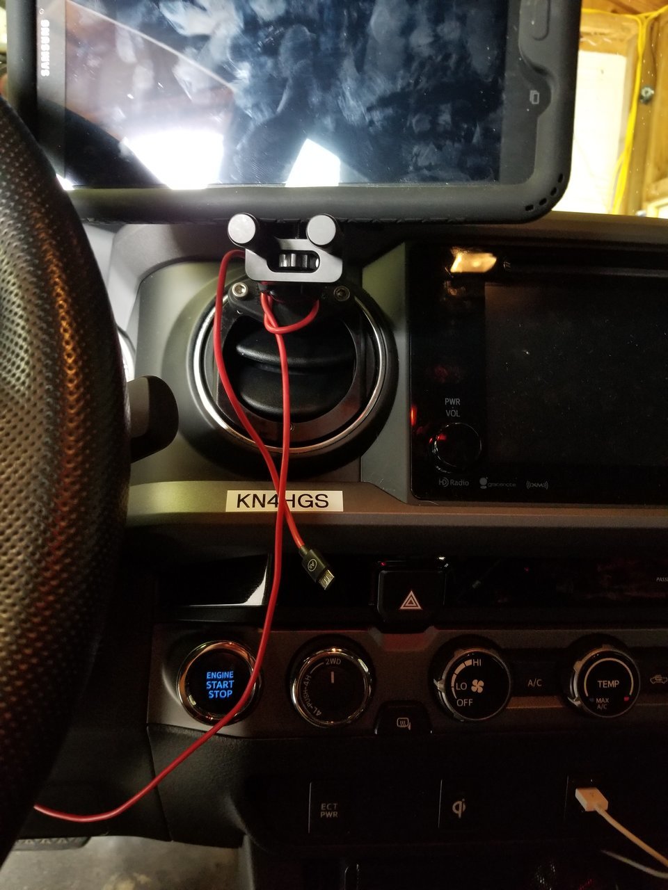

    I hate cords hanging from the dash. I have no problem ripping my interior out and drilling holes in plastic to hide cords and wires. Like most everyone else I'm aggravated that Toyota refuses to provide a constant source for 12v when the truck is not on. Today I finally got around to installing the first of three 12v usb constant on outlets. This one is for charging my phone and tablet.
    My phone has ridden in this spot since the day I bought the truck. It just seemed like the natural place to put it.20171108_124015.jpg

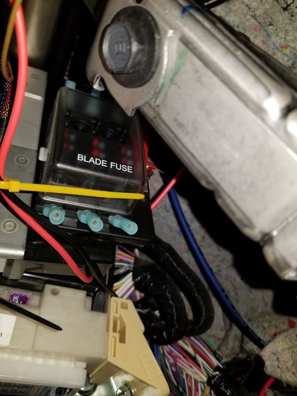

    6 circuit fuse block. Under left side of dash.

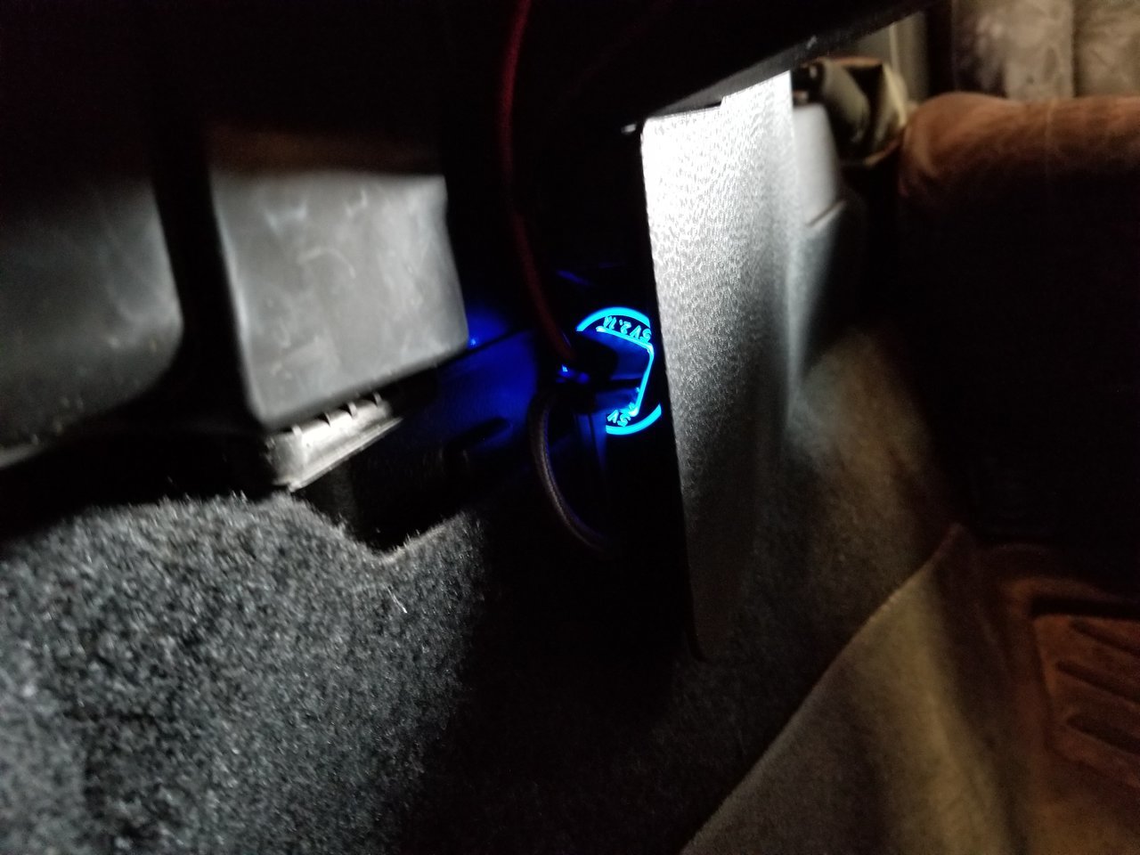

    12v 5A usb stuck back behind right drivers center console forward end

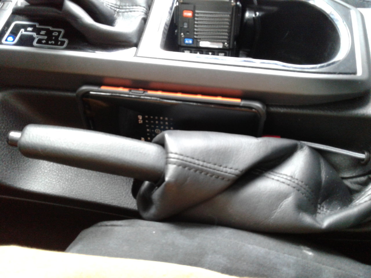

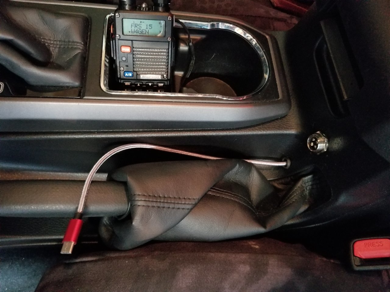

    Hole drilled in aft portion of E brake to area to facilitate phone charging cord
    The tablet cable is ran through the steering column part of the dash. Not sure if this will be permanent.
