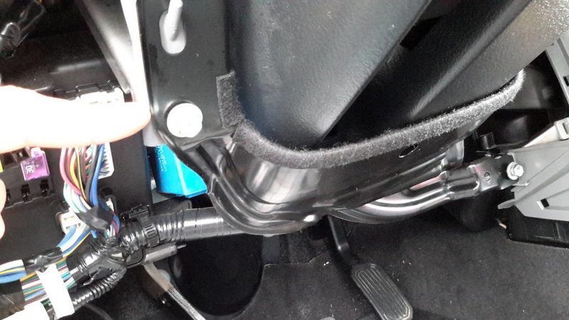

    this is what it will look like when you remove the panel below the steering wheel:
    See the little 30 AMP purple fuse on the left of the picture below?
    The relays are behind that fuse panel
    Those are the best pics I currently have from a different mod I did on my 2013 Taco.
    Ill try and get better pics of this specific mod hopefully this weekend.

    So I'm trying to make sure I can do this right once I get to the relay. Will it just pop out or will I have to do something else

    just pop it out.

    Thanks the pic looks like stuff has to be removed to get it out

    Yeah, No, too much work, hahaha! I tried to reach up behind that fuse panel, and I can feel the three relays, just as you described. I just can't get my chubby little booger hooks around the relay to pull it. I definitely need power supply with ignition off, though, especially for camping and hunting. I will try something straight off the battery with a battery tender connection and a wire that can reach out through the grill for these occasions. That way I can wire an underhood work light to it with the same connector and even run a tender on it in freezing weather. And wind up about 20 feet of good wire and stow in under the hood. Thanks for the ideas!

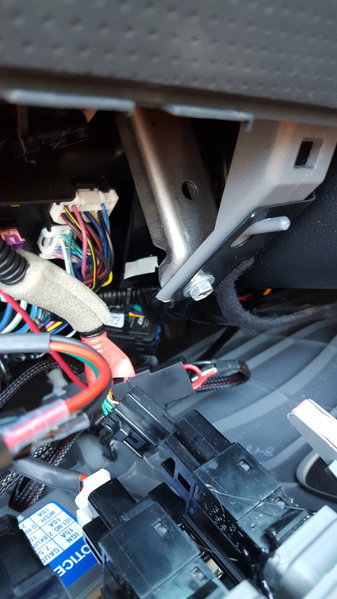

    So here's a pic of mine @ramonortiz55 I have no blue relay in sight of what you picture. Just took all that apart for nothing

    its behind that fuse panel, the relay wont be in sight

    rickhead, were you able to get better pics than i did?.. i need to get a better write up together for this..

    That is way out of my caliber, fuck thought it was the blue thing you were pointing to. Oh well I'll just give it to a member if they want it. Not worth all that headache to just be able to charge a phone while camping overnight. It took me this long to just work up the courage to take all this shit apart, that's why I thought it was the blue relay you were pointing to
