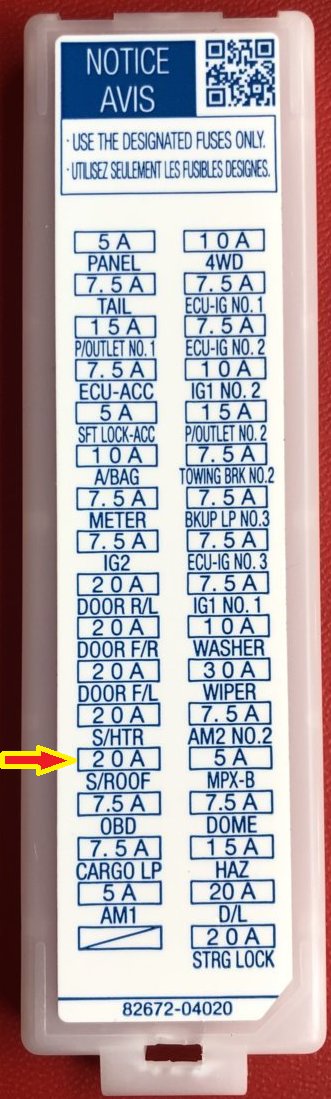

    If your Taco has no sliding roof, the fuse to that circuit is empty and is an always ON one.

    I’d like to have a constant power on for the power outlet in the center console, (one at the bottom of it). Think it be safe to connect that sunroof fuse to it? I don’t have a sunroof. Thanks.

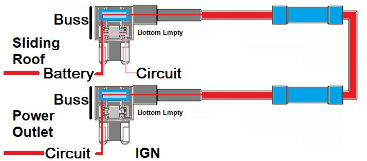

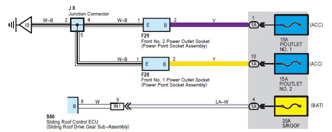

    @monoman, you could identify the circuit side of the power outlet.
    I know the Battery side on the sliding roof fuse is the pin on the outer side.
    The circuit side of the roof sliding fuse is the inner side on the fuse panel.
    You could place 2 add-a-fuse on each circuit. Then leave the bottom fuse slot on the add-a-fuse empty. Join the add-a-fuse's wire, thus bridging the battery circuit to the power outlet circuit. But you must identify the circuit side of the Power Outlet, else you'll send juice to the IGN circuit, not good at all.

    Ok. Gotcha. I realize that you have to remember that it's always on. I mainly use the outlet for charging my phone so not much power is used. So with my last Tacoma, (first gen) I had an outlet that I switched to always on. I did the constant on mod where you remove the relay, put in a jumper wire where the relay is that's in the main fuse box under the hood. I'm gonna put in an external fuse box anyways but I thought I'd try to use a circuit that's already in the truck for constant on. Thanks for the info.:thumbsup:

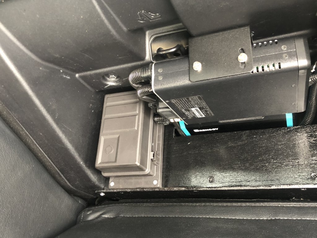

    There is non-keyed power in the trailer brake connector behind the left kick panel.
    Be sure to add a manual switch in line just in case you are parked long term.

    I just updated that with a connector harness that @daveeasa made for me and added an inline switch as the USB outlets all seem to have an LED of some sort.
    Previously, I just had a fork spade stuck in there.

    I had a plug and play harness to the trailer brake pigtail for my always on outlet. I had to remove it when I needed to add a trailer brake controller. Now I use the blank/empty spot under the AM1 fuse and an add a fuse.

    We're still a bit away from getting a TT. When that happens, it should be easy to move it over as the harness runs right past the block now. I even have the @MESO cover since the stocker was so craptastic.
