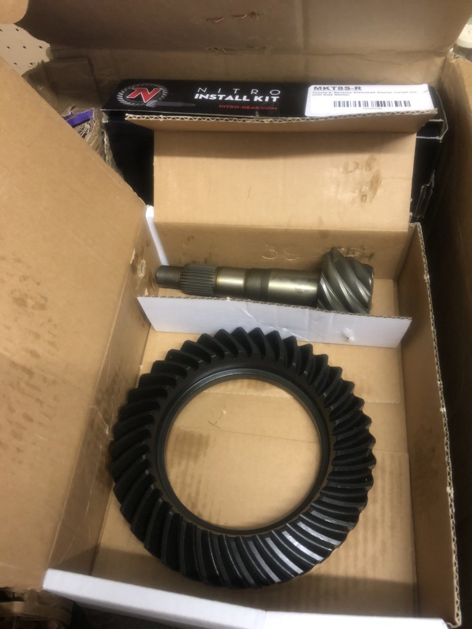

    Got the 4.88 regear done. Ordered thru SDHQ (opted for non REM) and installed locally. Didn’t drive much so far but in town driving feels better. Shifts really quick!, but, higher RPM’s nonetheless and seems to stay in a much healthier rpm band that feels much more appropriate.
    I’ll continue the update as the break in procedure continues, and my impressions

    Gears are performing awesome. Have a few trips and a tad over 1000 miles on them now. Off road and loaded for camping on hills is amazing. Best mod by far.

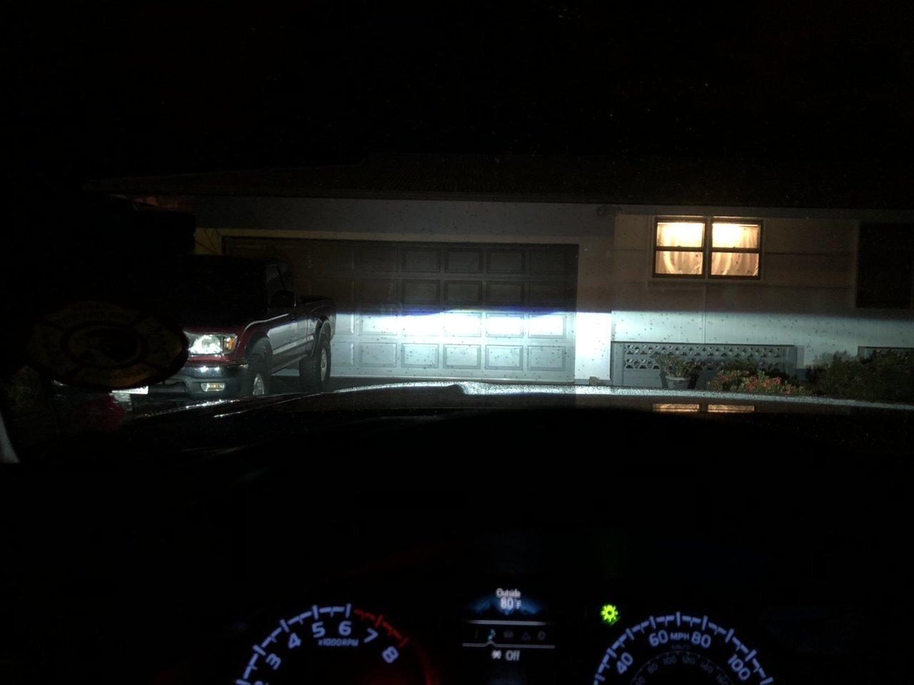

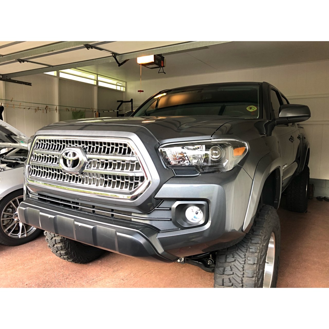

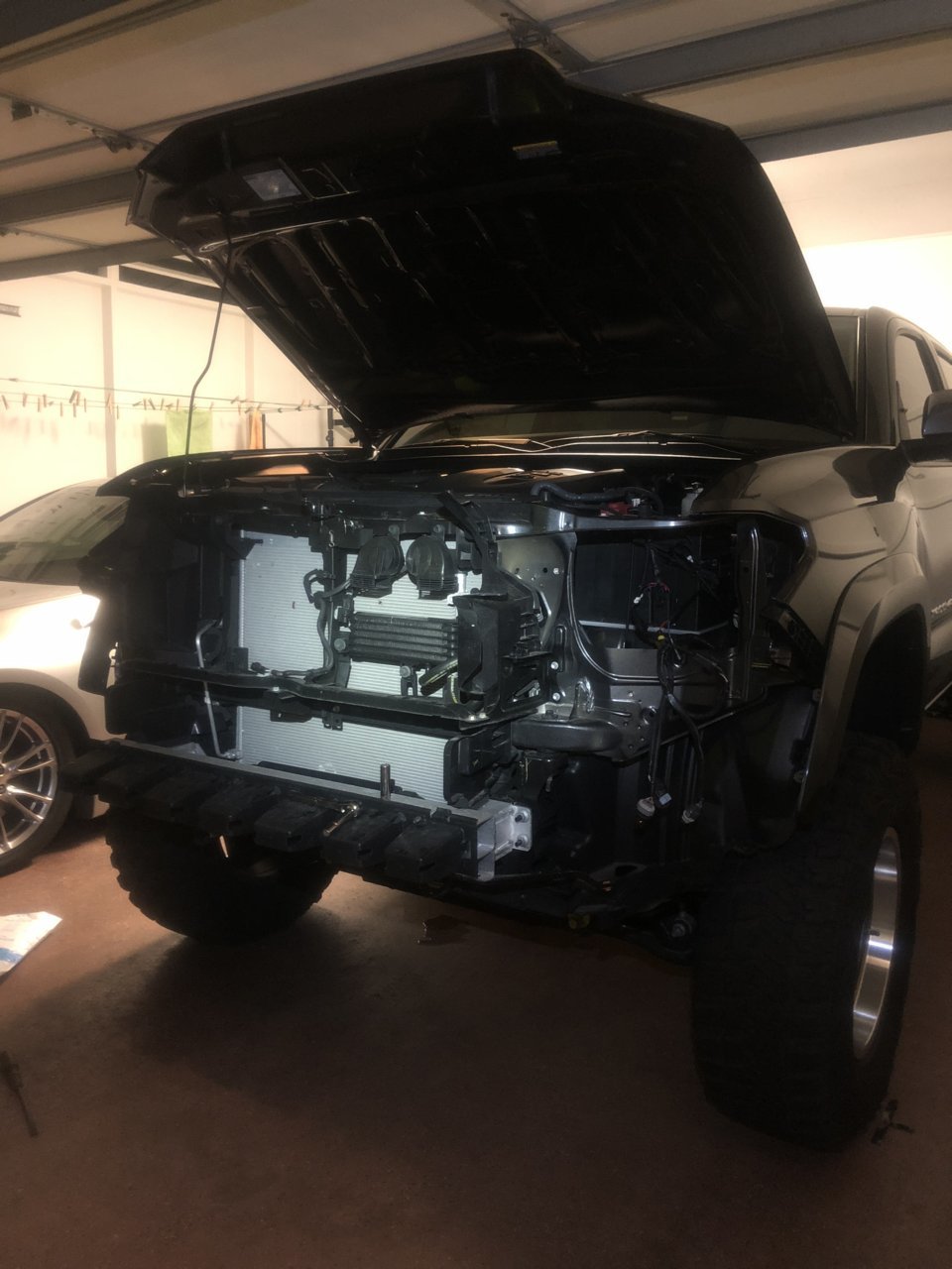

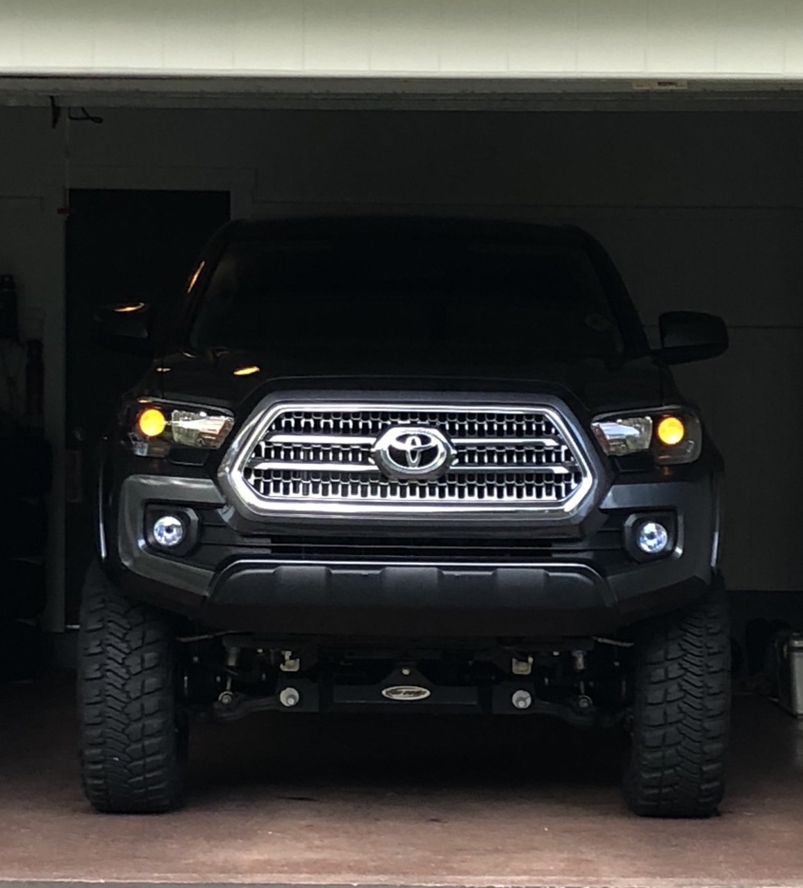

    I’ve also completed another task.

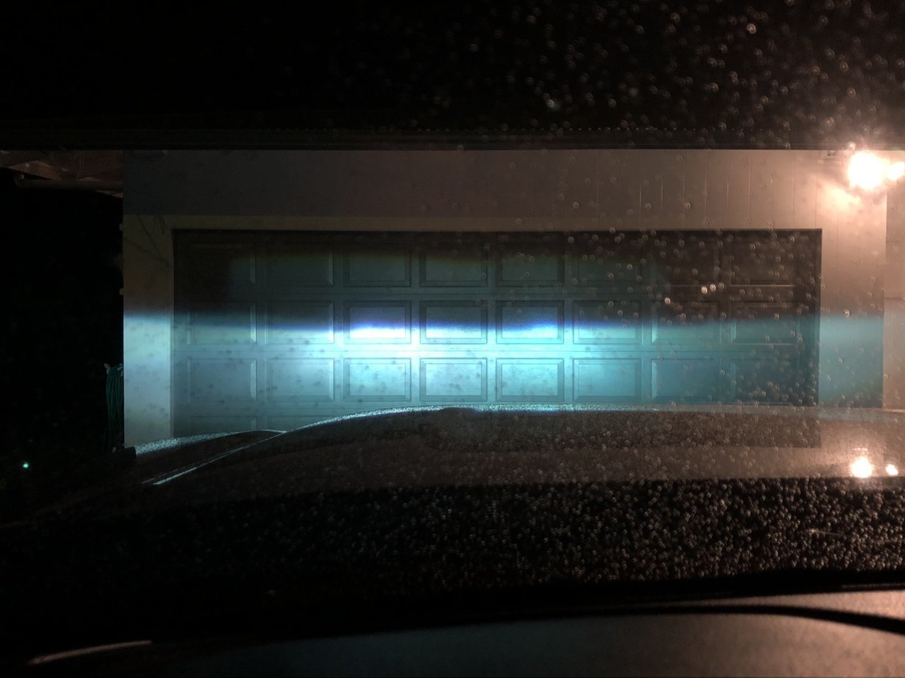

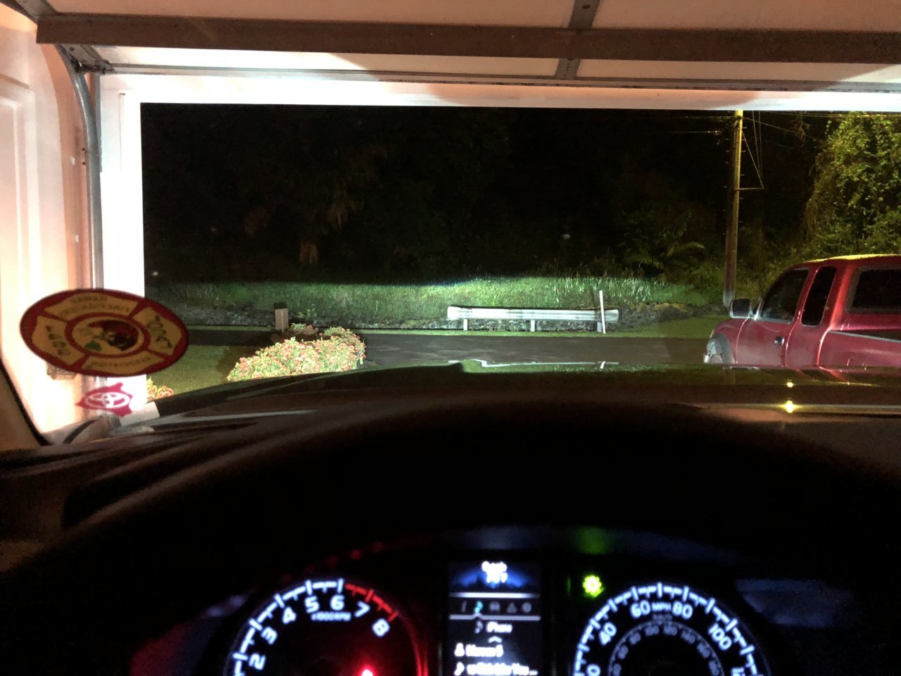

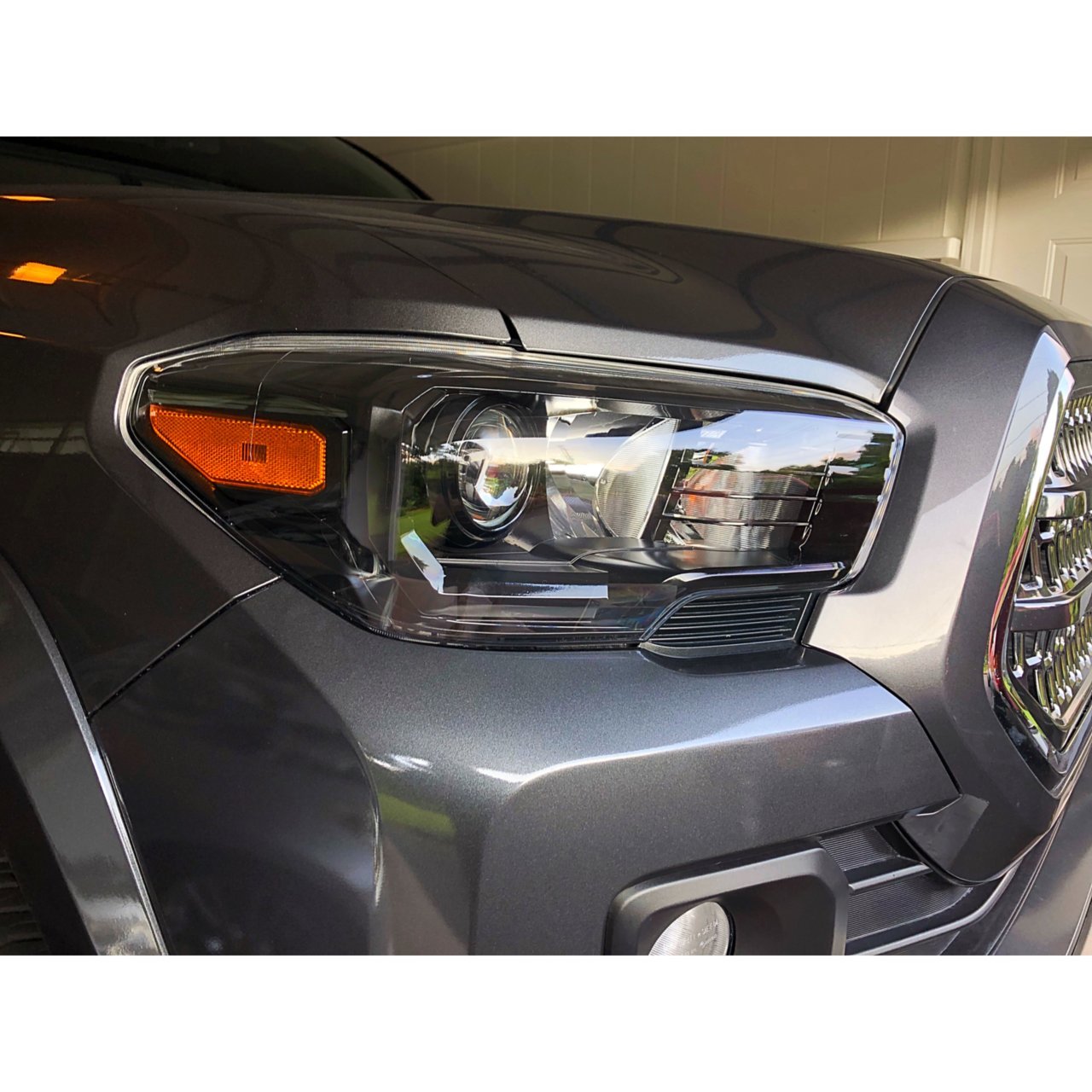

    RX350 w/ STI-R lenses/tuned projector retrofit, BLHM, and amber demon eyes. Also added a sport grille for now till I finish up my custom one
    First pic is the stock projectors and cut off. I was running aftermarket bulbs so it’s a tad blue in the picture.
    4x4_Taco likes this.

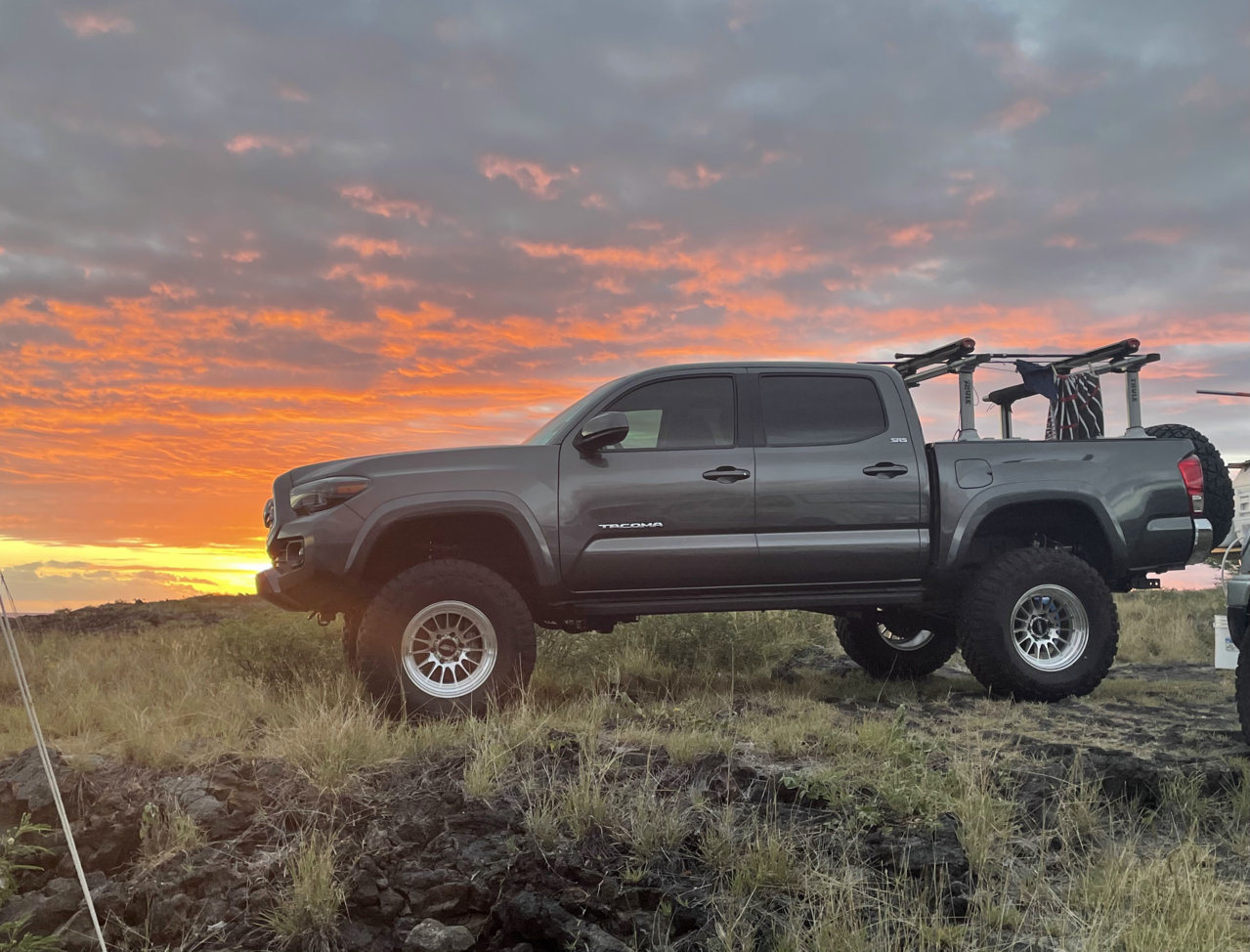

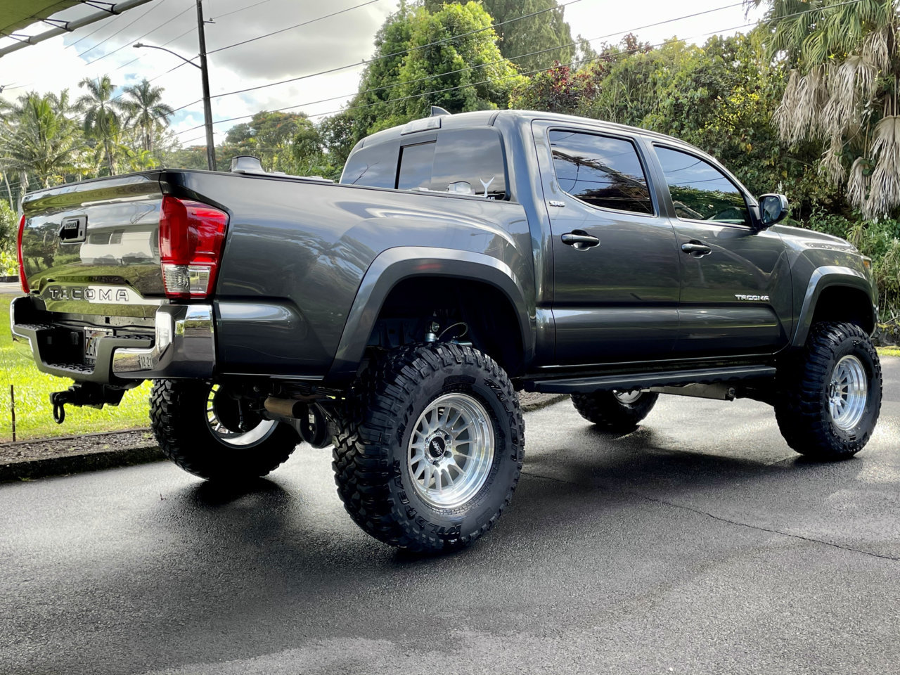

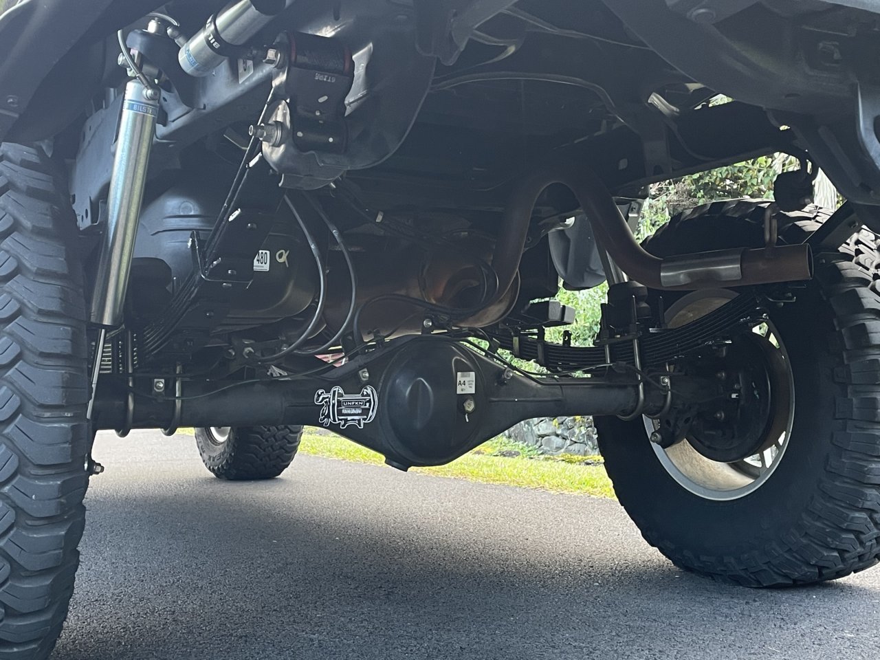

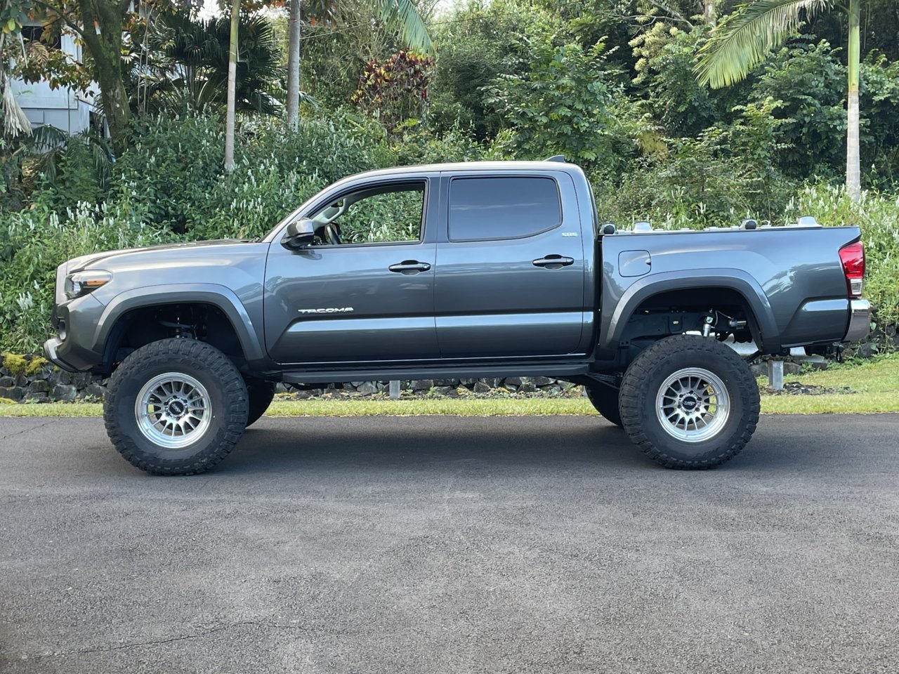

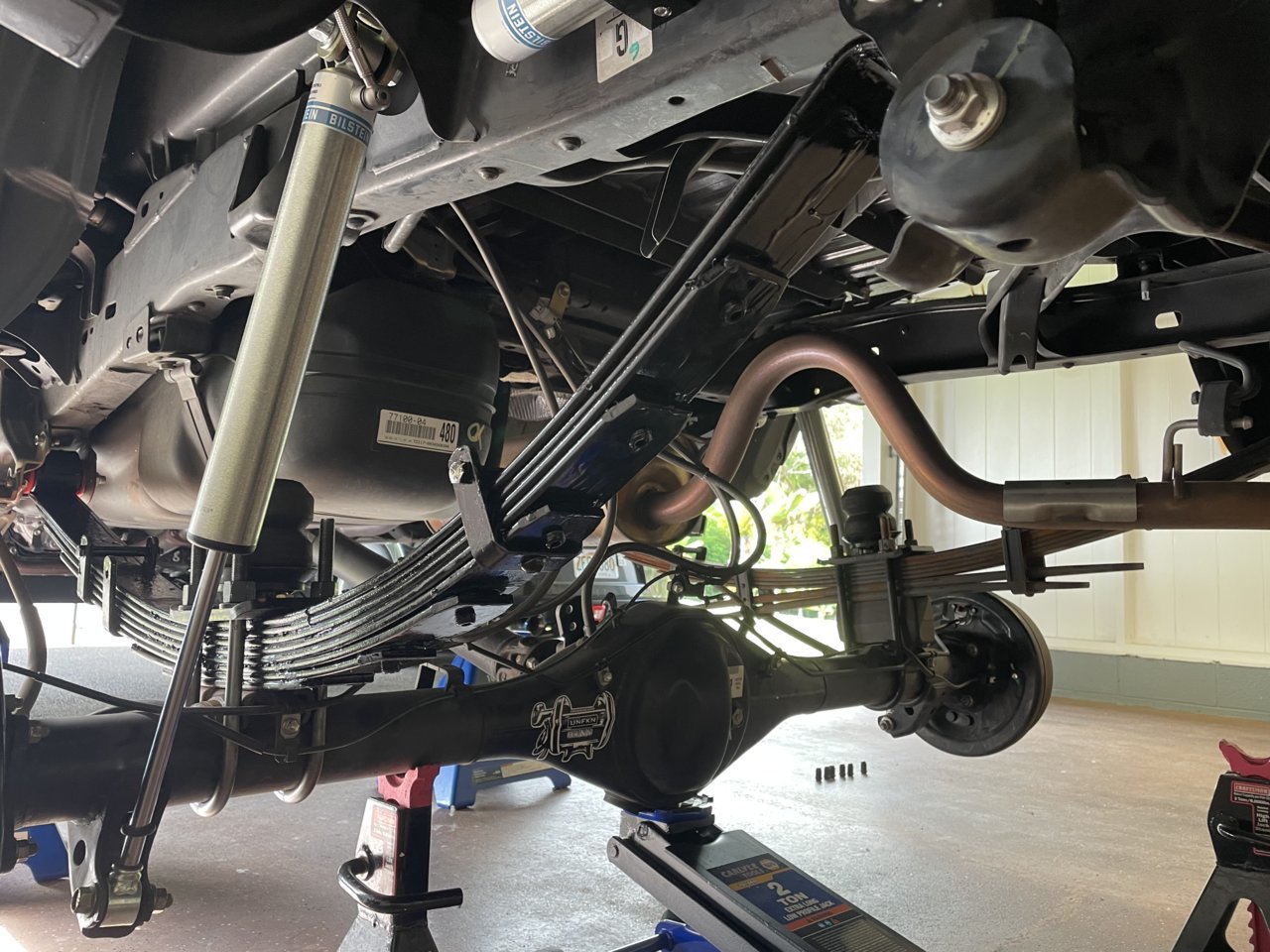

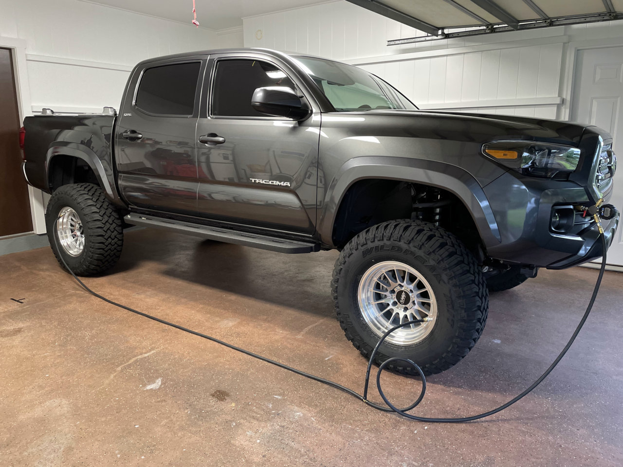

    Some updated shots
    Since I've been gone for so long, its going to take me a while to update the first page of this thread.
    Major changes were 35s, new Summit Offroad 17x9 rims, ARB onboard air, Rigd Tire Carrier and a full size spare, Bilstein 5160s 28" extended for the rear, u bolt flip, timbren bumps-stops, and a u-bolt flip kit.
    As of now, the truck has 17,4xx miles. I've already tired out the Dakar HD leaf packs...I'm starting to sag just with the tire carrier and spare loaded. To remedy this, an order has been placed thru Alcan for 6.5" springs to hold 600 lbs (figure the carrier and spare combo is nearly 180 lbs already). This will also eliminate me needing the block, which I've been wanting to do for some years now.

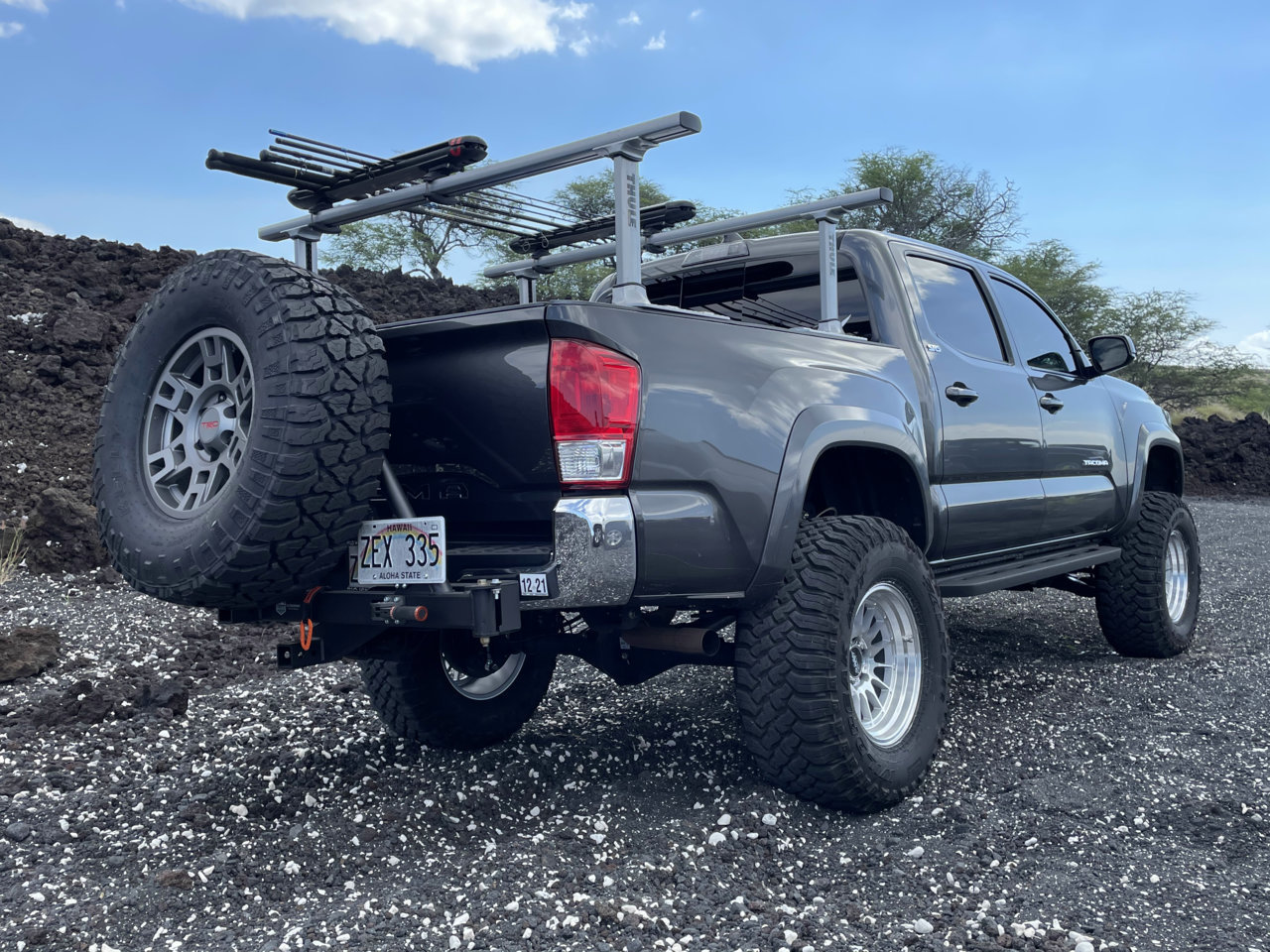

    Pro Comp 6", full length 5100's with OME 888 w/ taco lean spacer, 5160s w/ Alcan custom pack, HS extended brake lines, Summit offroad Dakar 17x9, 315/70/17 Falken Wildpeak MT, Nitro 4.88 regear
    Alcans are in. Quite a bit of rake empty bed, but have to remember, there’s nearly a 200lb load at the very rear when I have my tire carrier/spare 35 on there

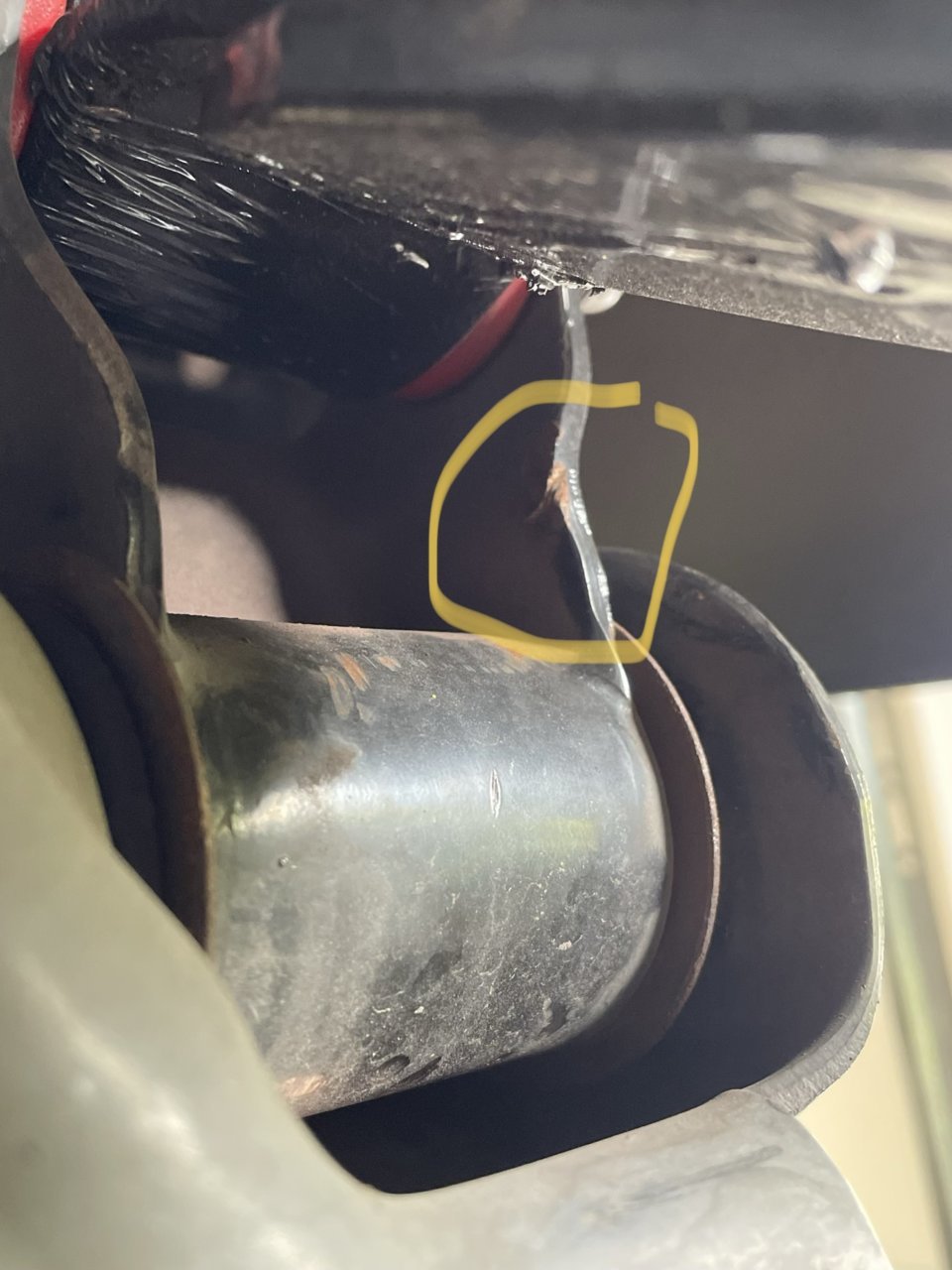

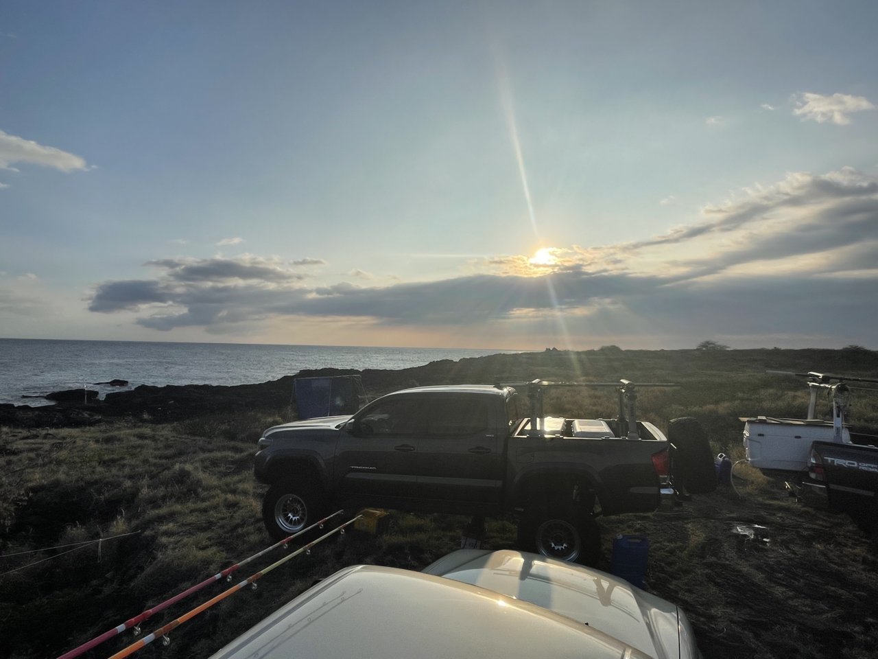

    Broke in the alcans, also caught a few fish
    after the trip, while cleaning the truck I noticed my old Dakar leaf spring setup was contacting my shackles…started to slowly tear into them - so I just ordered some hammer hangers with greasable 3.6” shackles from @ARCHIVE
    i can tell it’s not from my alcans since the Alcan pack has no sign of wear/surface rust
