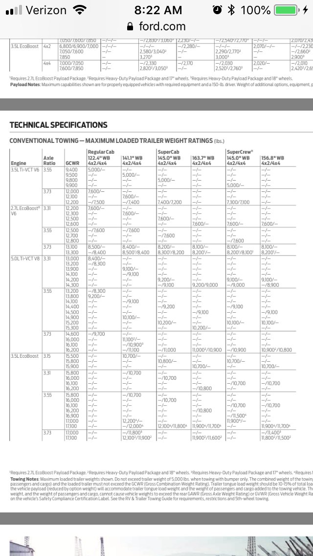

    No such thing. If you have the towing package you have all the coolers. Not sure what year your truck was. The older body style the only model not rated to Atleast 9,400 lbs was the limited. It was 7,400 lbs with the 3.55 gears
    The current body style, all the models are rated for Atleast 10,700 lbs (see below). So perhaps you had the 3.5 non ecoboost?

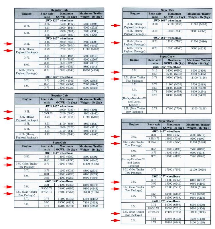

    This is for 2011 MY. My new F-150 is a max tow ecoboost, which falls under the 12k capacity. Granted, when I’m towing something that heavy, I grab the 18 250.

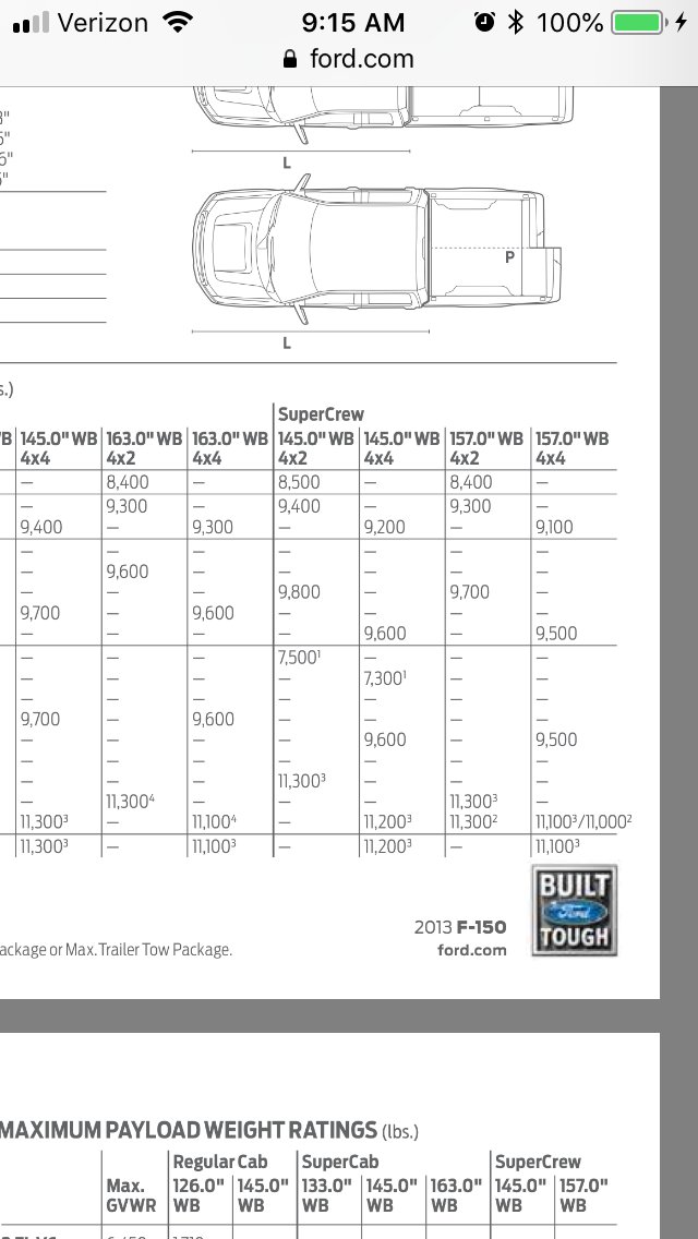

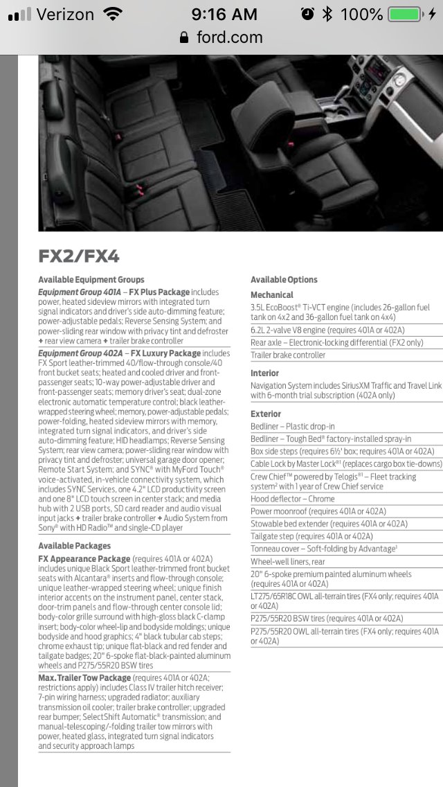

    They are class 4. Class 5 are 2 1/2” opening. The standard hitch is probably just a class 3 then. If it comes with the transcooler than the additional cooler in the tow package would be the oil cooler. I remember some models of the explorers only having to add one of the other, couldn’t remember exactly which. I think they might of had the tranny cooler but needed the oil cooler.
    Just looking at the 2013 fx4 I had. So mine didn’t have the Max tow package because it didn’t have the tow mirrors. But I had the 402A luxury package. So I had the factory brake controller but not sure what class hitch. I thought it was a class 4, maybe not. Looks like they get the higher tow capicity with a bigger radiator and aux trans cooler. Ford has so many options when it comes to their trucks. Anyways my max rated capicity would of been 9600 lbs with the 3.55 gears. Not sure if his truck setup but I still think it would of been higher than what he was claiming. Even if not his taco assuming has the tow package. Without that on his taco it’s only rated around half that weight. So the comparison between the trucks really wouldn’t of been fair. Biggest thing I ever towed was a 18’ heavy duty car hauler trailer loaded with a about 5k worth of landscape blocks. Probably was around 8k loaded. Pulled it like butter. Only thing I towed with my Tacoma was my Snap on tool box home from my old job. Rented a uhaul 5x8’ trailer with a gate. Probably was around 3k lbs. the Tacoma didn’t pull that half as easy as my f150 did with that car hauler and landscape blocks.

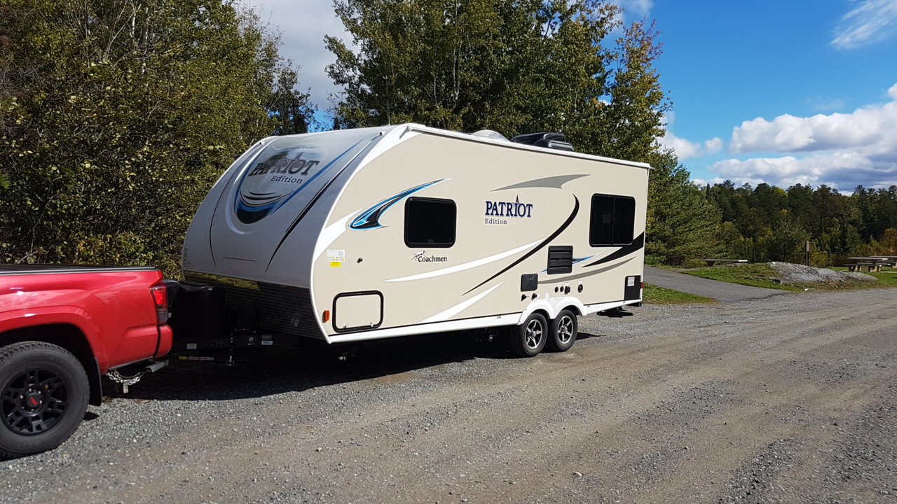

    I don't have a clue why you say that. I've had absolutely no issues. The truck is set up properly with the right hitch and sits perfectly level. I tow @ 65 to 70mph with no handling issues and run the truck in 5th gear with cruise on. MPG averages 13-15 while towing and 21-23 not towing.
