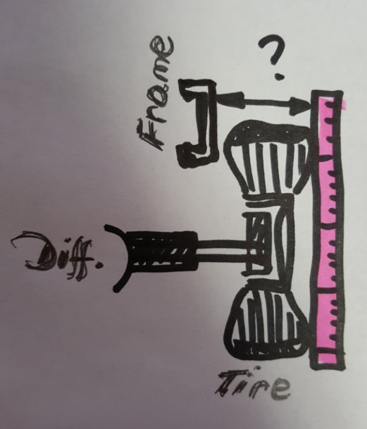

    You're not insane. I went through the same process and took me many months of therapy and electrical shocks till I discovered is NOT the bed (may be in some cases) but the right tire IT DOES STICK OUT about 1/2" from the fender compared to the left one. ALL tacos have the same setup from the factory in order to align the drive shaft to the differential straight with no angles.
    I have changed the leaf springs, rims and tires and still have the same off-set. For the nay-sayers, forget about the bed alignment and measure the distance from the frame to the outside of the tire (using something PINK like a long ruler, a 2X4, broom stick, etc) and compare the measurements.
