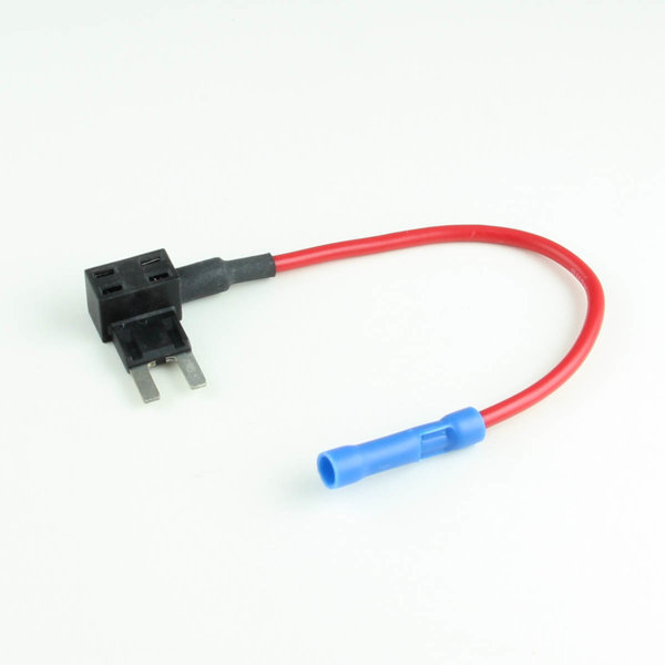

    4. You might be using the term "add-a-fuse" incorrectly. This is an add-a-fuse:
    It "adds" a secondary circuit to a pre existing fused line.

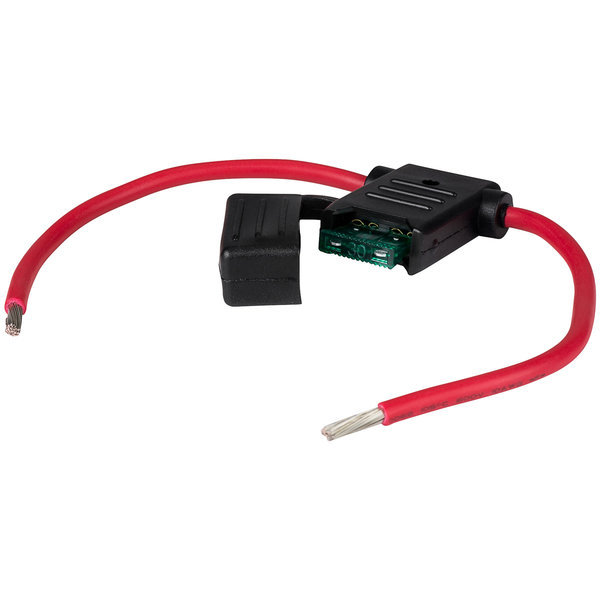

    I think you mean in-line fuse. This is an in-line fuse:
    It places a fuse in line with a circuit you are building. You wont need an in-line fuse to go to the new fuse box you are adding. The box takes the place of the fuse and there is no need to double up. While it wouldn't hurt anything, it's redundant and you're not adding more protection that what is already provided by the fuse in the box.

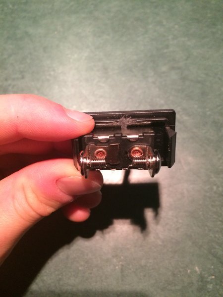

    Question. I found out my switch does not have a ground, and I shouldn't try to ground it...however, it is just a basic switch and not illuminated.
    Can this still be used? How?
