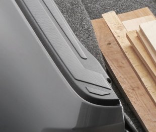

    The difference between the front rail on the 2nd Gen (non-existent) and the gapped, mismatched front rail on the 3rd Gen can certainly create issues. Note that car washing (home or automatic) is about the worst case scenario other than rallying through standing water.
    It really depends where the water is actually coming in at, but it can be sealed up pretty easily.
    The first place to work on with your Taco is the front corners. 5min with some silicone will straighten that out. If water is coming in the sides, between the metal fender and composite bed, then a bit of work can be done under the rail caps.
    Of course, there are tailgate gap seals also.
    Once I got my setup sealed, I installed 3/16in plug buttons in the front drain holes. Mainly for me, it is about dust when wheeling.
