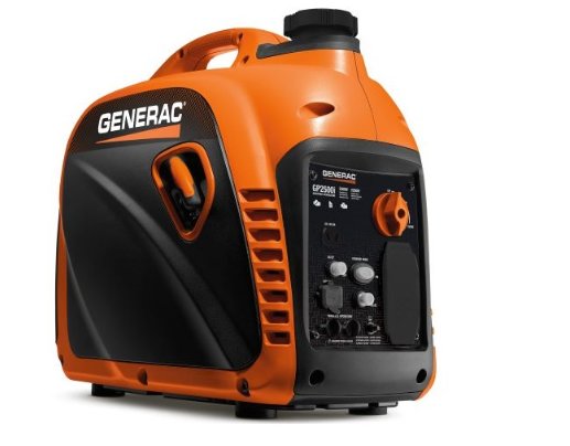

    What the heck are you running that requires a generator that large? Are you running a 4500W+ generator? Generac 2500i weighs 48 pounds and the Honda best of breed EU2200i is 47.4 pounds. What are you powering - or is your weight calc Generator + Fuel and Containers (all-in)?

    Predator 3500
