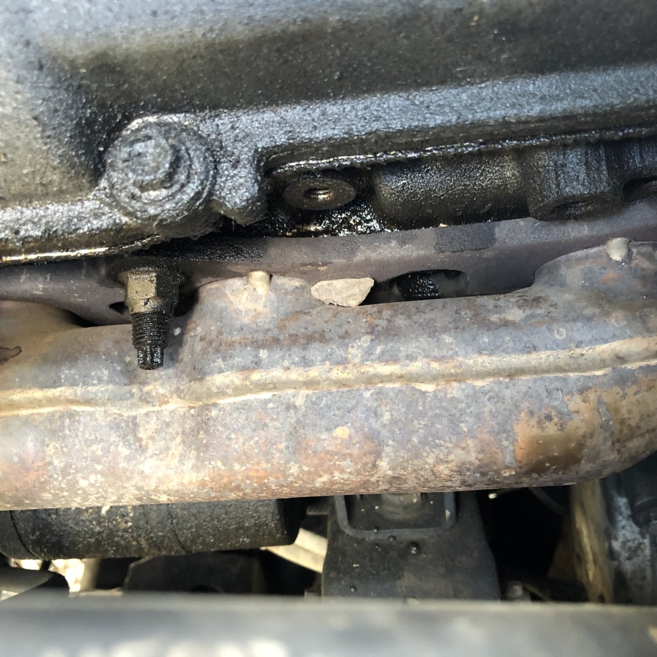

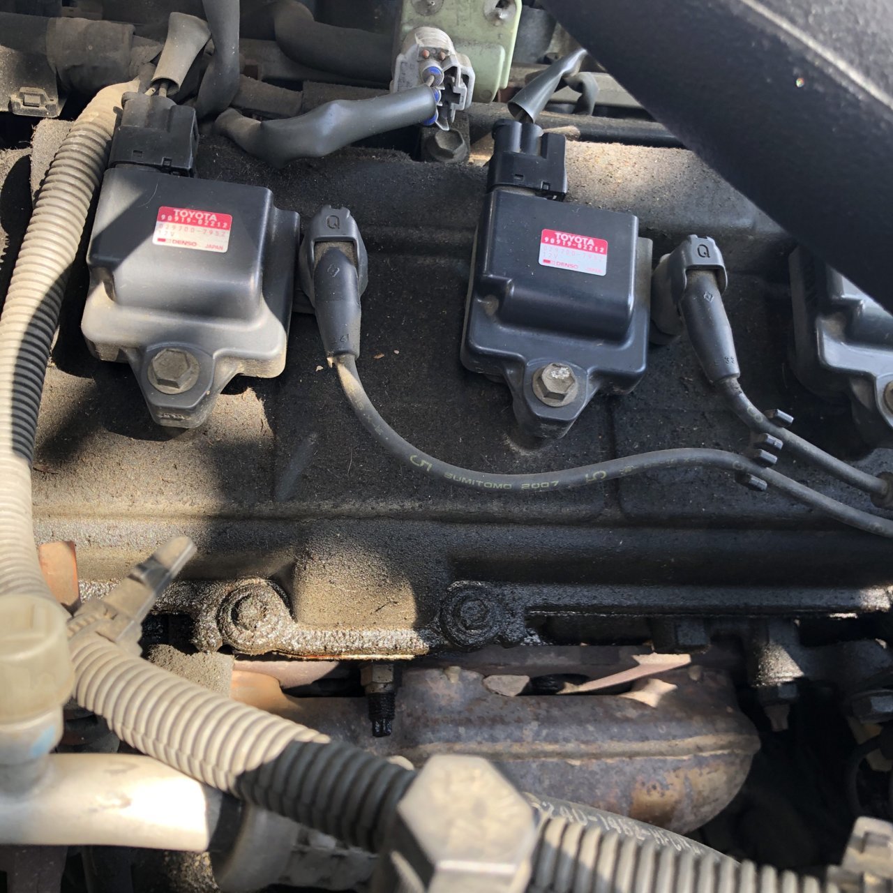

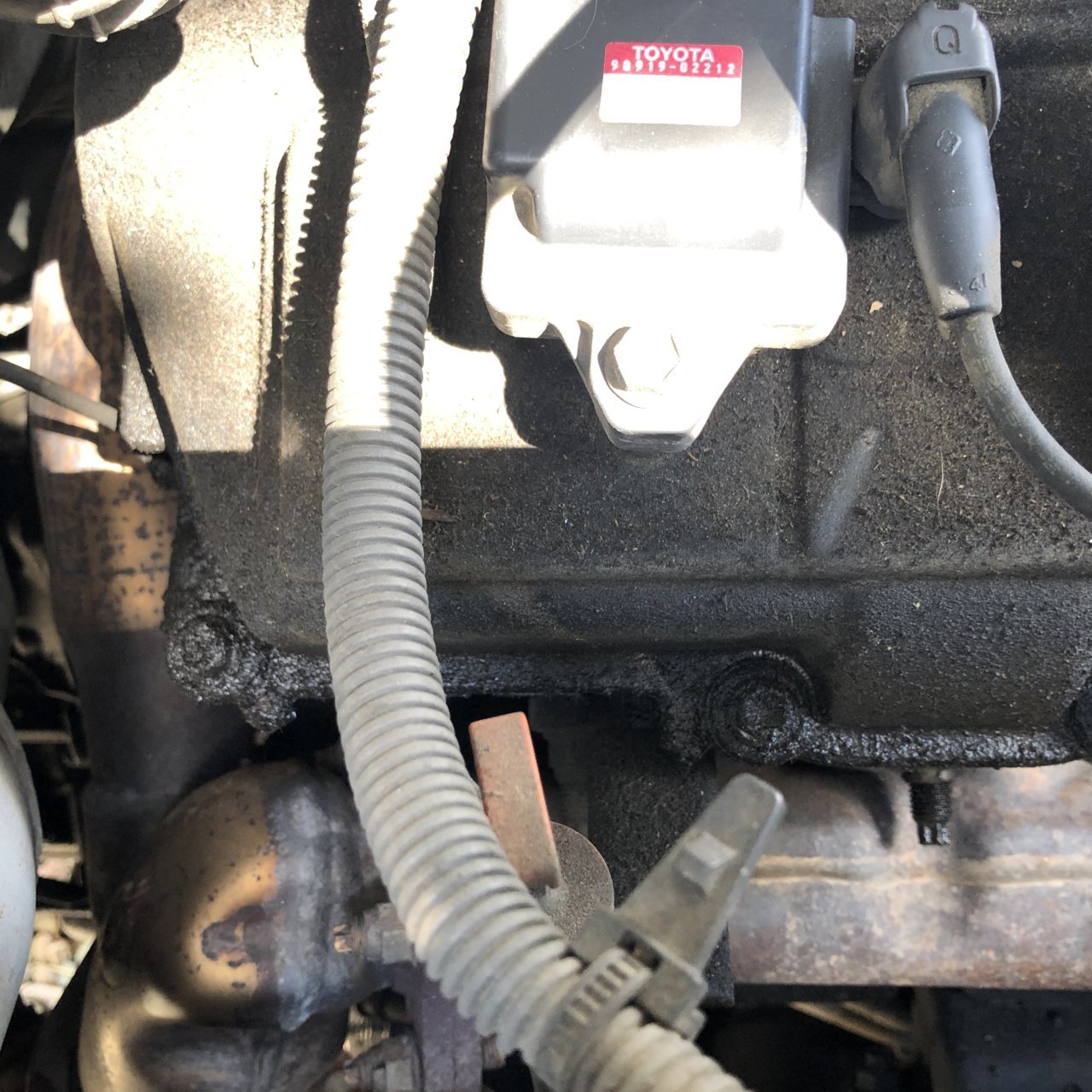

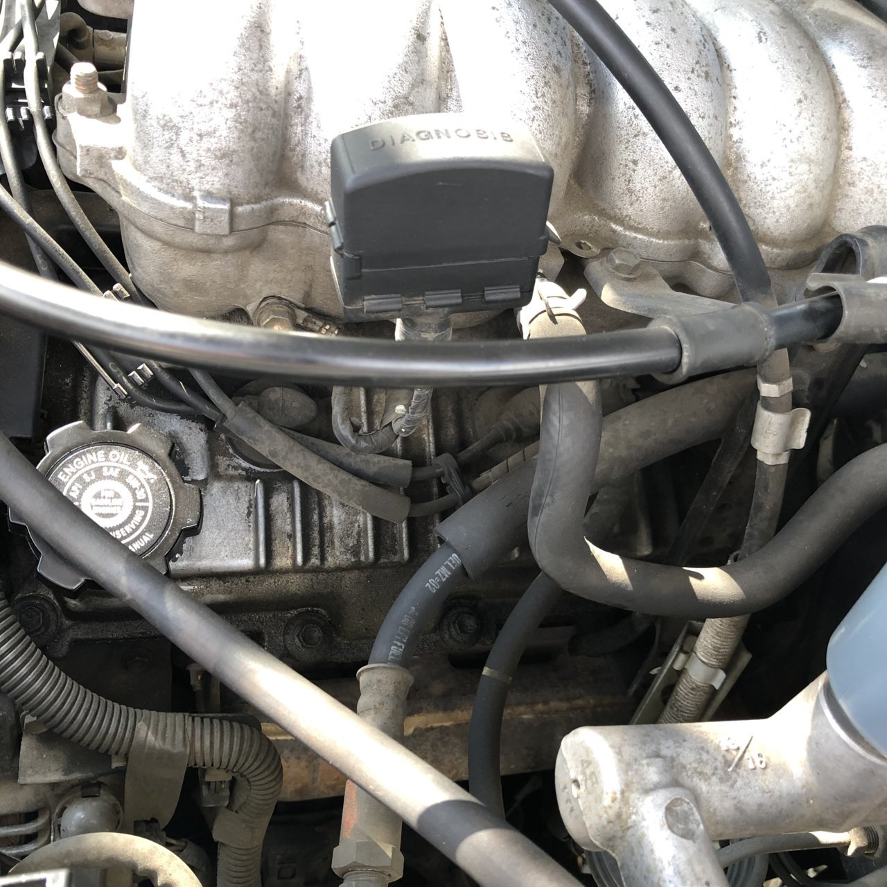

    I noticed that the passenger side of the engine has a lot of caked up oil residue while the driver side looks relatively dry. Idk much on motors so is this normal? My guess was maybe head gasket? But like I said I’m not very well educated on motors. This one has 267k miles and I oil change every 5k. Other than this I haven’t noticed anything else that could relate. Or am I worrying over nothing?

    Valve cover gasket is leaking it looks like, common issue with these 3.4l motors when they age.

    Classic Valve cover leak. Not a major issue but would be a good idea to replace the valve cover gaskets.
