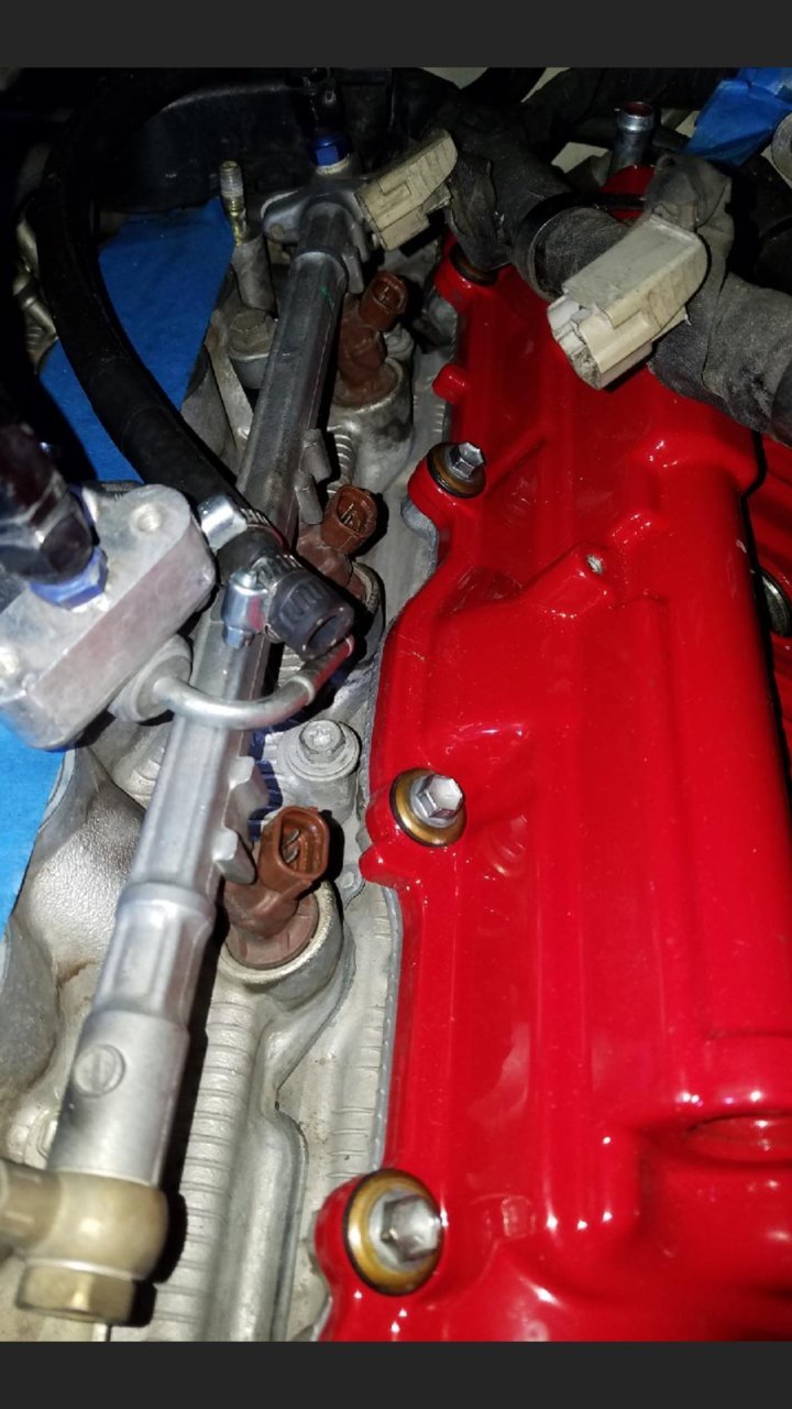

    Here are the numbers for Tacoma valve cover parts plus one half moon as they can break when removing

    No, these are the parts for the valve covers,
    2 Valve covers gaskets
    2 Cam seal plugs
    6 Spark plug gaskets
    16 Valve cover washers
    1 Fipg gasket maker
    1 Intake body gasket because I have a supercharger, 2 if you don't
    1 Half moon plug,, because one broke when removing, you can replace all 4 or clean them instead

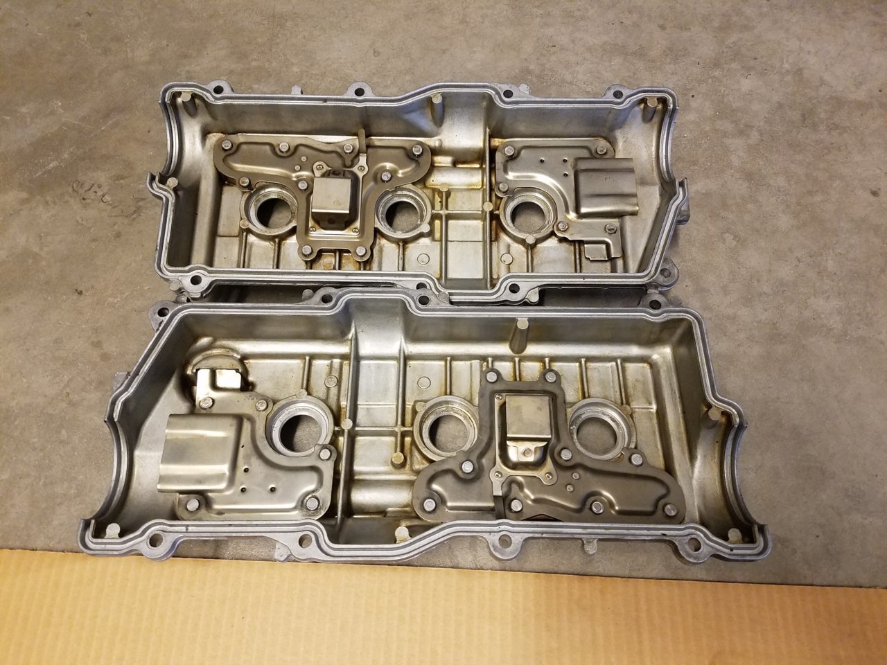

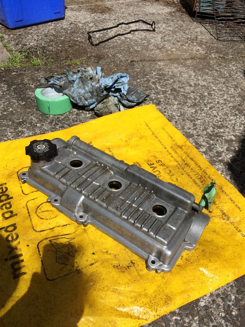

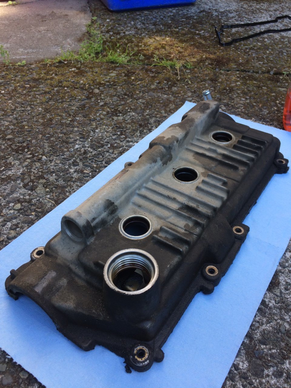

    I had very similar looking valve covers before i replaced the gaskets last summer.
    Decided to clean them up a little while I had them out.
    Still look good to this day 1 year later.
    Kevins60, Currygoat and 1997tacomav6 like this.

    What did you use to clean them? I’m planning on getting the whole engine bay steam cleaned before the job but incase I don’t I’ll be doing them myself.
  7. Jun 10, 2020 at 11:21 PM
    #67
    Vaushaus
    Vaushaus トヨタのトラックはすごい
    Oct 20, 2018
    #270075
    141
    Vancouver, British Columbia
    1998 3.4L 4x4 Auto
    Bilstein + Eibach Coilovers, OME Dakars w/ AAL, 33" Wranglers on American Racing AR23 wheels
    I think I used Zep Citrus Degreaser (smells good and pretty easy on your skin) and a brass wire brush? Maybe steel wire brush. Can't remember. It was the little handheld versions. Basically heavy duty toothbrushes.
    Was quite the workout, mind you. I'm sure there's a cleaning chemical out there more effective.
    If I were to do it again, I'd look into the brass wire attachments for power drills. You'll find that the 5VZ's valve covers have a lot of nooks and crannies.
    I think I also tried using a fine grade emory cloth to smooth it out.
    Didn't come out spotless, but a hell of a lot better than when I first pulled it out!

    X2, a drill wire brush makes quick work and a dremel with a flexible cable with wire head
    attachment.
    The small toothbrush type bass brush with the 45 degrees angle.
    Last, a can or two of Carburetor cleaner to get all the debris out and you’re good to go

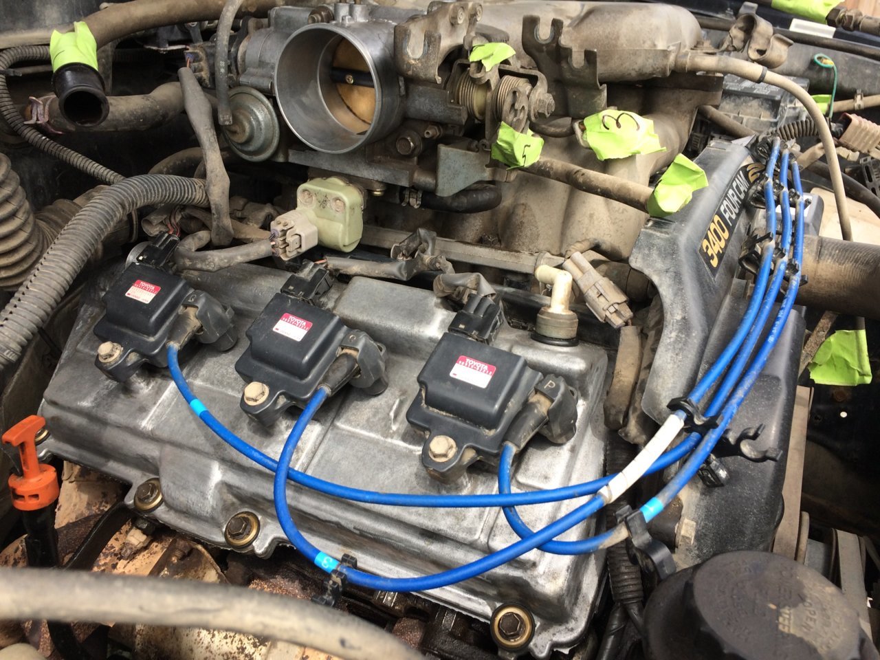

    You may already be on top of this, but invest in some painter's tape and a sharpie. And some zip-loc bags to hold all the bolts and nuts!
    I taped off and numbered all my connections as I was pulling everything apart. Gave me amazing peace of mind knowing that everything would be going back together properly.
    Logans2001[OP] and cruiserguy like this.

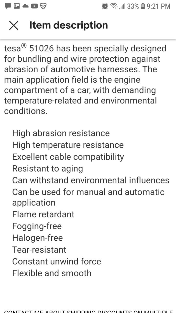

    And Tesa tape for the wiring harness.
    Its rated at 300 degrees and how’s your opportunity to paint those covers if you want

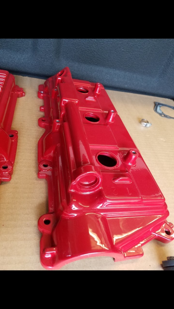

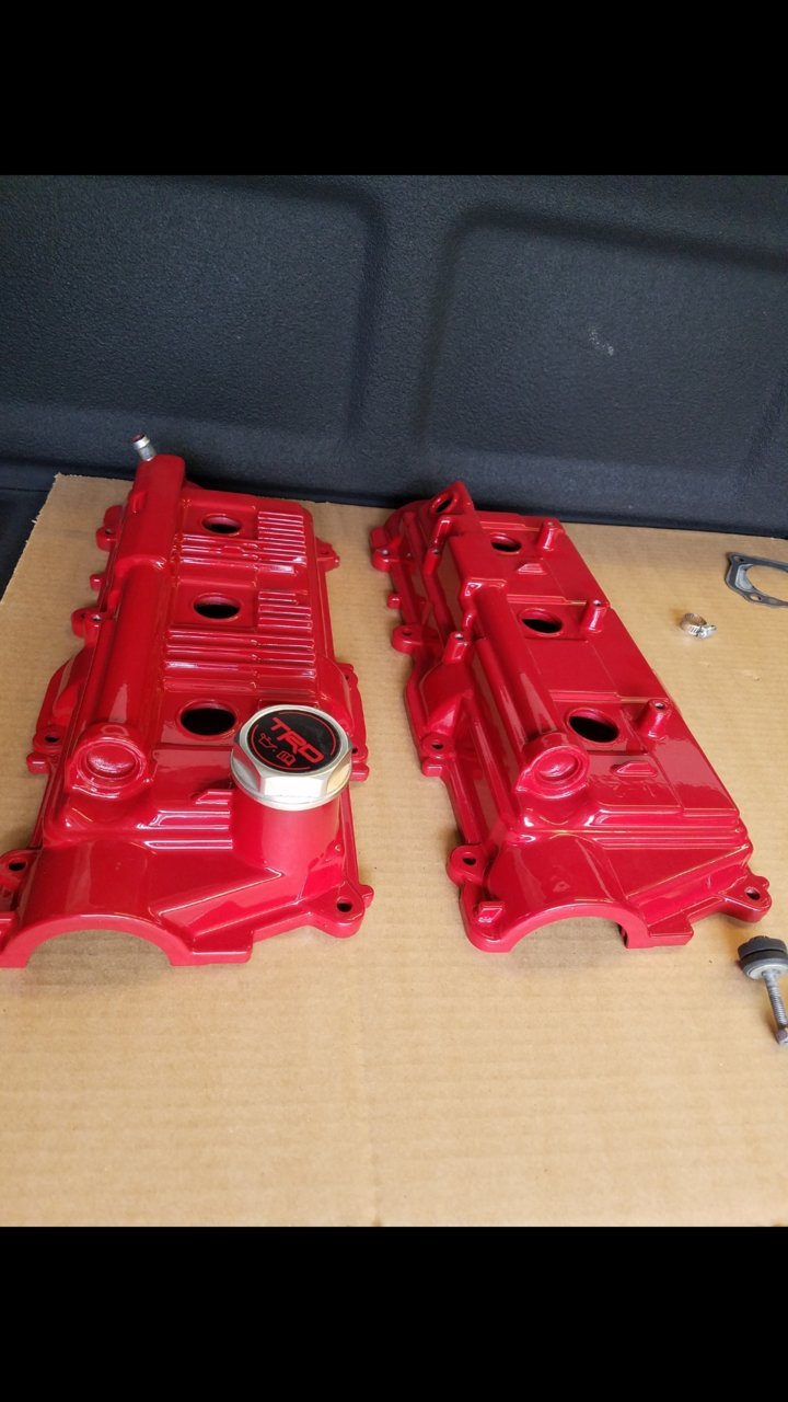

    Wish I had the funds to powdercoat my valve covers when I had them out last summer. Sadly not! Maybe next time though! :D
    1997tacomav6[QUOTED] likes this.
  17. Jun 11, 2020 at 9:59 PM
    #77
    1997tacomav6
    1997tacomav6 V6 5sp,RegCab,TVS1320 Supercharger,Haltech, 800k
    Oct 5, 2013
    #113940
    10,391
    John
    Denver
    97 reg cab, v6 5sp 300hp supercharged, Methonal Injection, 800,001 plus miles, Original Owner
    V6 5sp,RegCab,TVS1320 Supercharger, 56mm pulley, methanol injected Haltech ECU, AC Tvs1320 supercharger,(MUST DO) every 125,000- 150,000 needs rebuild Projector headlights HID 5 speed manual Amsoil for all drive train Smaller 56mm custom pulley, (MUST DO) 2004 DESNO fuel injectors, zero ping ping, 2004 side door mirrors Dick Cepek Rims, Michelin tires LTX, ATM Pathfinders Dynopro ATM ( that last 100,000 miles) Now running Dynopro ATM mud and snow tires KN cold air intake Cat back dual exhaust with ss exhaust tip, Raised exhaust tail pipe to 2" below body line Optima*dry cell battery,red top Alpine sirius radio, 200 watt amp, focal is165 split door pod speakers Focal door speakers Subwoffer behind seat Viper alarm, Electric Locks Dark tinted windows, bucket seats corbeau lg1 Tacoma Rubber floor mats TRD fender extenders, Bilstien shocks, King shocks JBA UCA trailer iv hitch, electric brake control, Drilled slotted brakes, High carbon steel (MUST DO) EBS green stuff 7000 series pads(MUST DO) TRD engine oil cap TRD stick shift, Marlin crawl shift kit. Rear sliding window 2002 4Runner functional hood scoop cut into Tacoma hood, 4Runner dual overhead map light Gentex Auto dim + Compass + Temp, garage,rearview mirror Snow Methonal kit stage 2 Custom 3 core aluminum radiator Linex bed liner Haltech stand alone ECU, Intake supercharger gauge. Stainless steel brake lines, Custom leather wrapped steering wheel, Haltech stand-alone ECU,
    It was 100.00 for both powder coated, not a spray can.
    Vaushaus[QUOTED] likes this.
